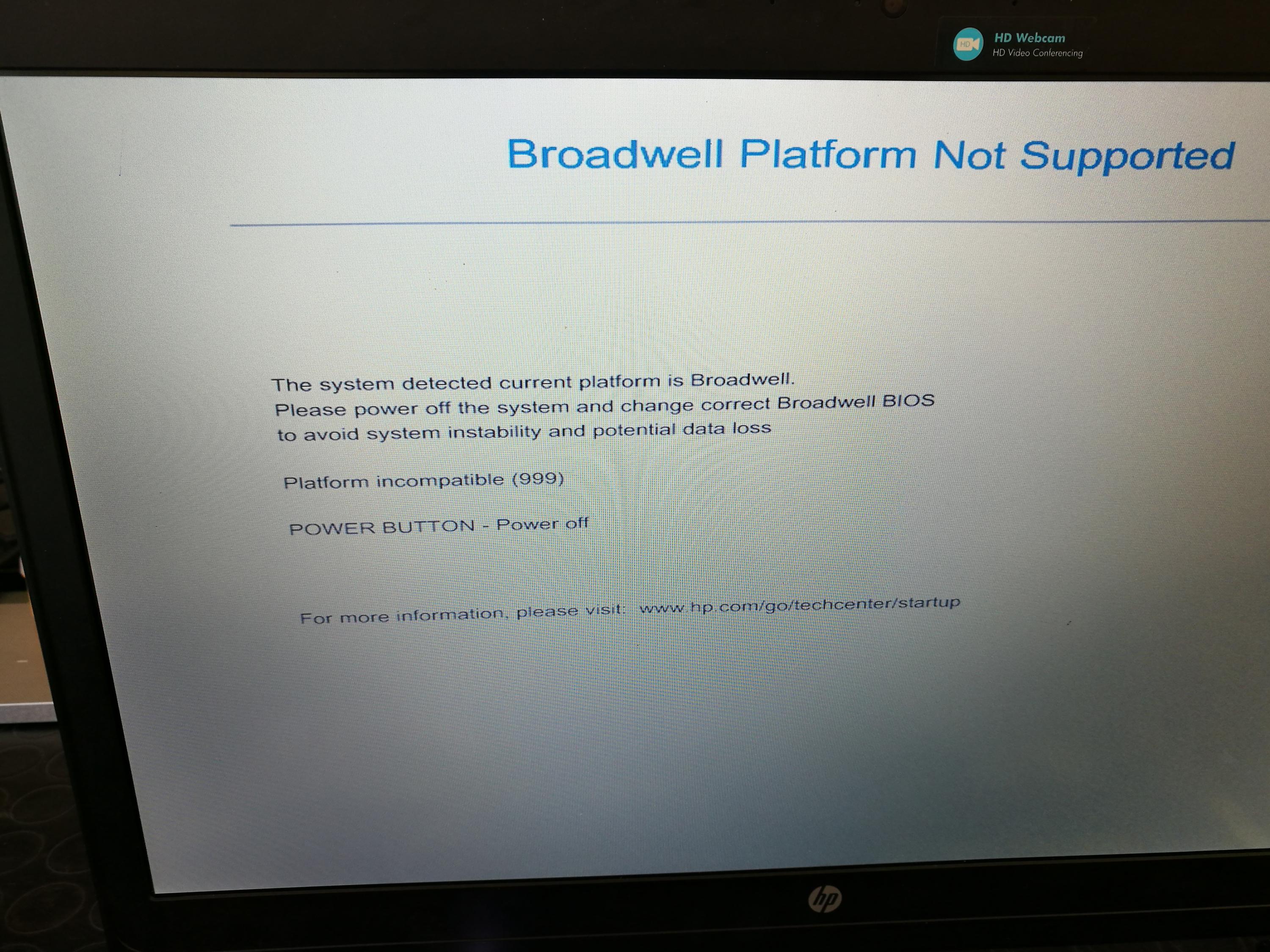

                                      I have same problem with hp 470 g2 with bios.zip error Brodshell notsupport, attach backup my bios and screenshot, with original bios bricked attach original bios
                                        • 21517
                                        Re: HP Probook 450 G2 440 G2 LA-B181P BIOS
                                        Originally posted by alsad
                                        hi friends,
                                        Try this bios .
