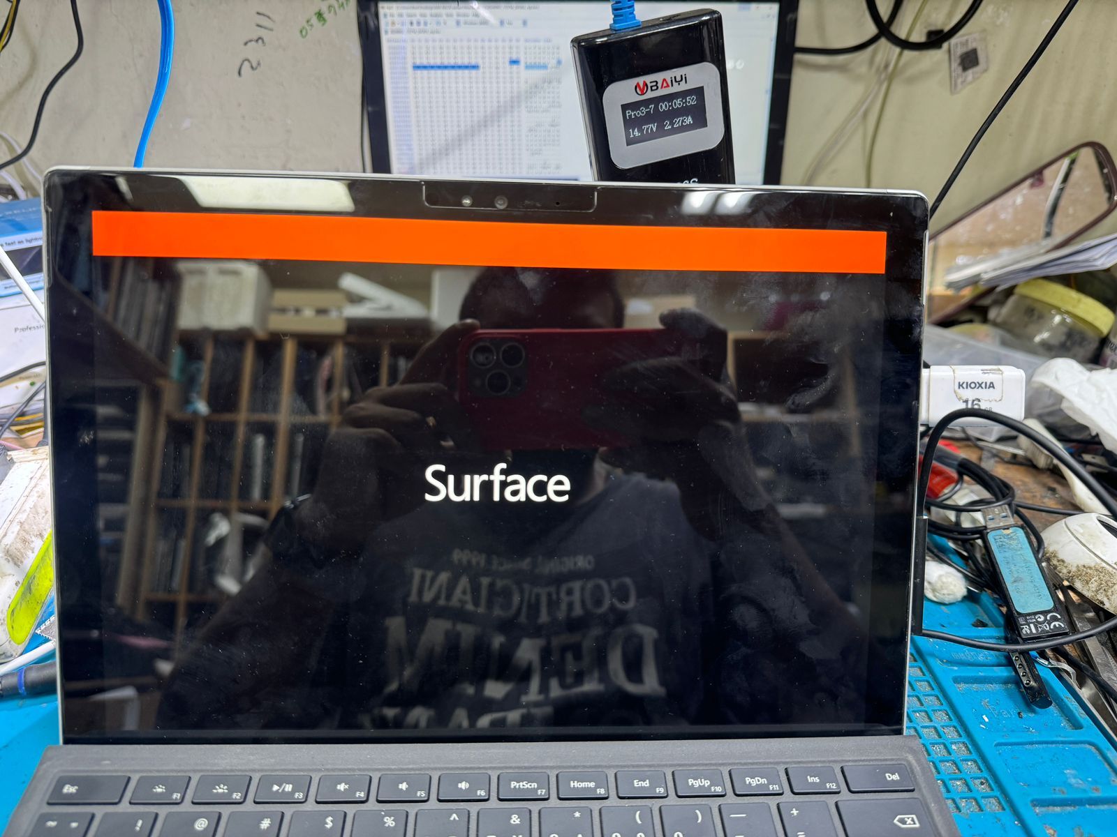

hello dear experts
i have a surface pro 4 with hang on logo problem
i found a bios on the internet that passes the logo and enters the bios but unfortunately the touch screen not working
touch screen is tested on another machine and its ok
i tried to clear me my original bios with the method that dear peste provided with no success
would you please help me with this situation
thank you so much
surface pro 4 1724 256GB
sn: 071913754953Comment

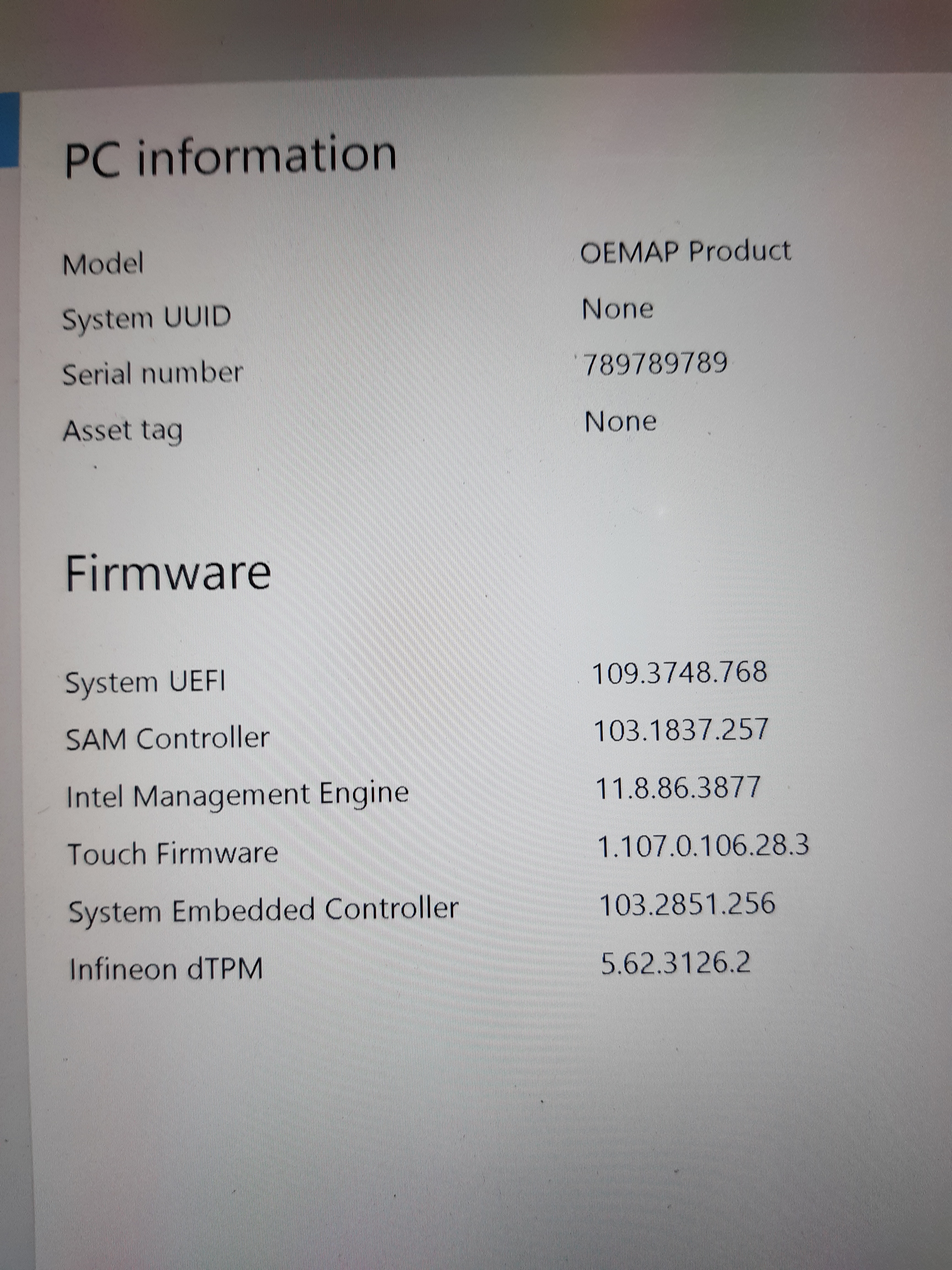

update!!
i decided to ignore the me part and only extracted bios region from the rom i found on the internet and replaced in my original dump with hex editor
only bios region and nothing else
the machine is working and in bios menu touch is working also
the problem is bitlocker is activated and i cant boot to windows
the owner doesnt have any important data so now im installing windows
lets see what will happen next
i hope no more troubles
i dont know why but it seems if you touch me section in any way the touch will stop workingComment
finally solved !!!
i found a bios in forum that peste was modded to clear password and it was a fully working bios
downloaded that file and extracted bios region by uefi tool (extract as is) and replaced in my original bios with hex edditor
pc information in uefi menu is ok now (of course serial number is for that machine not mine but apparently its not important
all the drivers installed and device is fully functional
in my case changing me in any way didnt work
hope this could help someone
again thank you peste for your time and effort
i really appreciateComment
