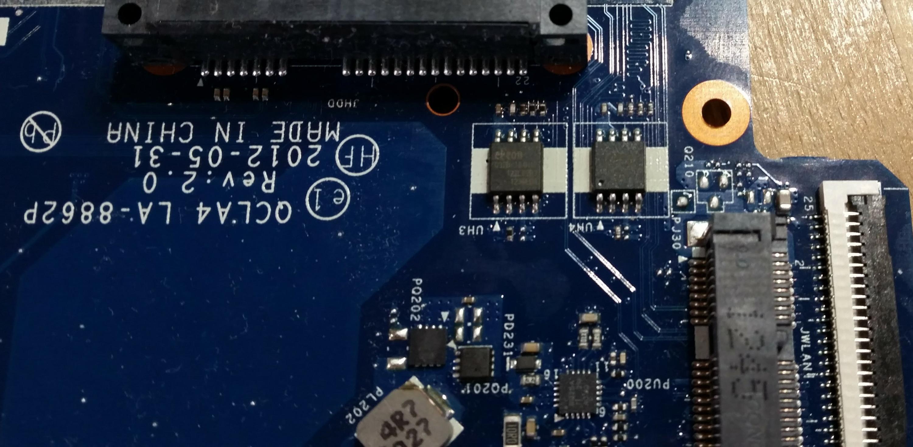

    Hi i would like some help in locating the bios chip on the above motherboard.
    I was adjusting the BIOS on the laptop to boot from external device during a boot failure troubleshooting session when after shutting down the laptop the screen no longer lights up. From what i have learned this could be that the BIOS corrupted during this process. For a belt and braces job i bought a programmed BIOS chip off eBay. What i received was two bios chips one 16bit and one 32bit, i have contacted the seller but as of today i have not received any help this i believe will only be temporary, in the mean time i am searching for information partly to further my knowledge. Question: why would i receive two chips and how can i tell which to use if its a case of swapping one, and question two: are these the chips to change or which one of these is the bios chip in the attached photo

    Re: Samsung NP350V5C BIOS Chip
    Check schematic
      No need to buy chips. Reflash both Main and EC OM chips with this BIOS file.
      25x16 marked chip is EC
      25x32 marked chip is Main BIOS.
        For your case UH3 is Main and UH3 is EC
          Thank you so much. Could i ask how do i do this as i have no visuals due to BIOS corruption.
            You need an external programmer to do this and hot air gun to desolder and solder both chips.
              Thank you, could you recommend a programmer for jobs like this?
                Try EZP2010 which I am satisfied with, but there are many of them, just check ebay
                  Thank you for all the advice, i now have a working laptop.
