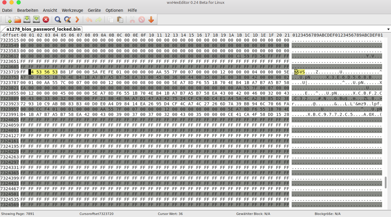

                Hi there can someone help remove the password from this BIOS?
                board is 820-2936-B
                  #68
                  Re: Apple Macbook Pro A1278 BIOS Dump
                  board is 820-2936-B

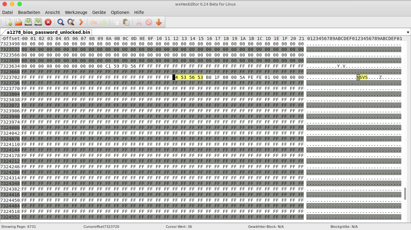

                  try..
                    #69
                    board is 820-2936-B
                    Try this file ....

                      Thank you so much. Out of curiosity how did remove the password?

                          Thanks. This is what I had tried myself at first and my edit matched yours but the macbook wouldn't show a display. Had fan spin but nothing happened. Peste left the "SVS" with a small bit after in which worked. Just wondering what that part is.
                            #73
                            Soory yes you are right Peste left some more in his unlock bios.
                            Only he can explain why that to you himself, he is a far more experienced user than I am.
                            I myself only know it from Youtube videos that from $SVS everything is filled with FF.
                            Maybe he'll tell.
