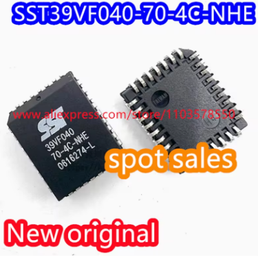

                    hi after some researches i fond that the bios is u34 is a 4 mb 512kb * 8 and its a 32 pin i will drop the schematic of the board and a photo of the bios chip if u have any idea how i can flash it pleas inform me
                    thanks
                    link to schematic -> https://www.badcaps.net/forum/troubl...v5000-la-3181p
                    • Developer AKRAM
                      • Feb 2025
                      • 12
                      • Algeria
                      thanks
                      i found that i need a new programmer called Rt809h i found a good one in aliexpress cost me with shipping about 170$ it comes with 58 different adaptor here the photo and the link :
                      the link : https://fr.aliexpress.com/item/10050...Cquery_from%3A
                      i have to wait a month to test it and flash the bios with it I'll inform you with the result then
                      thanks for the help
