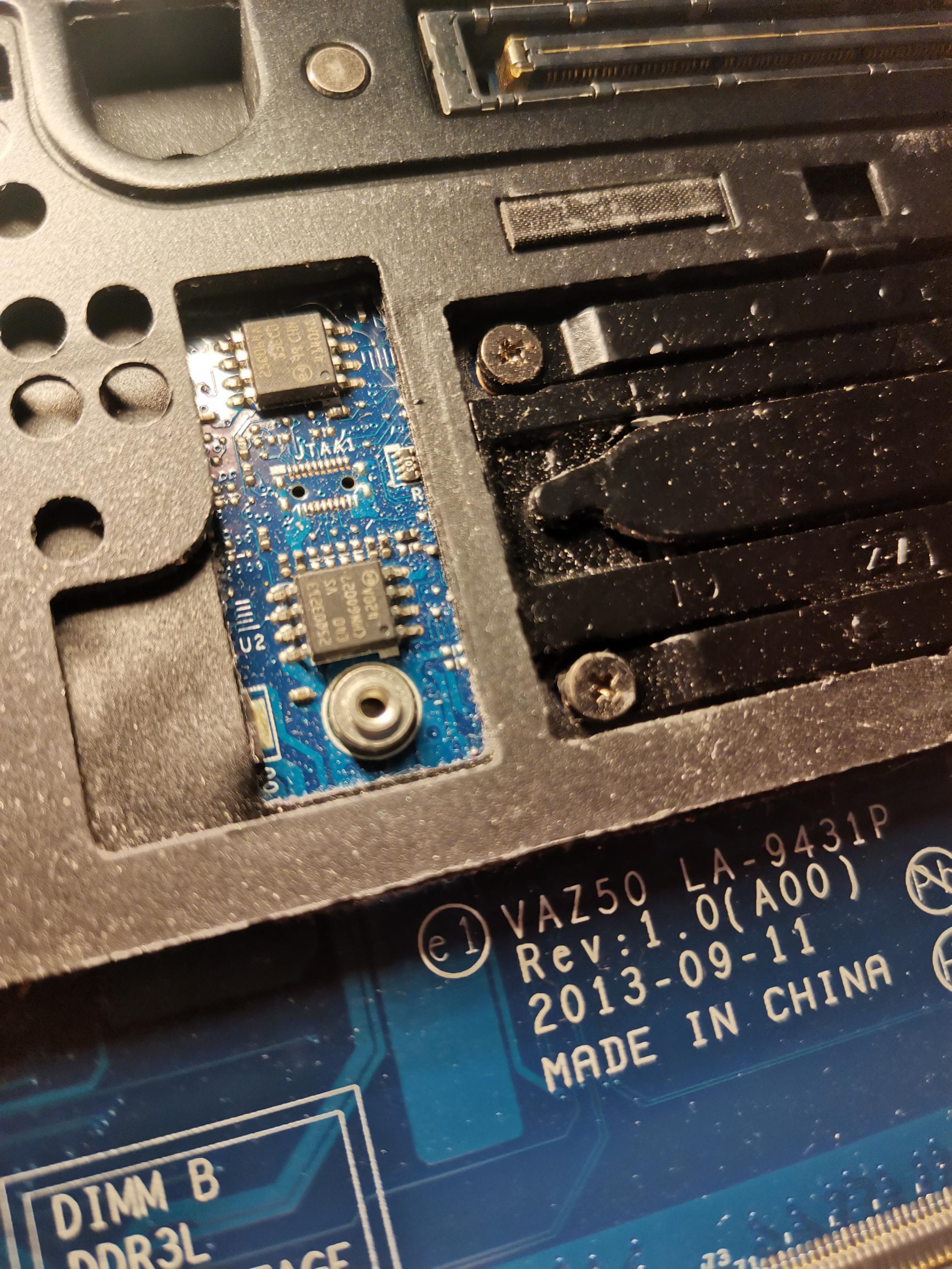

                I have a Dell e7240 with a motherboard from ebay. When is booting I am getting "FW status recovery Error" but that's not an issue.
                From time to time, Laptop is freezing while booting and that's annoying .
                I've tried to downgrade/upgrading the Bios, but still same symptoms. While upgrading/downgrading Bios version, I could see some messages, which indicates laptop would not being able to properly upgrade "ME firmware end-up ..."
                I've tried to read the Bios from the two chips but not sure what to select from the manufacture list for 25q064A 25q03513 . I am using T48 Programmer and doesn't have the auto-detect option, and with CH341 with auto-detect option was showing XMC as a manufacture.
                MB version LA-9431P
                Service tag 7396M12
                Please advise what is the manufacture options for 25q064A 25q03513 IC, and a piece of advice if writing a new BIOS on those will fix the issues ( "FW status recovery Error"​ and freezing screen )
                Thanks in advance
                  MB version LA-9431P
                  Service tag 7396M12
                  Please advise what is the manufacture options for 25q064A 25q03513 IC, and a piece of advice if writing a new BIOS on those will fix the issues ( "FW status recovery Error" and freezing screen )
                  Thanks in advance
                  Click image for larger version  Name:	IMG_20221117_100612.jpg Views:	0 Size:	806.9 KB ID:	3524191
                  This's bios chips.
                    This's bios chips.
                    Thanks hoaca388,
                    I was able to identify the chips on the motherboard but my question was what to choose when I am selecting the IC inside the programmer (TL48 ) for 25q064A and 25q03213.
                    CH341 with auto-detect option was showing XMC as a manufacture for 25q03213.

                      Eventual I've read the 25q064A and 25q03213 ICs using CH341 where identify the chips as being XMC (XM25QH16B and XM25QH80B)
                      TL48programmer is not able to recognize the chips and not able to read those either I am choosing Micron or XMC from list.
                      Attached the bin files below. Please remove the FW status recovery Error
                      DELL e 7240
                      MB version LA-9431P
                      Service tag 7396M12​

                          #53
                          Latitude E7240 Ultrabook
                          Service Tag: 7396M12​
                          Thanks Hoaca388, did worked
                          Dont have the Error while booting.
                          Hope will fix the freezing image issues which were there from time to time
