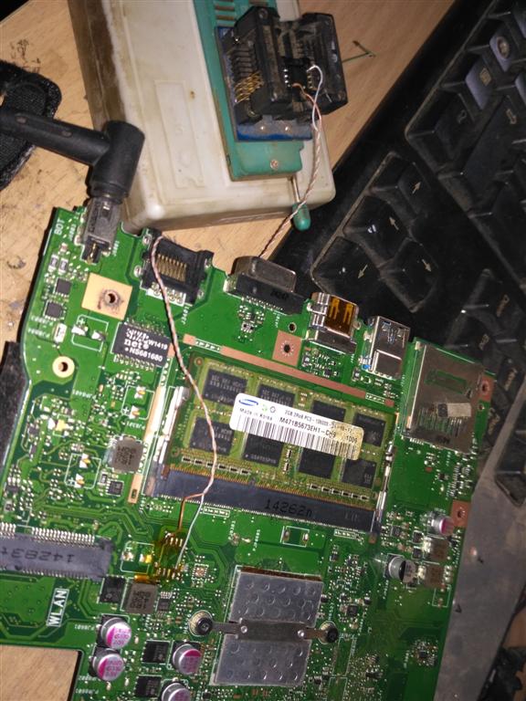

        Re: acer aspire E1-410 BIOS dump needed
        The bios chip is not supported by my SP8-A programmer. It's winbond 25Q64FWSIG, it only support FV model... i tried to select FV then make backup but i'm not sure if it's a good backup. I haven't yet tried to reflash the bios chip. My backup is 8mb. And i only found 1 bios chip on this board.
                                    its 1.8v chip. u need 1.8v adapter to program this chip else you will end up with no display only. If you dont have a 1.8v adapter then there is a way out to program this type of chip. See attached photo-it will be clear to you.
