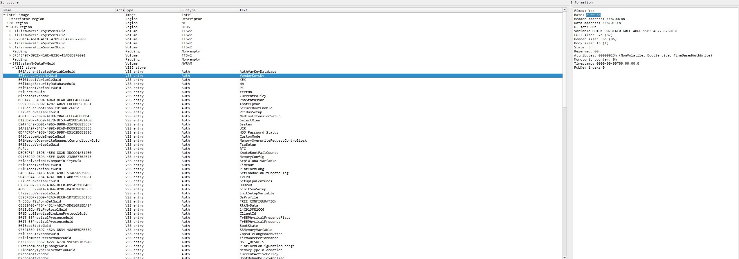

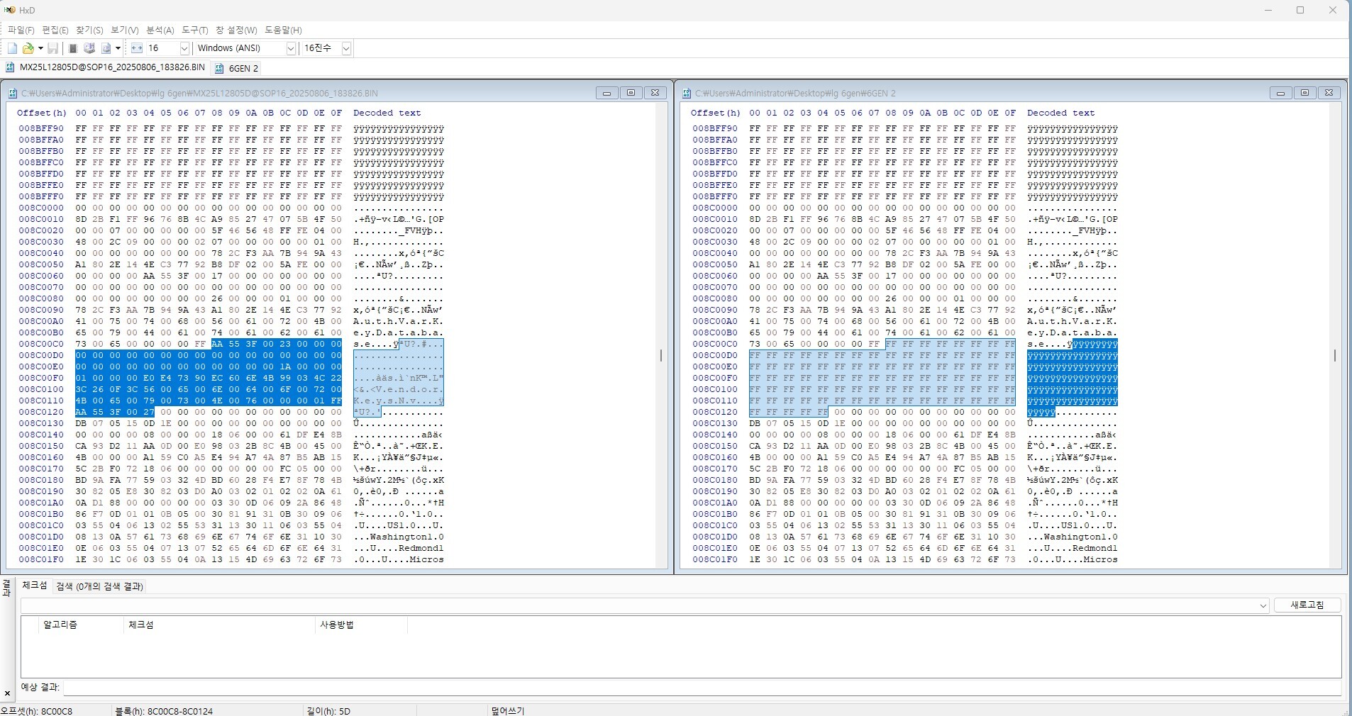

          • painhope
            • Nov 2023
            • 14
            • KOREA
            I'm uploading the solution I found.
            I used UEFI Tools to find vendorkeysNv.
            I then navigated to that location using a hex editor and filled in the contents with FF
            I hope this helps other users.
