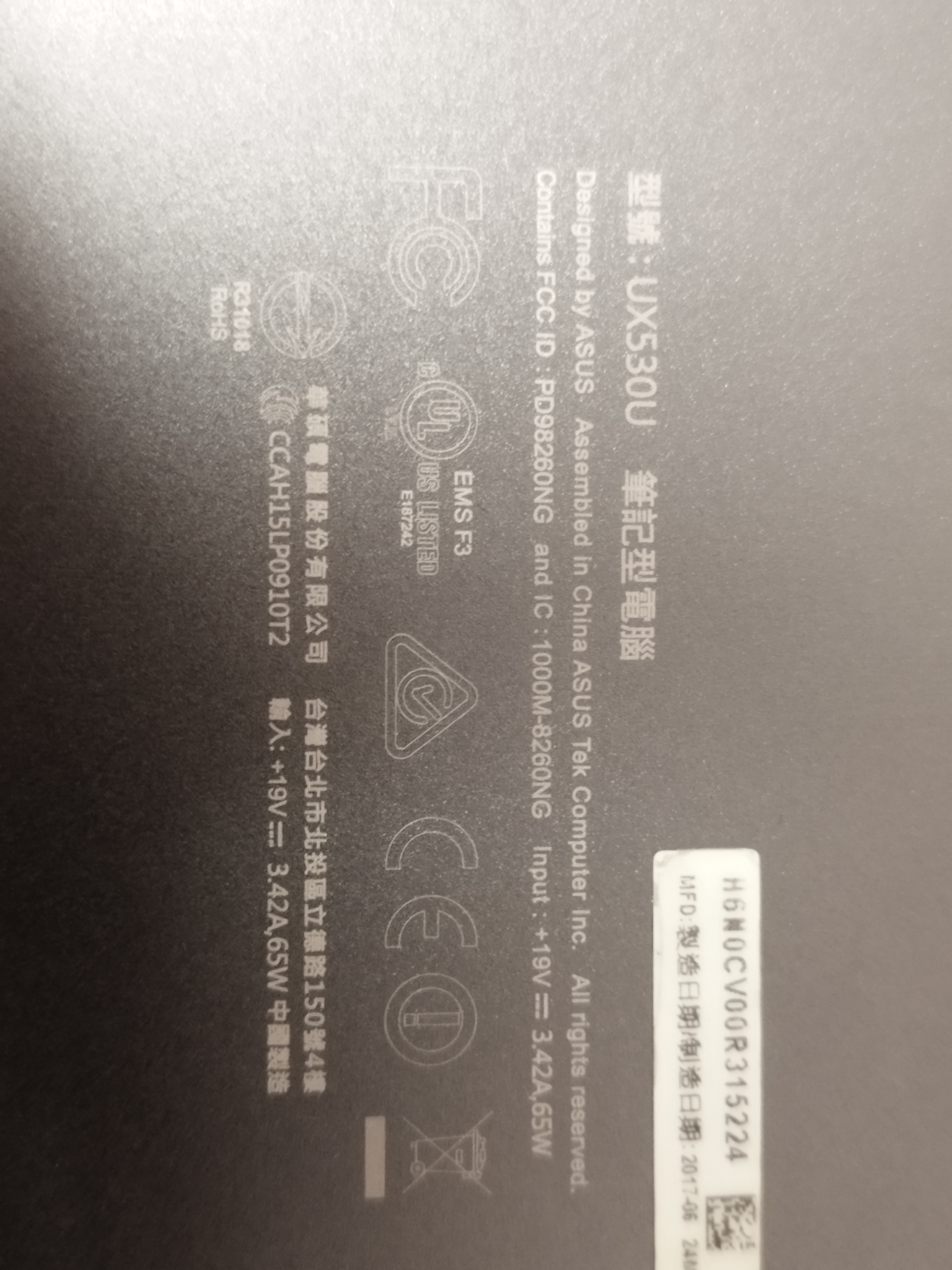

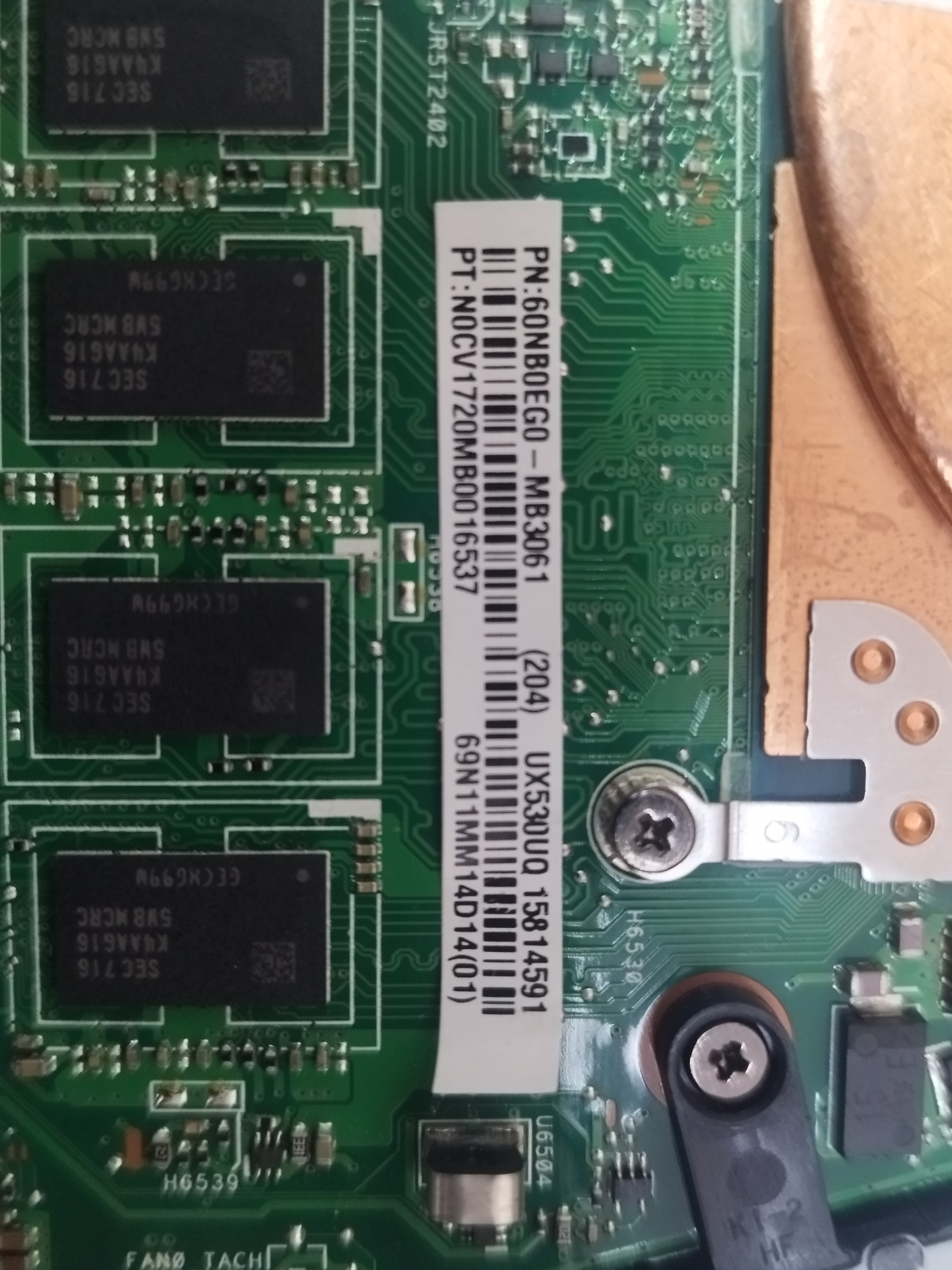

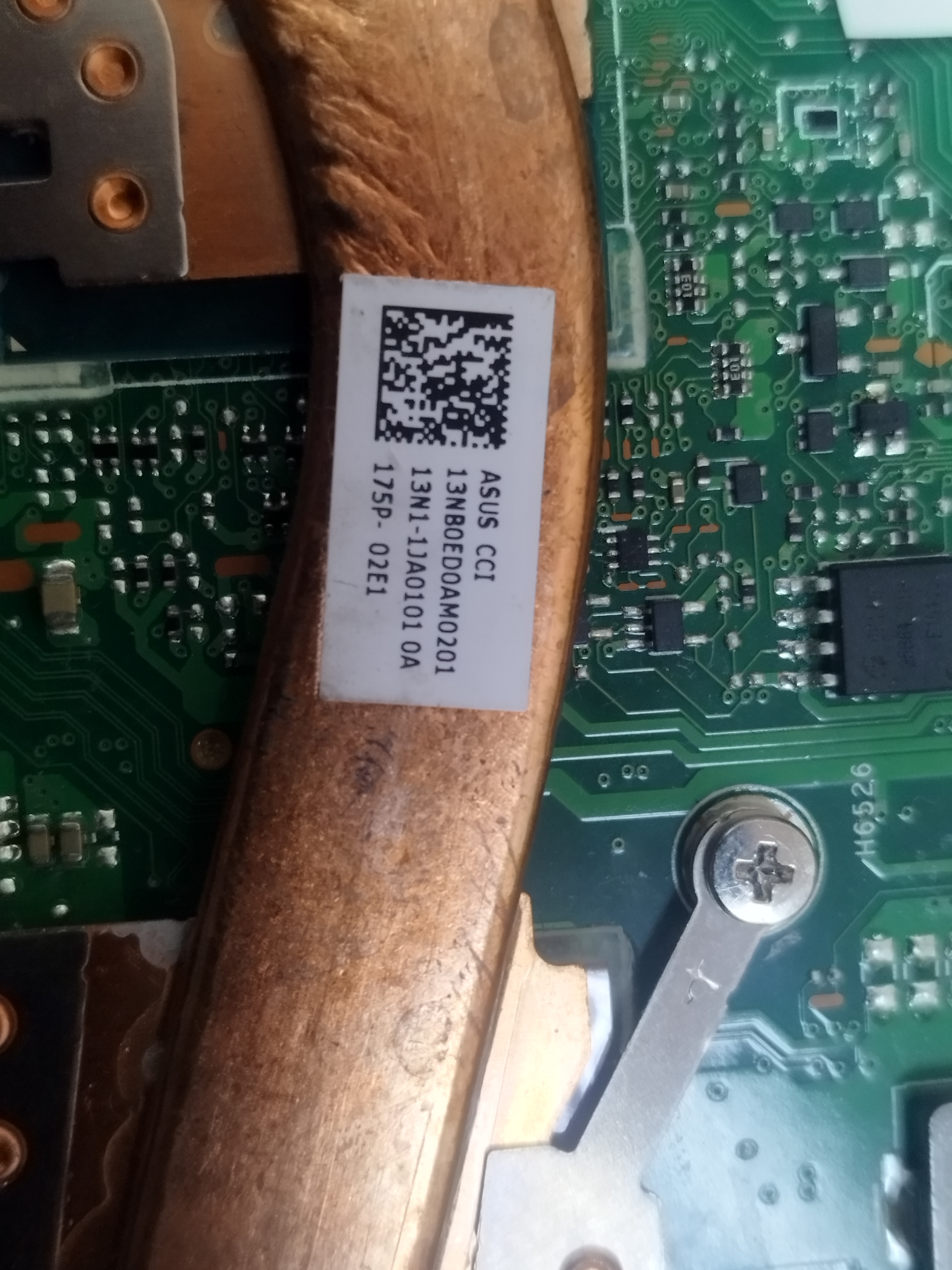

        Originally posted by peste
        post S/N, full name and model, motherboard model, etc.
        Here is what i found stickers attach to the laptop thank can you please help me
          • 21145
          Where is your original bios backup .
          Model: UX530UQ
          Serial Number: H6N0CV00R315224
