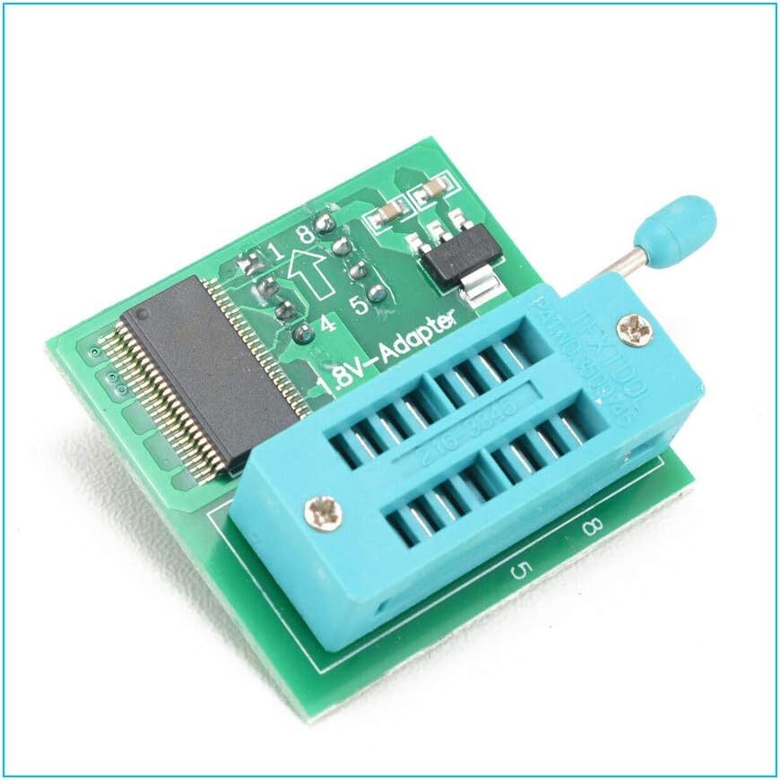

                      Warning: With the CH341A programmer you also need 1.8V adapter, like the one attached, the BIOS chip on AMD laptops is 1.8V, otherwise you risk frying the BIOS chip or the motherboard/CPU by supplying 3.3V to the 1.8v rail
                      If you're not confortable with soldering, electronics, or opening the laptop, it's best to bring the laptop to a repair shop, try to find a shop with good reputation, as you'll need the tools and skills to do it properly
                      If you want to learn, it's best to practice on broken electronics, otherwise you risk damaging a working laptop
                      Otherwise, since the laptop is still working, best to leave it as is
