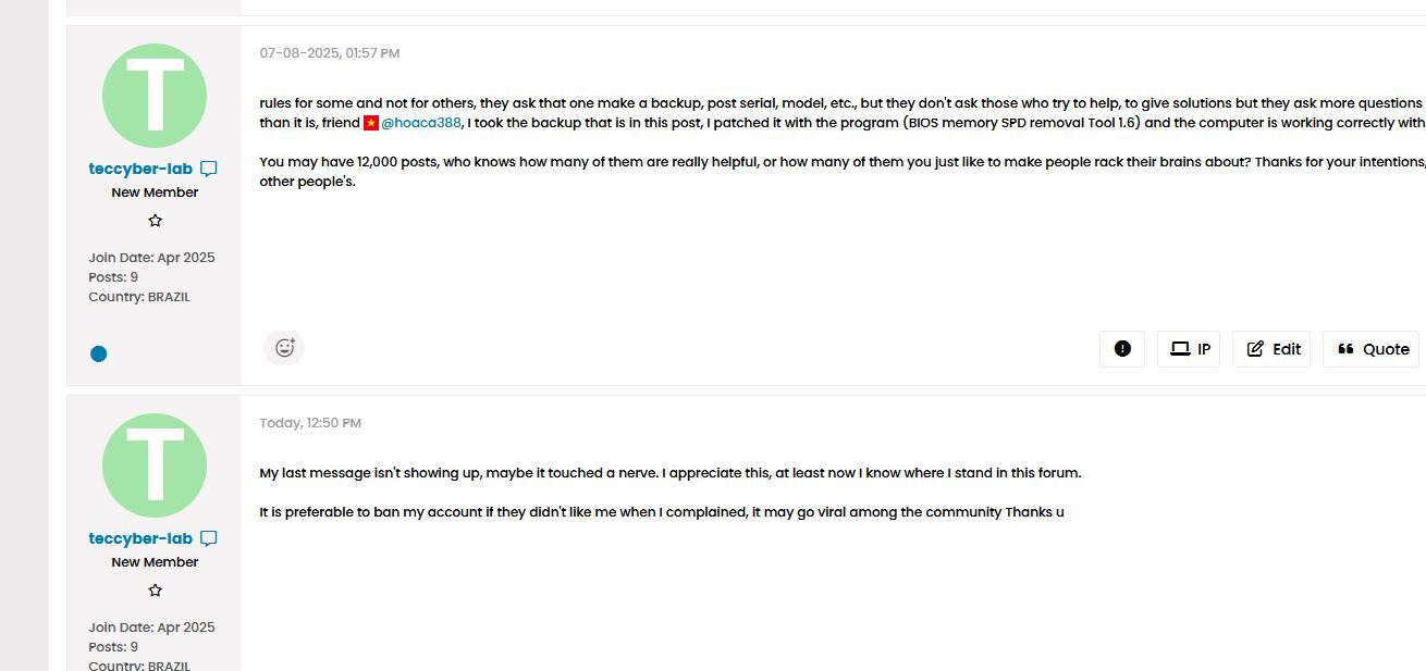

                rules for some and not for others, they ask that one make a backup, post serial, model, etc., but they don't ask those who try to help, to give solutions but they ask more questions than answers, they want to make the problem seem bigger than it is, friend hoaca388, I took the backup that is in this post, I patched it with the program (BIOS memory SPD removal Tool 1.6) and the computer is working correctly with only one 16gb memory of course.
                You may have 12,000 posts, who knows how many of them are really helpful, or how many of them you just like to make people rack their brains about? Thanks for your intentions, they motivate me more and more to trust my sense than other people's.

                  My last message isn't showing up, maybe it touched a nerve. I appreciate this, at least now I know where I stand in this forum.
                  It is preferable to ban my account if they didn't like me when I complained, it may go viral among the community Thanks u

                    What last message are you talking about ? .Man, you have a short fuse
                    It`s working, what`s the problem now.
