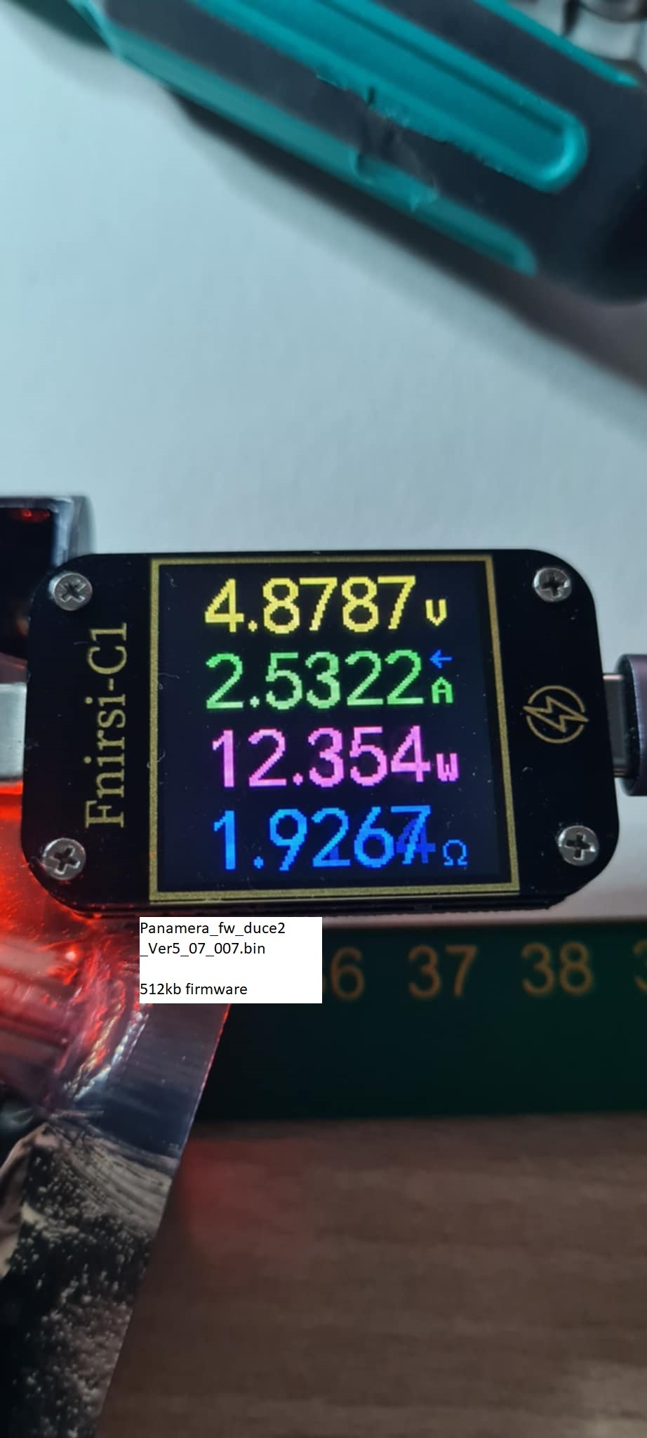

                          I tried the PD firmware you uplaoded on a new spi flash it flashed OK. soldered it back to the MOBO and soldered the BIOS flash.
                          When I press the power button it goes from 5.1V to 4.8V 3.0A 14.6W. Fluctuates at 2.7-3A.
                          when I hold the power button it goes again to 0.5A and 5.1V.
                          with battery (empty) the power charger flashes 3 times. no negotiation.
                          Measured voltages on the SPI FLASH ok.
                          Tried the factory bios it doesnt even respond to the power button.
                          I can try to replace the TPS65988D. could maybe the firmware be not configured? maybe a new firmware config tool needs to be create with the TPS65981_2_6_7_8 Application Customization 6.1.4 ? and config the I/O pins to match the schematics ?

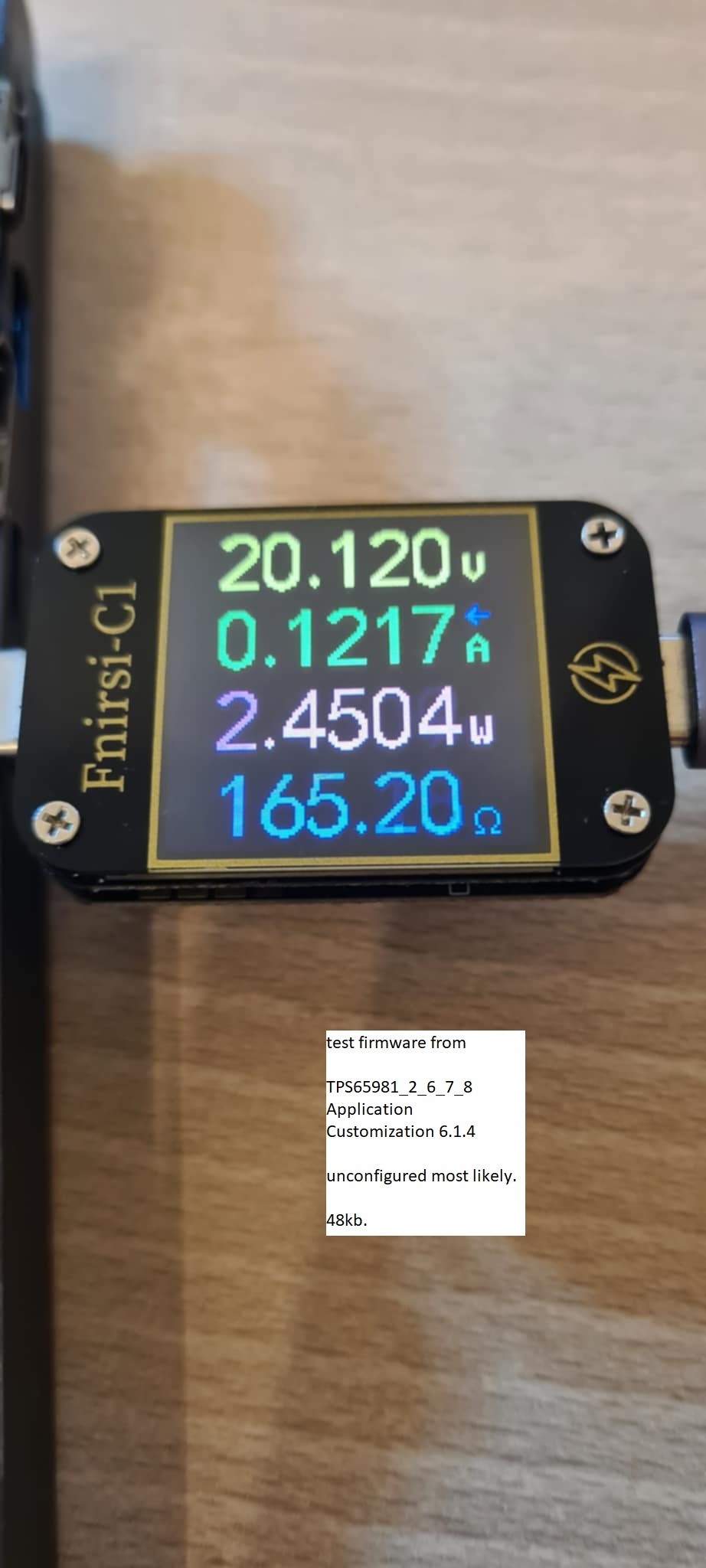

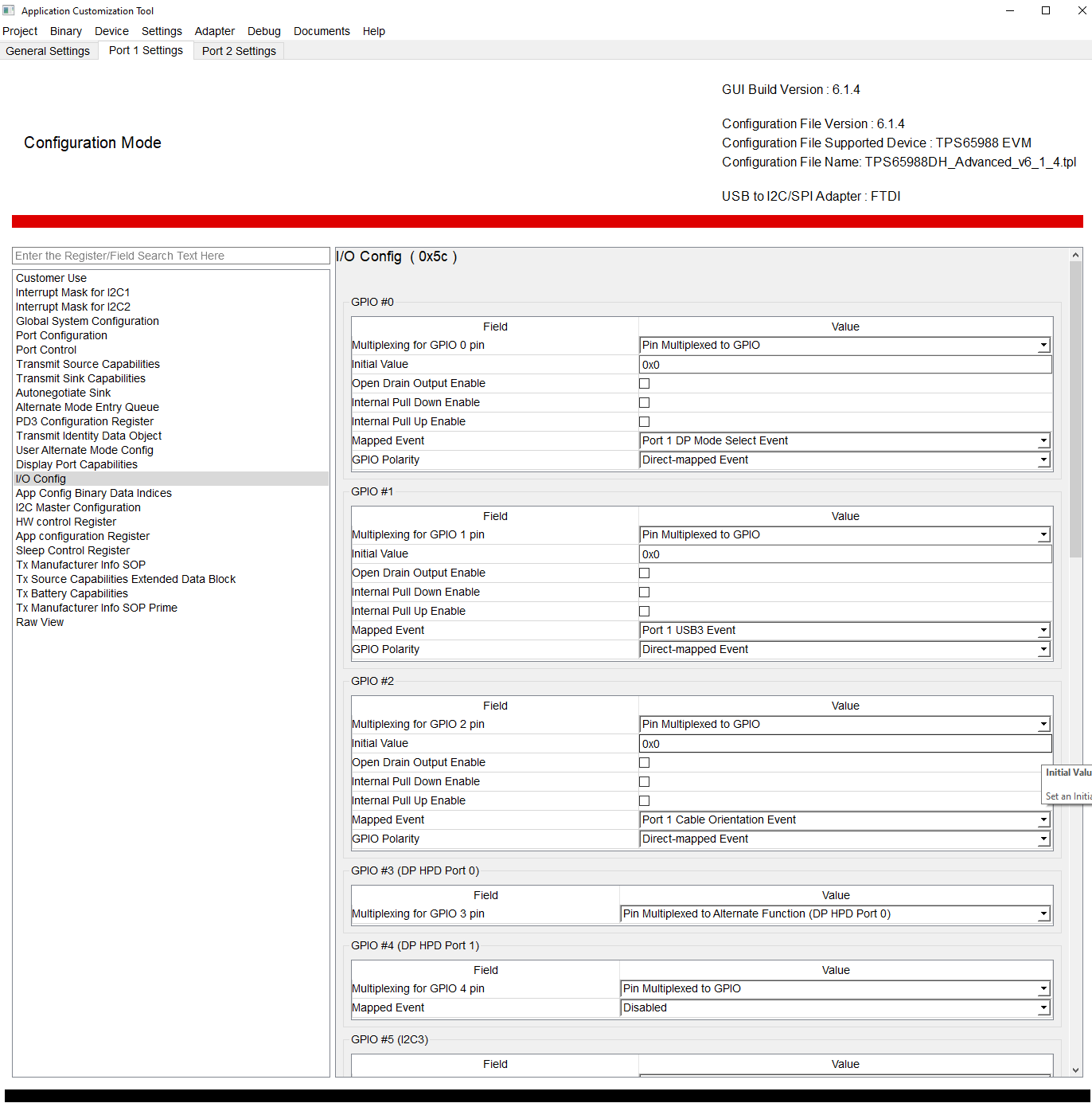

                            A little update.
                            I played a little with the tool. used the recommended config (didnt config it for my specific BOARD) I tried to see if anything changes and.. .I GOT 20V on plug in... but it is stuck in looping ( cutting the power completly off from the charger and in loop) config is most likely not OK.
                            From this I am confident the only problem I am facing right now is the FIRMWARE for the TPS!!

                                I Think I need a working firmware. there are no shorts anymore.
                                I will craft one today with the tool and looking at schematic closely the I2C talks at 0x23 address. 011b using a 0.9 divider.
                                hopefully this will work. will report back today !

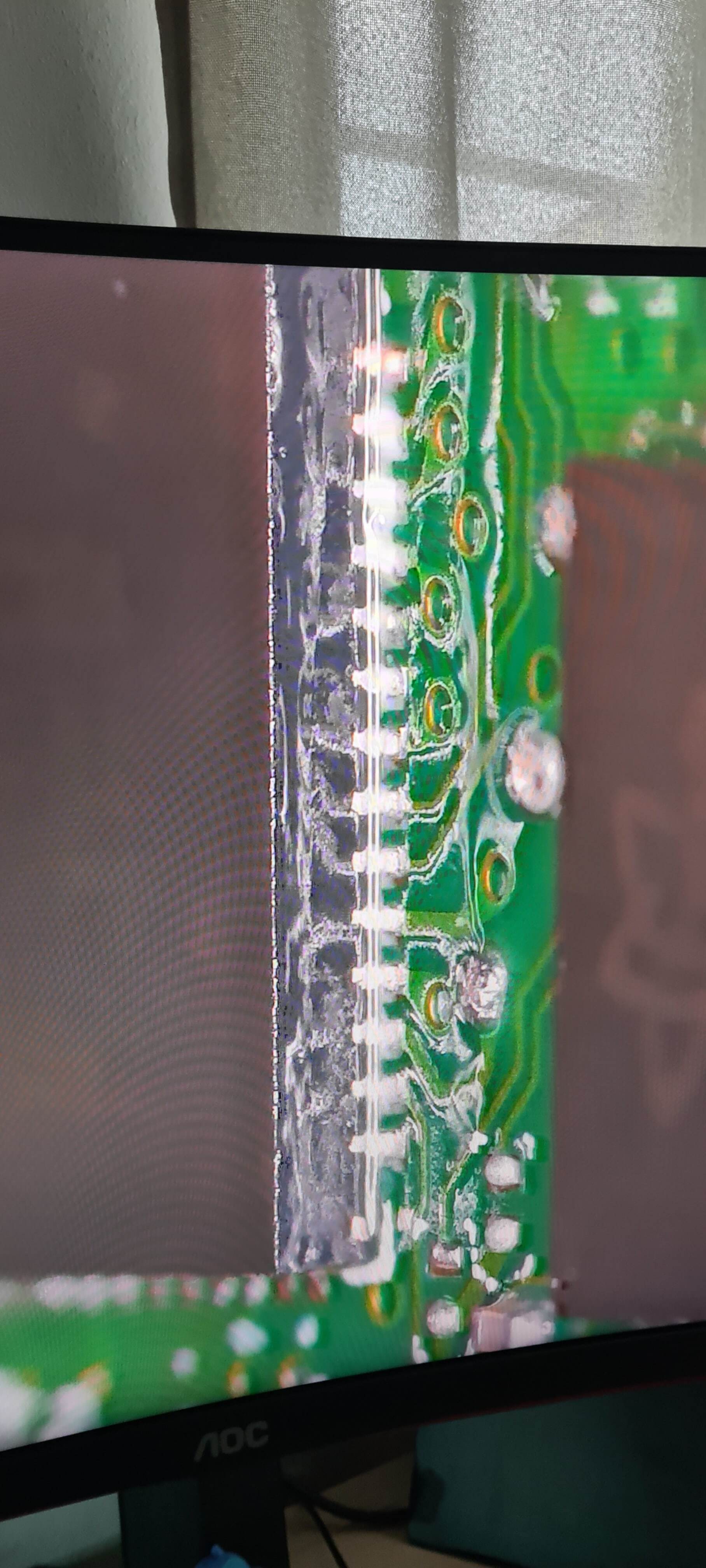

                                        • ekozeko333
                                          • Jun 2025
                                          • 19
                                          • Austria

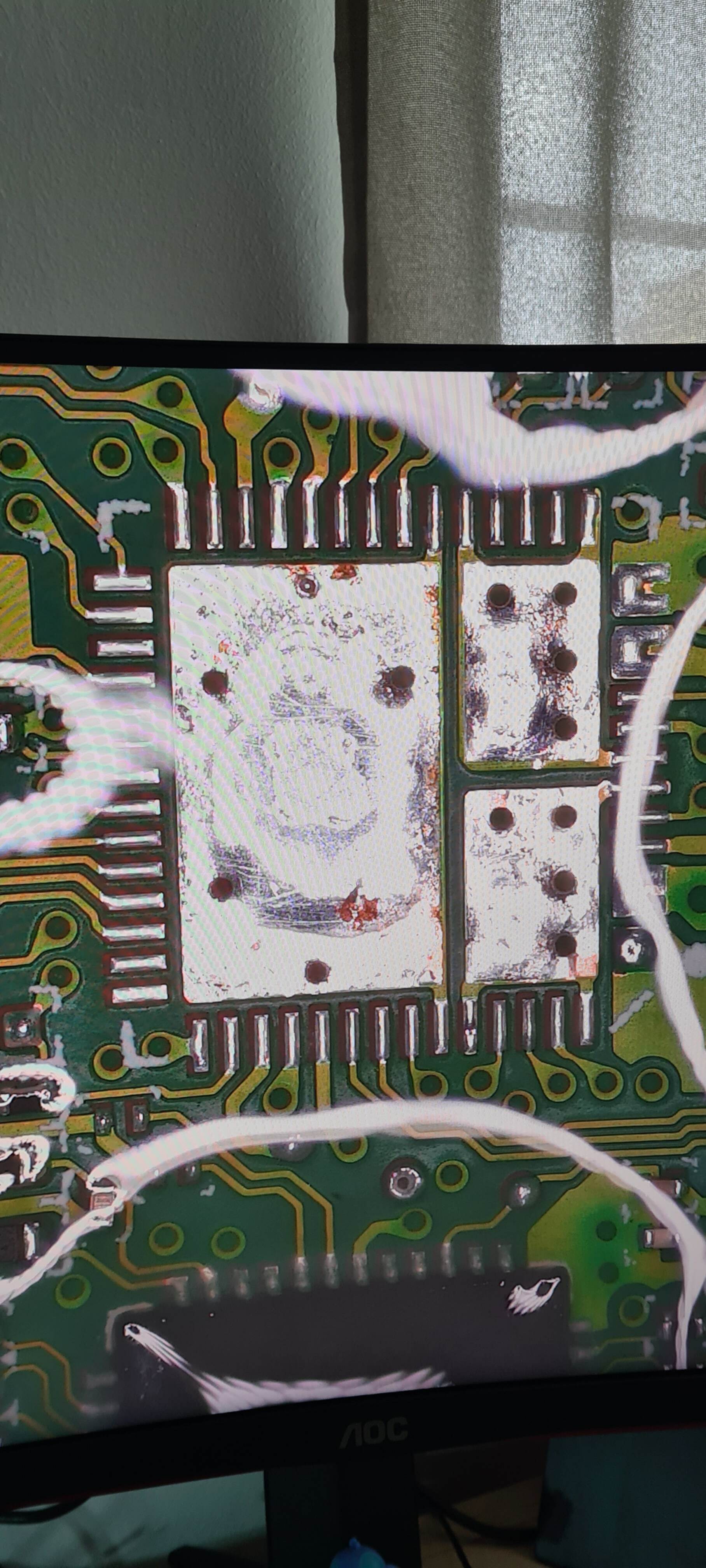

ID:	3679454 Bought a brand new original TPS65988DJ from Mouser.
                                          Replaced it.
                                          Still the same problem.
                                          I wish somebody would drop the firmware config from his TPS flash ... Idk what else could be the problem
                                          made sure the replace was successfull. cleaned pads. applied new solder. etc etc..
