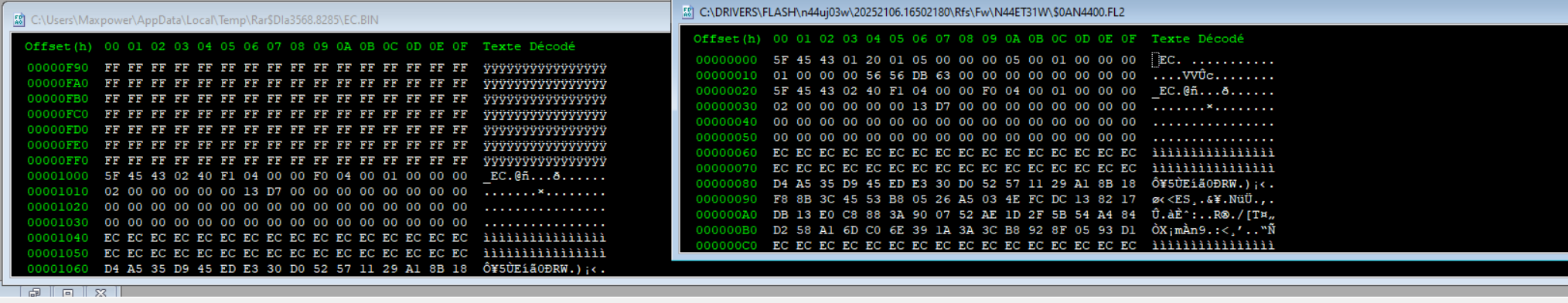

          Click image for larger version  Name:	image.png Views:	0 Size:	229.6 KB ID:	3664336
          there would be no offset in the file??
          1.13 or 1.14 same EC
          I would have seen it like that??
            Hello Max, i tried a few days ago with an official update and nothing. No power, no light. I tried with your ec... and nothing! No LIght
            Power is on only with another EC from secondary laptop. Today i received another identically laptop, Same probloem, after shutdown laptop not power on.

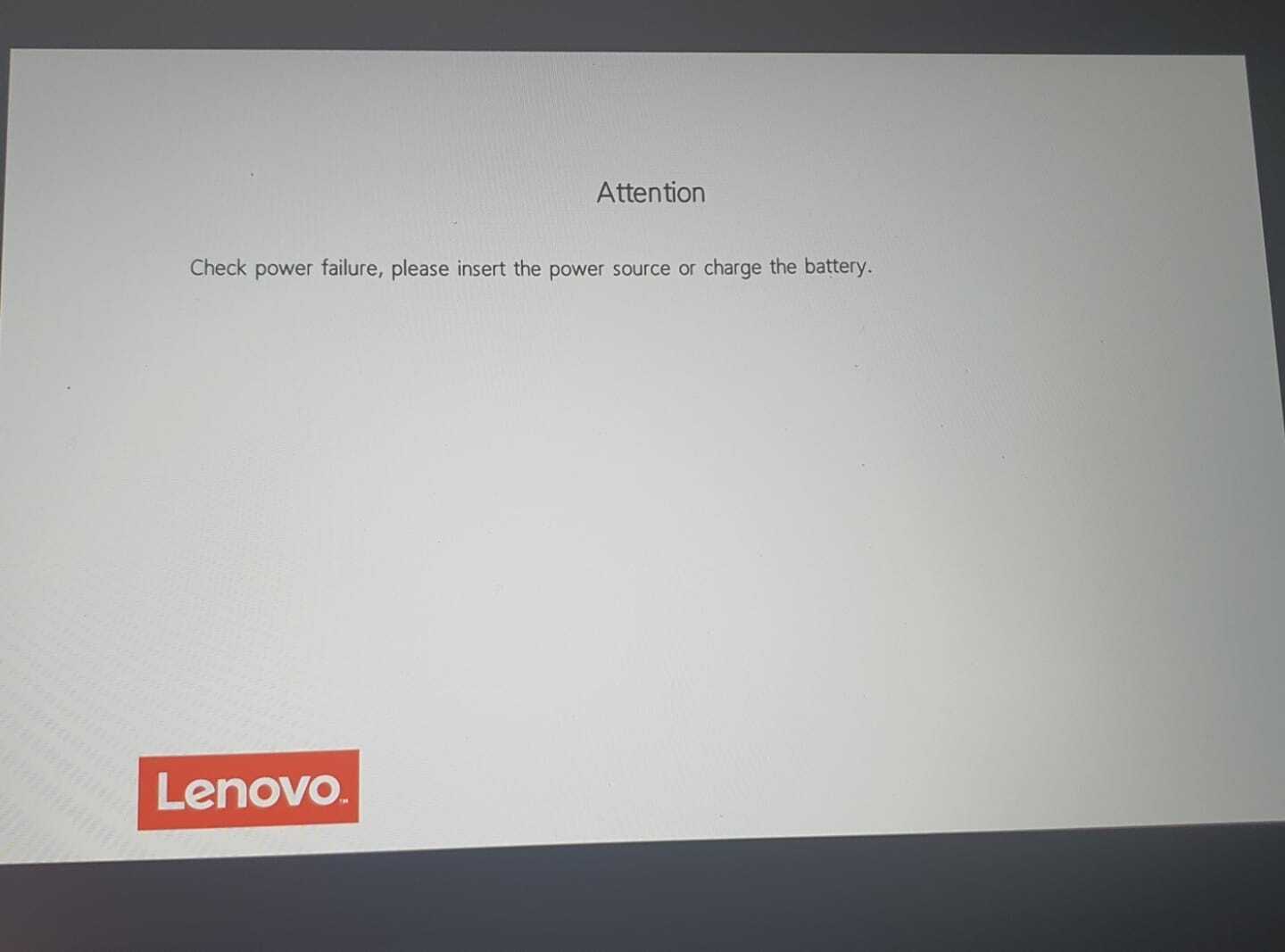

                                    it's the same (Corporate fw). Why don't you try to do a bios update when it starts?
                                    • CraterM
                                      • Mar 2018
                                      • 178
                                      • Moldova
                                      I tried, but I get this error. Battery not detected!
                                      • volinakis
                                        • Jan 2021
                                        • 2740
                                        • N/A
                                        try with clean ME bios I sent you.
