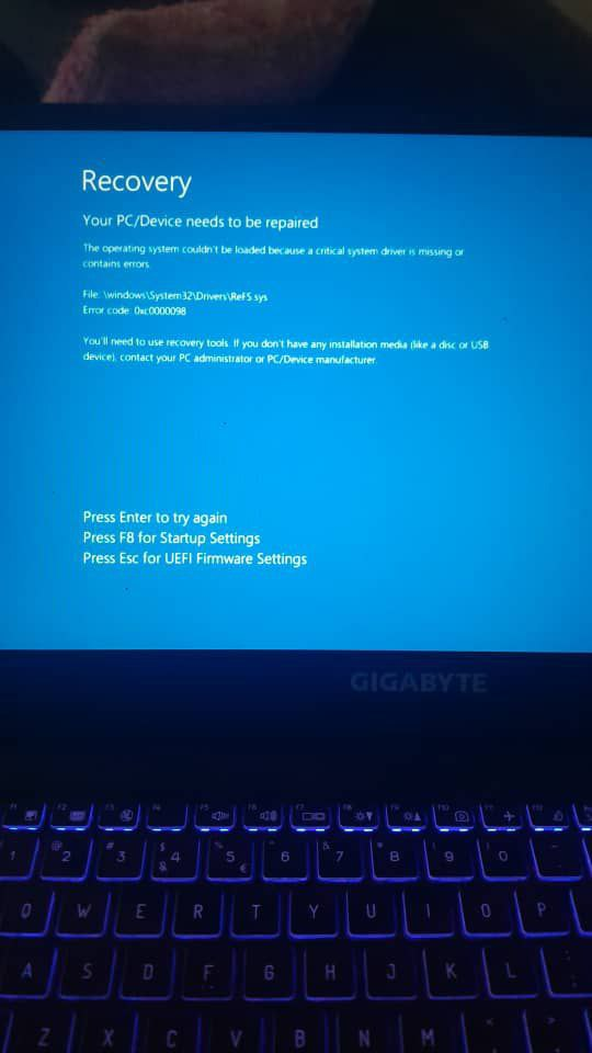

                    I am requesting the full BIOS dump (.bin file) for my GIGABYTE G5 KF5 laptop. The system failed to boot after an interrupted BIOS update and now shows no display. I need the exact BIOS image to reprogram the EEPROM chip and restore functionality.
                    Motherboard details:
                    - Board Code: 6-71-NP520-D02
                    - Manufacturing Model: 6-77-NP50RND2Y0-D02
                    - CPU: Intel Core i5-13500H (please let me know if you need a different variant)
                    - BIOS Vendor: American Megatrends Inc. (AMI)
                    - BIOS Version: unknown (update was in progress)
                    I have a CH341A programmer and an SOIC8 clip ready. Any assistance or a link to a verified dump would be greatly appreciated. Thank you in advance for your help!
                    Best regards,
                    Eduardo Julio

                    post S/N,post the contents of the bios chip even if it is corrupted.. ,etc.

                        The bios chip must be unsoldered from the board before writing or reading..
                        do not use the clip, you may have errors..if you do not have anything to unsolder it with,
                        solder wires between the programmer and the bios chip..​
                        here is a video for example..https://www.youtube.com/watch?v=DWWi...nnel=ThisIsHow
