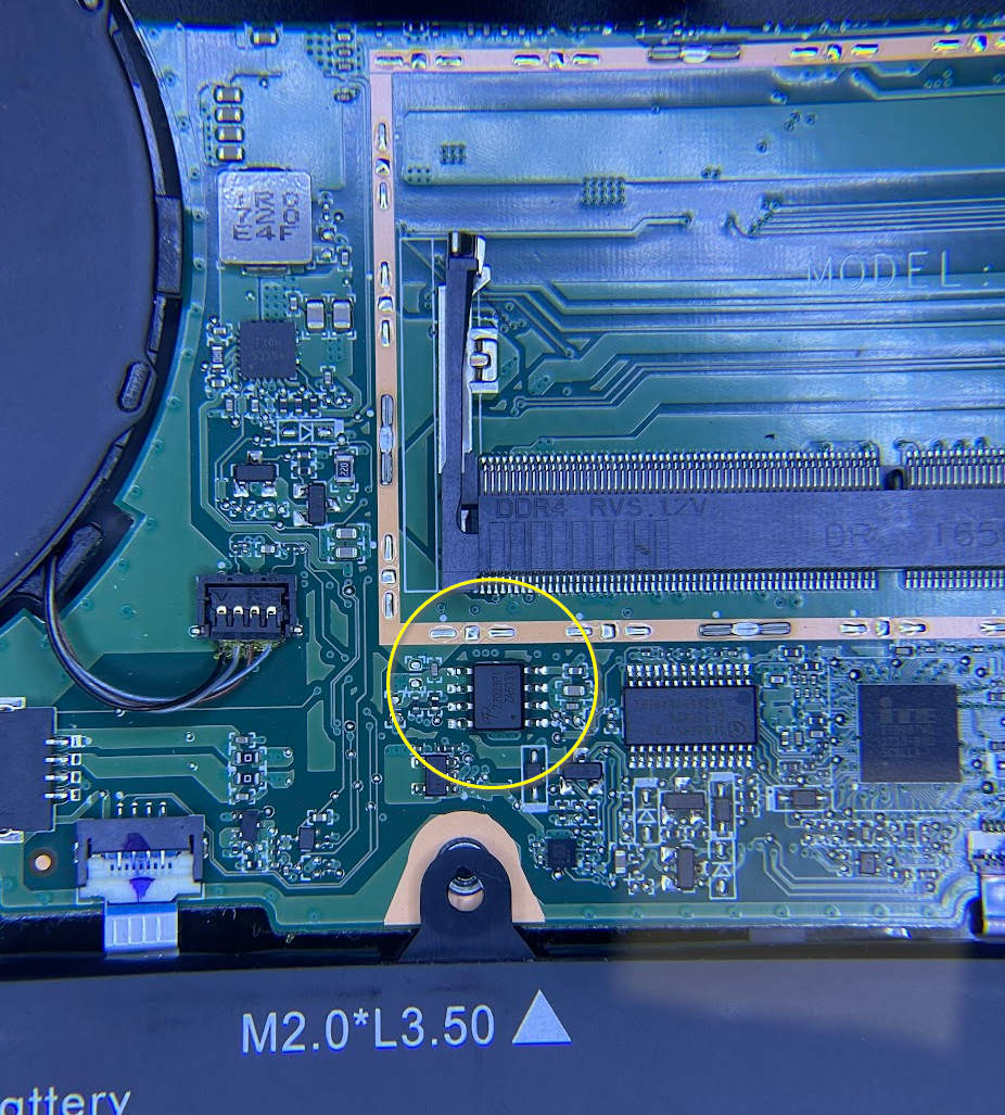

    Upon pressing the power button, all that happens is immediately the fans spin on high. It will sit and do that indefinitely until a hard power-down is performed. No video, no post, no nothing.
    Model# 15-bl012dx
    SN# 5CD7246XYQ
    Prod# Z4Z35UA
    Board# DA0X32MBAGO REV: G
    backup attached.

    You have backed up the wrong chip. That is thunderbolt firmware.

        Is it this one? This is the only other BIOS-looking chip on this side of the board. Perhaps it's on the bottom side?

          No. Google search the part number of the chip Z2023PI https://www.aosmd.com/res/data_sheets/AOZ2023PI.pdf

            Interesting, I searched for that on alldatasheets but it didn't pull up correctly. I think I found it up by the CPU. It's Winbond 25Q64. That must be it. I'll be back with the backup. Thank you SO much for the help.

              Here it is!
