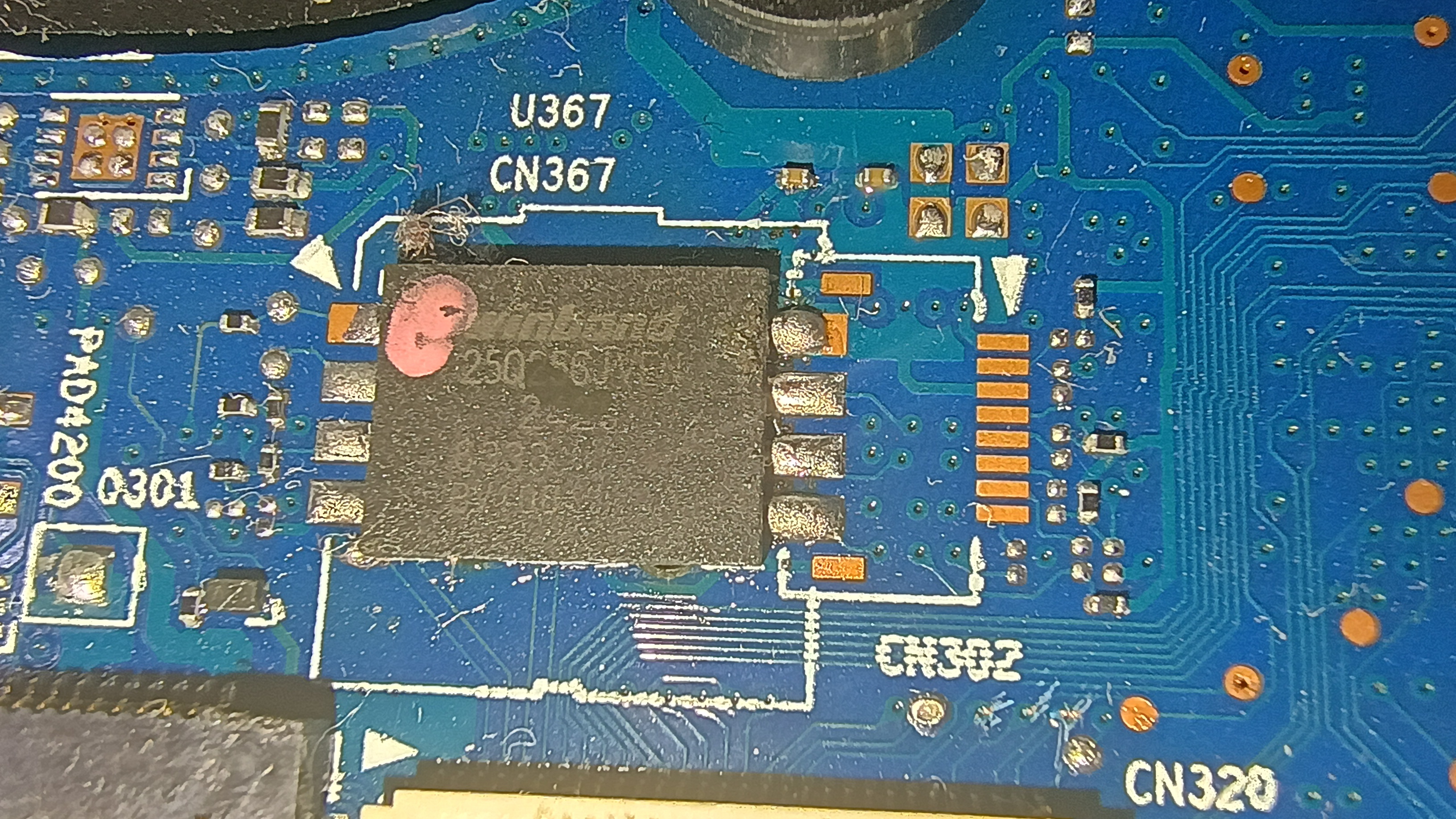

          SN: 5CG3160404
          PRODUCT: 841W8AA#ABA
          help me to modify the Bios after CPU Swap form i7 1365U to i7 1355U

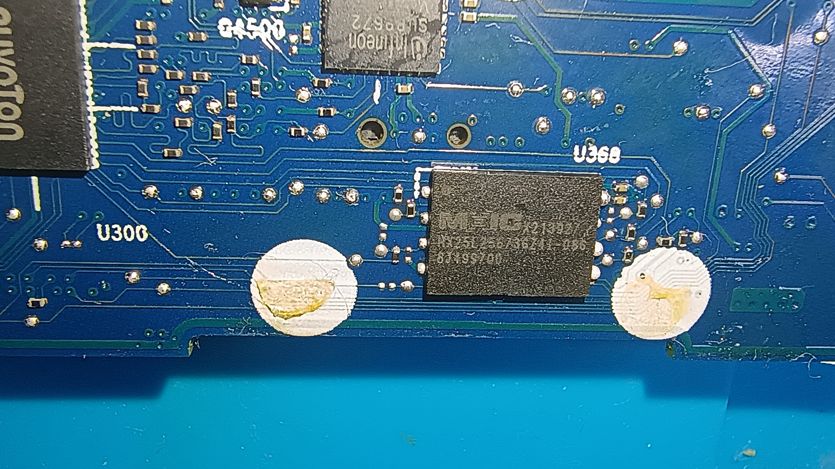

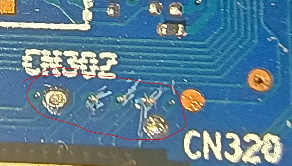

            The EC on this is npcx998 The board doesn't turn on at the moment even after clean the me. I doesn't know how to clean the nvram, maybe that would help.
            The replacment cpu is prom a known good motherboard so I can cross the possibilities off a bad donor
            If possible please help me.
            Thanks in advance

                its from dell vostro 3530 / LA-M367P,
                additional info:
                The board is charging

                  The PCH has intel boot guard. You could only use that SOC as a donor for another dell

                    i have a few other board but its all dell board,i also have HP and Lenovo but it i7 1360P not U,
                    does all dell PCH is boot guarded?,
                    and also is it not possible to dissable the boot guard thru bios modification?
