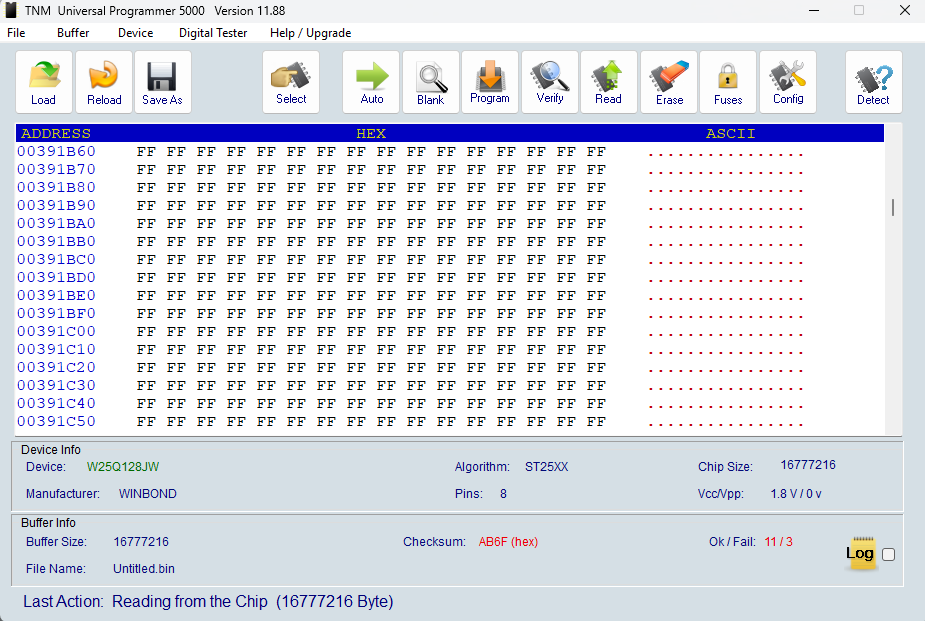

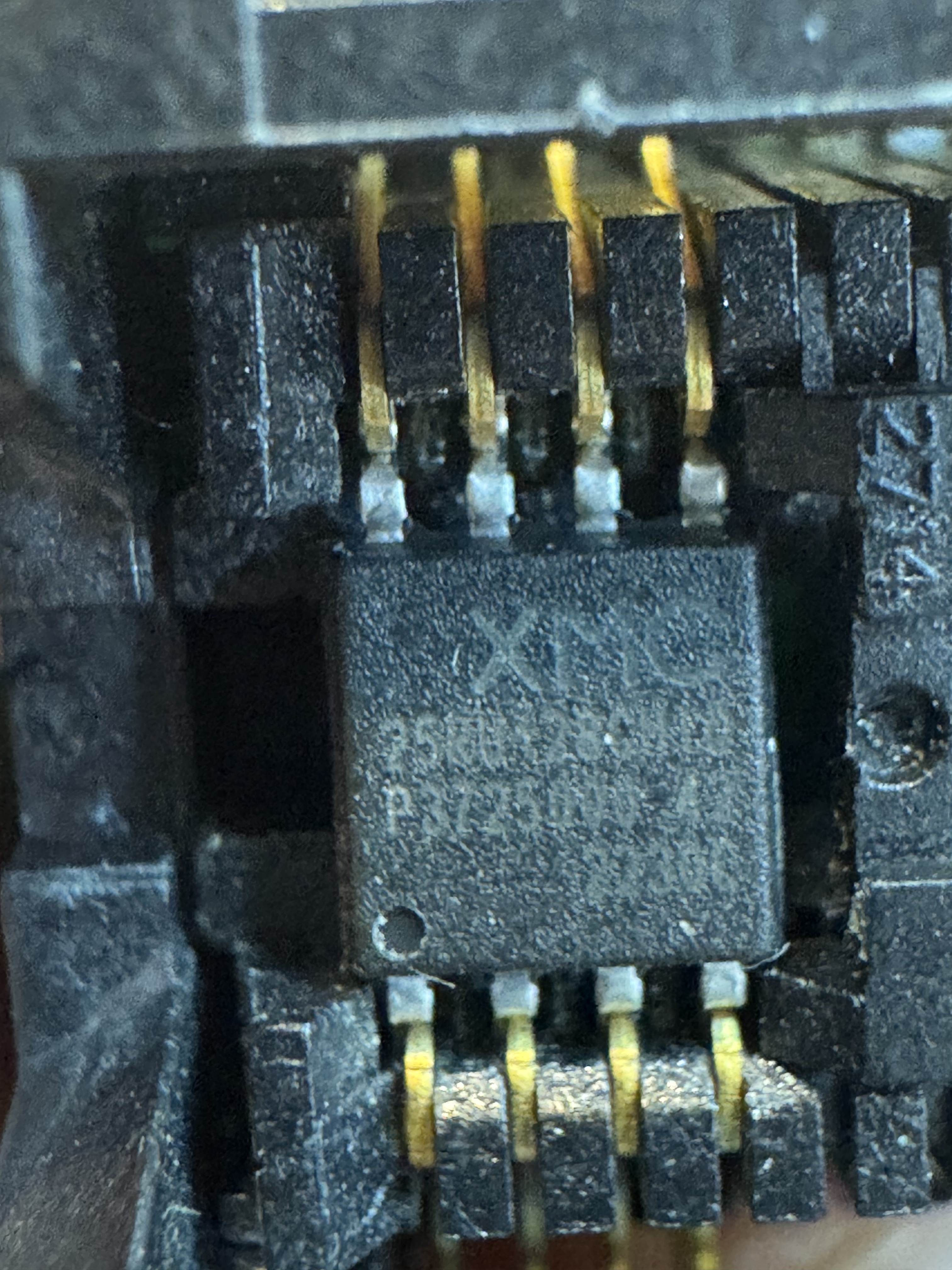

                            Could you please provide me with the BIOS file for these specifications? I forgot my supervisor password.
                            IDEAPAD 1 15AMN7
                            SN: MP2E7LFA
                            MTM: 82VG009DAK
                            HLS1C_HLS1D LA-L502P
                            HLS1D81004P
                            PN: 5B21D45331

                              Please attach a backup of your current BIOS, you need a hardware programmer, password can be decoded or removed from there

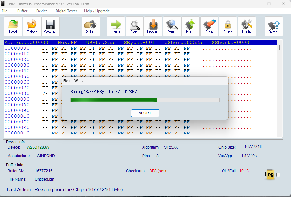

                                I tested with several different programmers that I had access to, but unfortunately none of them were able to read the BIOS chip’s data.
                                It’s worth mentioning that the programmers don’t have any issues with other chips, and all of them were up to date. The chip itself is fine as well — when I put it back on the device, it worked without any problems.

                                  See here for a possible workaround https://www.badcaps.net/forum/troubl...03#post3565103
                                  Try manually selecting W25Q128JW, and uncheck "ID check" or similar option in your programmer software
                                  Make sure your programmer supports 1.8V chips
                                  If you can't read the chip contents, properly don't expect you'll be able to write to it

                                    Thanks for the quick response. Unfortunately, I can’t get any information from the BIOS chip. I even got a 1.8V adapter and tested it with two different programmers, but still no luck.

                                          The file had an issue and was corrupted. I tested it with all 128Mb models with 1.8V, but it didn’t work.
