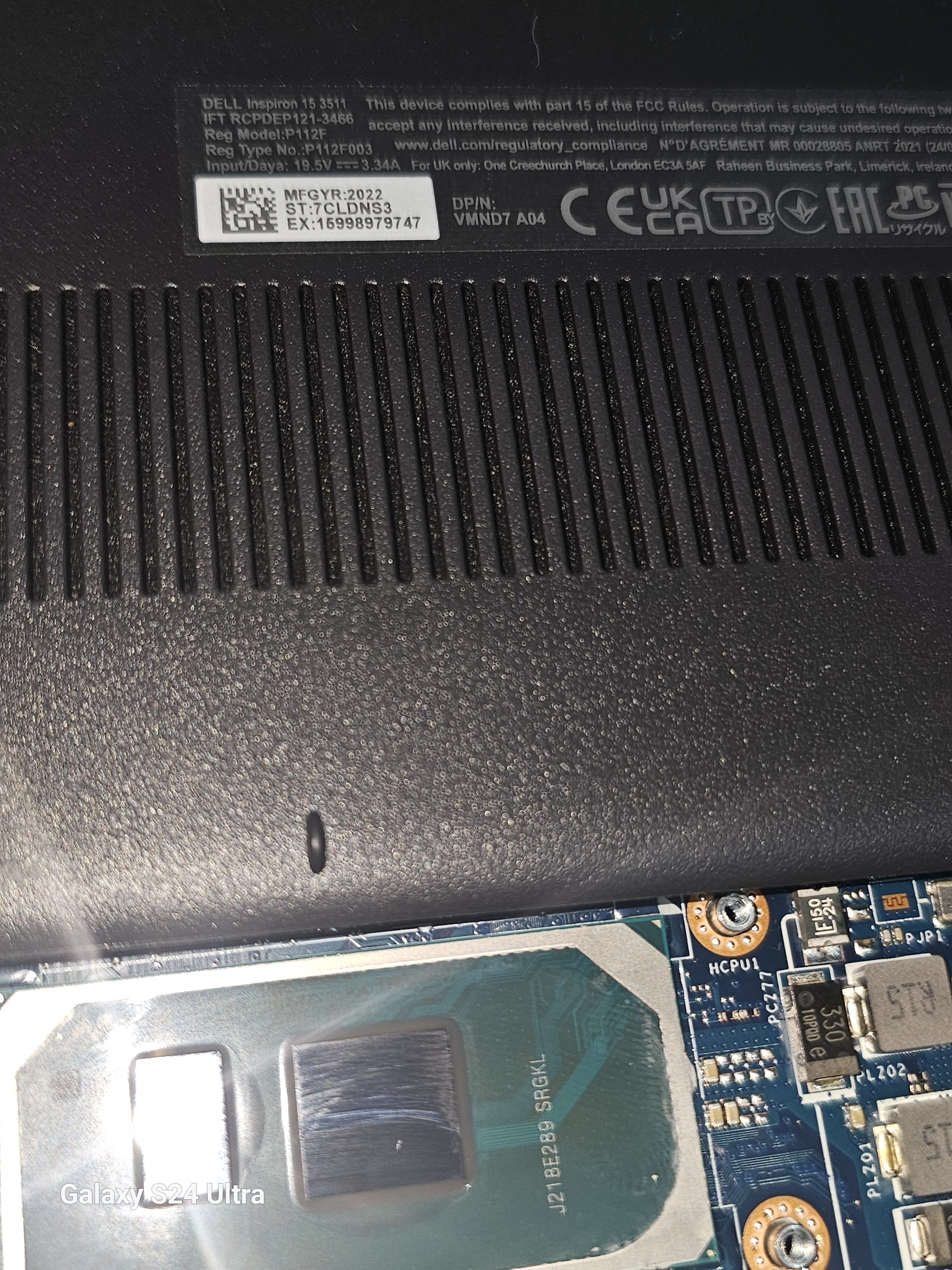

    need help to fix the bios pls Vostro 15 3511 GDM52 LA-L243P rev 1.0 (a00) i5 intel

      sorry for the bad post my service tag 7CLDNS3 I have tried multiple bios and still fan just spin and no image at all, caps led blink

        The service tag number 7CLDNS3 is for the Inspiron 15 3511, not the Vostro 15 3511.

          [QUOTE=hoaca388;n3335069]The service tag number 7CLDNS3 is for the Inspiron 15 3511, not the Vostro 15 3511.[/ mi mistake Inpisron 15 3511 Reg model P112F

                I moved your post to a new thread as you said it was a Vostro 15 3511 . What is your CPU part number, and the dell motherboard part number D/PN:

                  motherboard full model : GDM52 LA - L243P REV : 1.0 (A00)
                  Here is. Hope u can help me. I tried so many dumps and nothing yer. I know its 100% bios problem.

                    Try to flash two chips

                      Thank you all for your time. Unfortunately, the fan still just spins, with 800ma consume , with the caps lock light on and no image. I've tried everything for 4 days, but still nothing. I'll have to return the machine to the customer.

                        maybe a hardware issue
