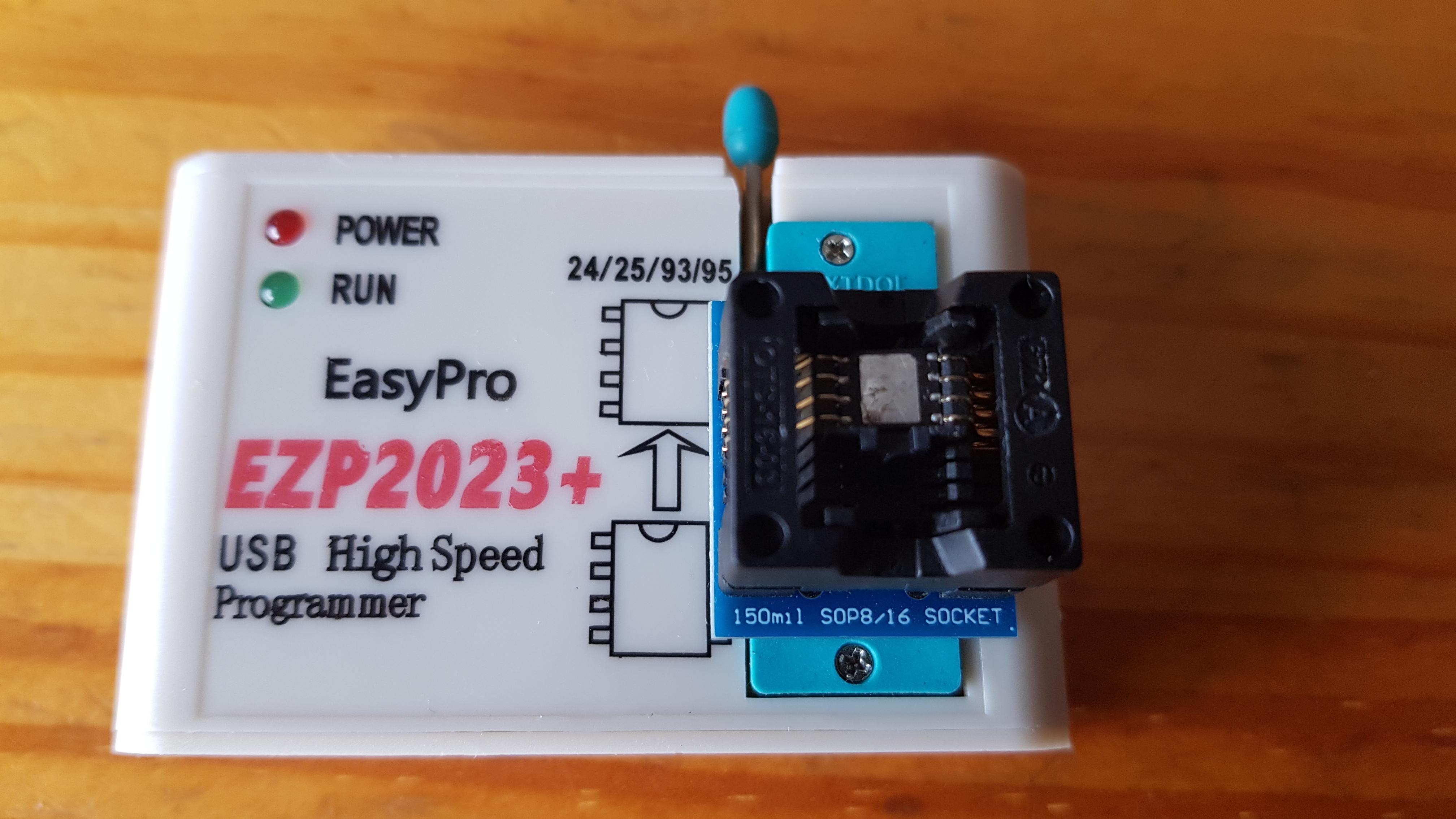

    I have succeeded removing the Winband W25Q128JV from the MotherCard => should I also remove W25Q64JV ?
    When I am reading the 128 with EZP2023+ it's telling me it's ATMEL 93_EEPROM AT93C46@16 ...
    Is this program reader able to detect this chip ?
    I have used a adaptor from SOP8/16 to DIP8 (150m) : is that correct ?

                I will but with the EZP2023+, is my adapter's correct (see attached picture) ?
                In what position should the chip be in the adapter (there 4 possible positions) ?

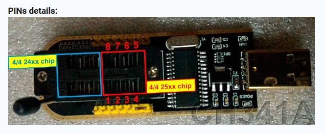

                      I am using Neoprogrammer 2.2.0.10 with no voltage adapter.
                      My question is how should the chip adapter should be plugged in the CH341A (I think in the lower part but what position ?).
                      Same question for the chip on the adapter : should it be with the black side upper or lower ?
                        You can find a link to a CH341A programming guide at the winraid forum --> 1.1.1.6. CH341A https://www.badcaps.net/forum/troubl...21#post1622421

                                  I had a soldered chip that I took off from the motherboard, so I can't use the clip. I'm just asking how to put my chip in the adapter (the black side up or down) ?
