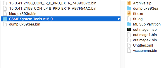

    I need a working BIOS from the UX393EA motherboard, I am attaching a screenshot - the laptop starts up and the diodes are on, but there is no image, the current consumption is sometimes 0.04A.
    Laptop SN: QCCBKV0TC04601915
    Thanks for help

        your dump is corrupted, read bios chipset again, if you have CH341A use AsProgrammer and read multiple times until you have 2 identical dumps.

          I've read this EZP2019 chip 3 times and each time the file is identical, that's probably why this laptop doesn't work

              I found 2 ME firmware for your laptop so I bult 2 images, try them both

                Thank You guys - nothing change. Propbably procesor damaged, on thermosvision i see heating SB
