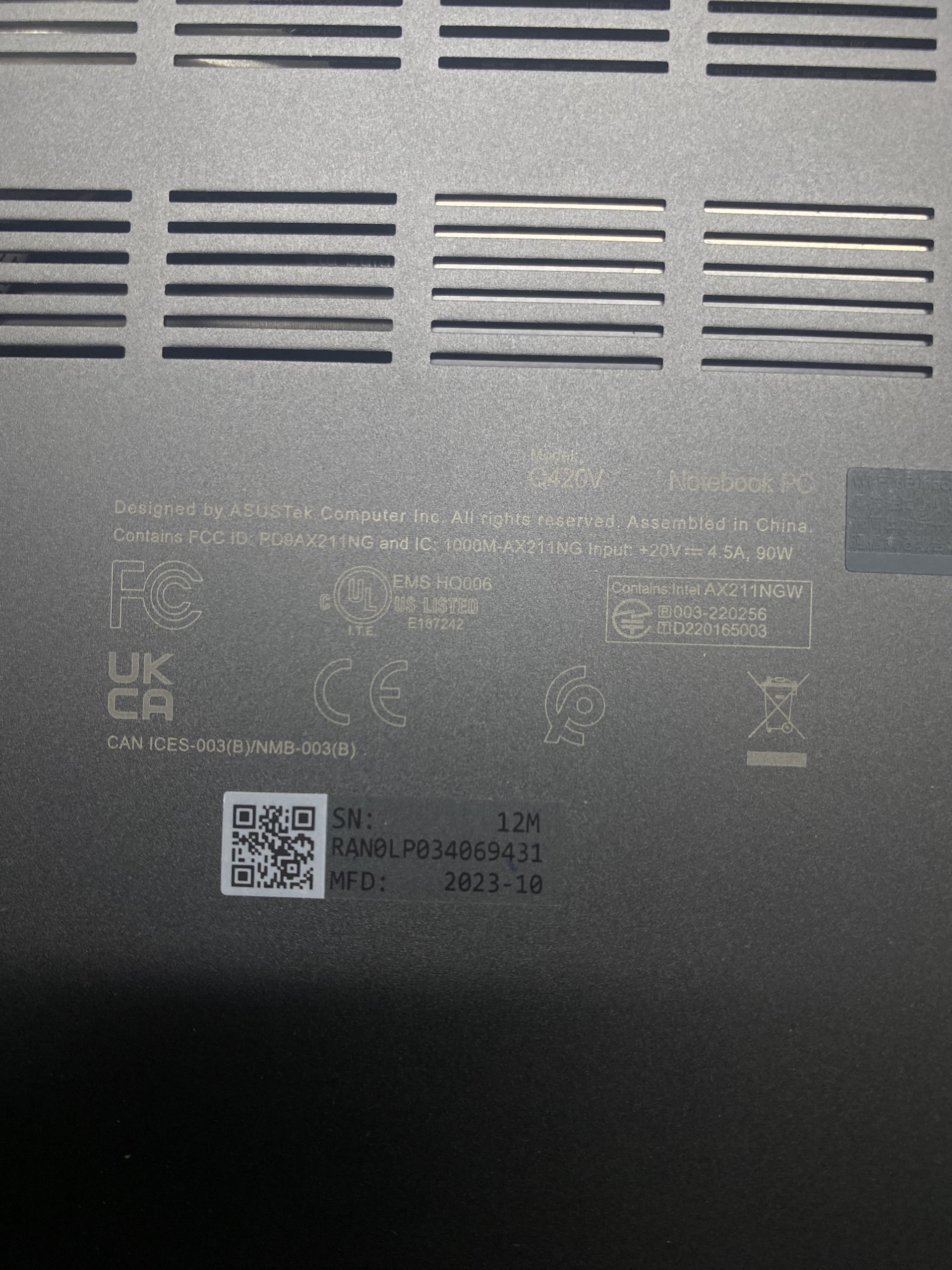

    Can you post a picture of the barcode sticker or QR code on the motherboard
      orry I took a few days off Click image for larger version
        SMDFlea commented
        Editing a comment
        The QR code or barcode sticker on the motherboard !!!

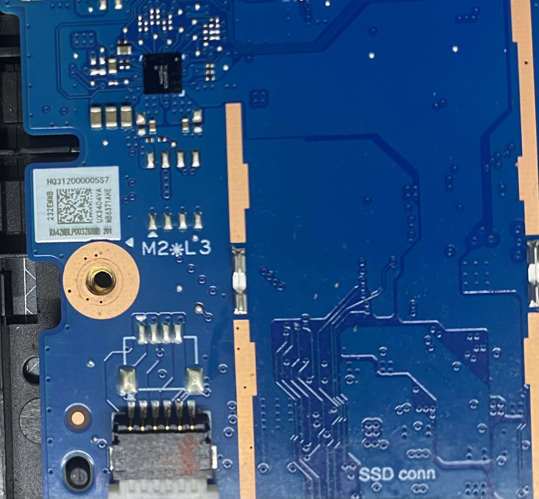

              help
                • 20888
                Originally posted by chinh
                Click image for larger version  Name:	z5557380508244_7b2103d0e792152838724d558a8afcb3.jpg Views:	0 Size:	474.3 KB ID:	3293858
                help
                The part number on the sticker is the bios you need UX3404VA .Your bios has corrupt ME firmware,it cannot be fixed.That means you must find a UX3404VA bios dump. I`ve searched around and i can`t find one. One of our members works for Asus service, he does not visit badcaps regularly but if he sees your thread he may post an F1 asus service bios. The bios at the asus website is only a partial bios not a full bios image.
                The only other way to fix it would be to find a bios from a similar model with the same ME firmware and merge your bios region with it,or a UX3404VA bios update,and copy your DMI to it. Asus are using bootguard profile 5 with newer models.
                  Here I have a file displaying images
                  But this file uploads slowly, the screen turns off but the fan and key lights still run.​
                    Clean Me
                    • chinh
                      • Mar 2020
                      • 89
                      • viet nam
                      Originally posted by hoaca388
                      Clean Me
                      Thank you it worked very well
