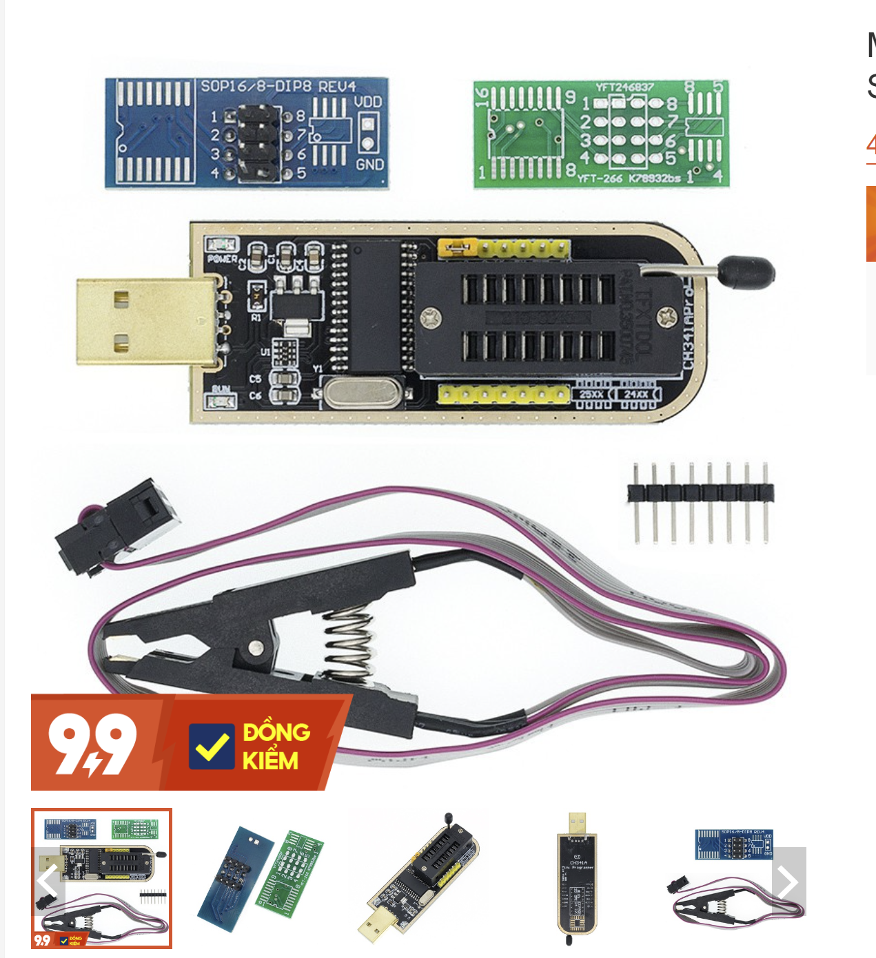

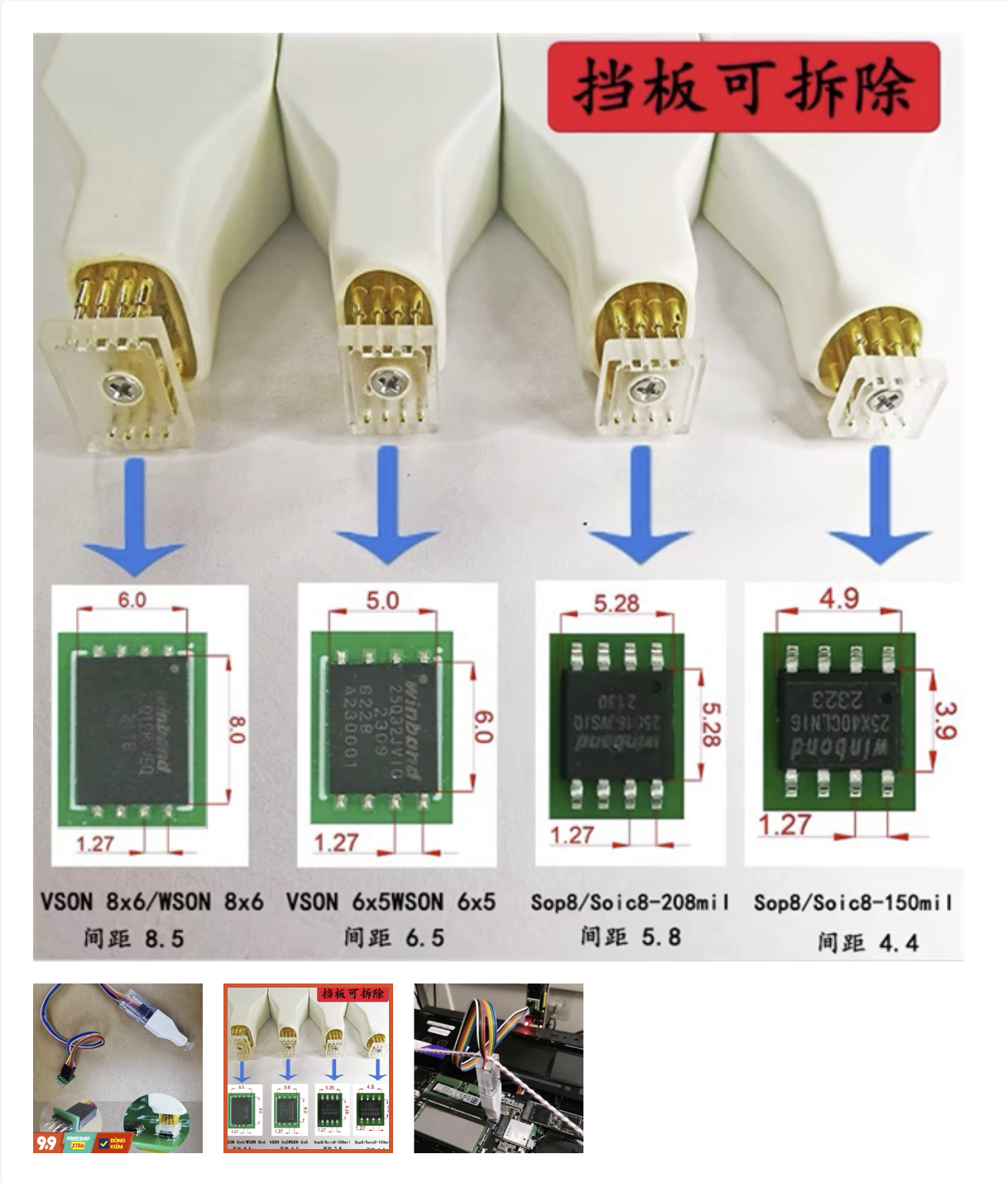

                                    You have to learn how to use a programmer, the cheapest one is the CH341A.
                                    https://www.youtube.com/watch?v=Ta_PPndnCTk&t=447s

                                      hoaca388, thank you for the tip!
                                      Nevertheless, I'm a newbee on the domain. Is there a end-to-end process somewher on the forum to guide me on the steps?
                                      I understand the steps:
                                      Find a CH341A with motherboard connectot and the gets the associated soft (AsProgrammer?)
                                      Identify which cheap to connect on the Motherboard
                                      Make the extraction/dump
                                      Then How do I program it in hexa for suppressing the password?
                                      Anyway, thanks for your support.
                                      No urgency as my PC is working well with W10 and even can be upgrade in W11. I just would be happy to control it if a BIOS change is needed.
                                      Best

                                        The fist read : https://www.badcaps.net/forum/troubl...rces-and-tools
                                        The software (Asrogrammer,.....) is free.
                                        Post your locked bios here, someone will unlock it for you.
