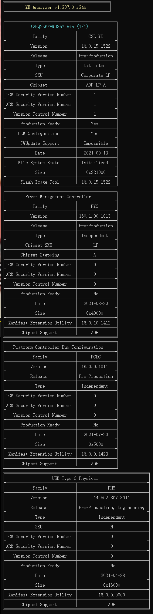

    i'm doing some experiments to update my ME with different combinations of IUPs, but i cannot find a RGN ME of my current version 16.0.15.1522 Pre.
    Can you help me to clean the ME data of my current bios dump from initialized to configured, so that i can extract and rebuild via FIT later? I have tried myself several times but due to lack of necessary knowage still unsucessful...
    Thanks in advance!

            It has Pre-production firmware with different RSA keys to PRD RGN firmware.

              Thanks for the explanation, i know it is a pre fw, i just want to know if the clean process can be done through winhex or other ways so that this pre me fw can be extracted and used for rebuild. I tried before with csme but the extracted ME Sub Partition.bin is not usable for rebuild...

                Send to you, try !!!

                  Many thanks minhdigital​, the 1522 pre is now in configured state. The 1662 prod i flashed also, the same results like i tried before with other prod fw, maybe like SMDFlea said i have to stay at pre fw because of different RSA keys.
