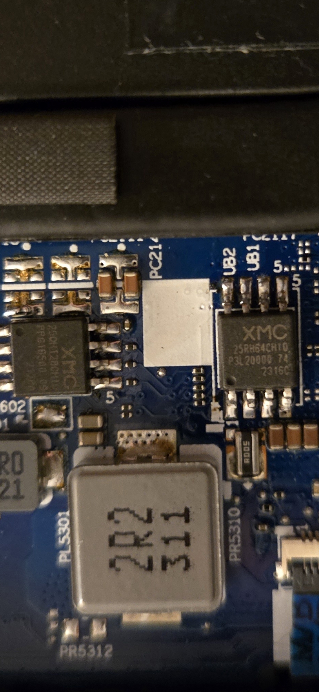

The rom file Y780-RPL_GN21-X6_Base55W_Max140W_0010_775_2_gsync__95.06.1E.00.98_PP.rom can be padded out with FF`s to whatever the chip size is using a hex editor. What size is the chip ?
I extracted the rom file easily by running "legion_y9000p_irx8_rtx4070_vbios_update" then get it from %temp% folder.
Most of the time when I found a vBIOS posted online, it's always smaller than the chip size by a few bytes. For an example this one is 2000KB (1F4000h) but I think the chip will be 2048KB (200000h). Also when I compare between the 2 files, I found the extra length in the original dump filled by 00`s, maybe the programmer is doing this by itself.----------------------------------------------------------------------------------------------------------------------------------------------------------------------
