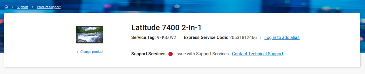

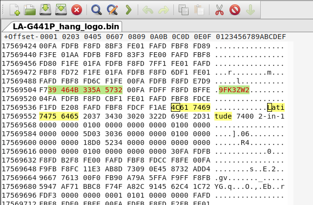

Now from the information in the original BIOS there seems to be a problem with the service tag.

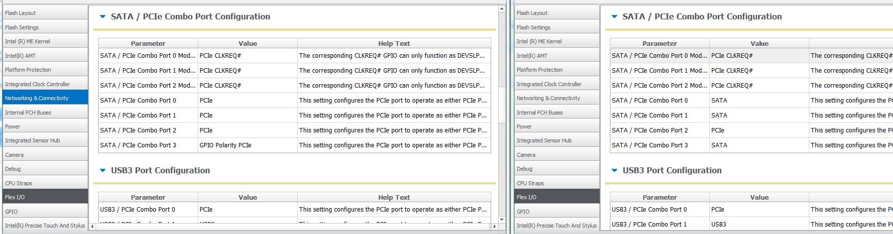

Comparing the ME firmware in the 2 bios you posted there are many differences. Trying to fix the original bios is best as it will have the OEM configuration. Some of the differences are AMT, Integrated clock controller, OEM key , Integrated clock controller, sensor hub, Intel PTT , FlexIO.
