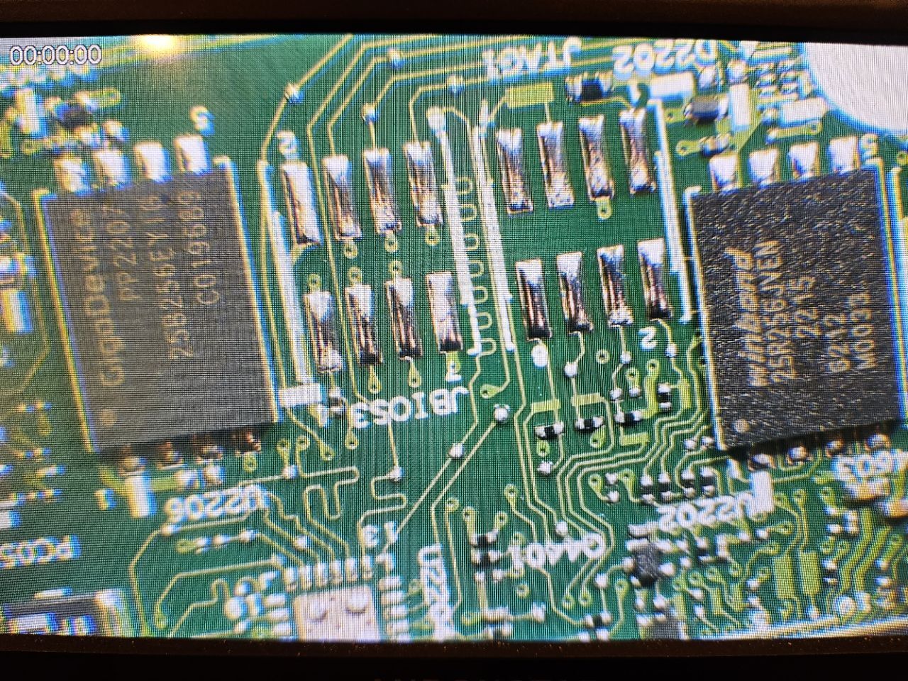

    I have this Thinkpad T15p Gen 3 laptop. It starts normally with keyboard lighting up, I can hear the fan starts spinning, amps quickly reach about 1.7A without the battery, CPU gets hot. However, it is not posting.
    I suspect the BIOS is corrupted. I am providing 2 BIOS files as I see 2 BIOS 256Mb chips. I am also providing a photo of the chips' location on the motherboard.
    Model: Thinkpad T15p Gen 3
    S/N: PF-45G6VM
    Type: 21DA-000PUS
    Motherboard: NM-E221
    Thank you.

    Post bkp bios

        I have 2 bios chips. Which one does your file represent?

          WB25R256JVEN = image

            I reflashed the chip using your file. Computer stopped responding to the power button, acting completely dead. All power rails are present.
