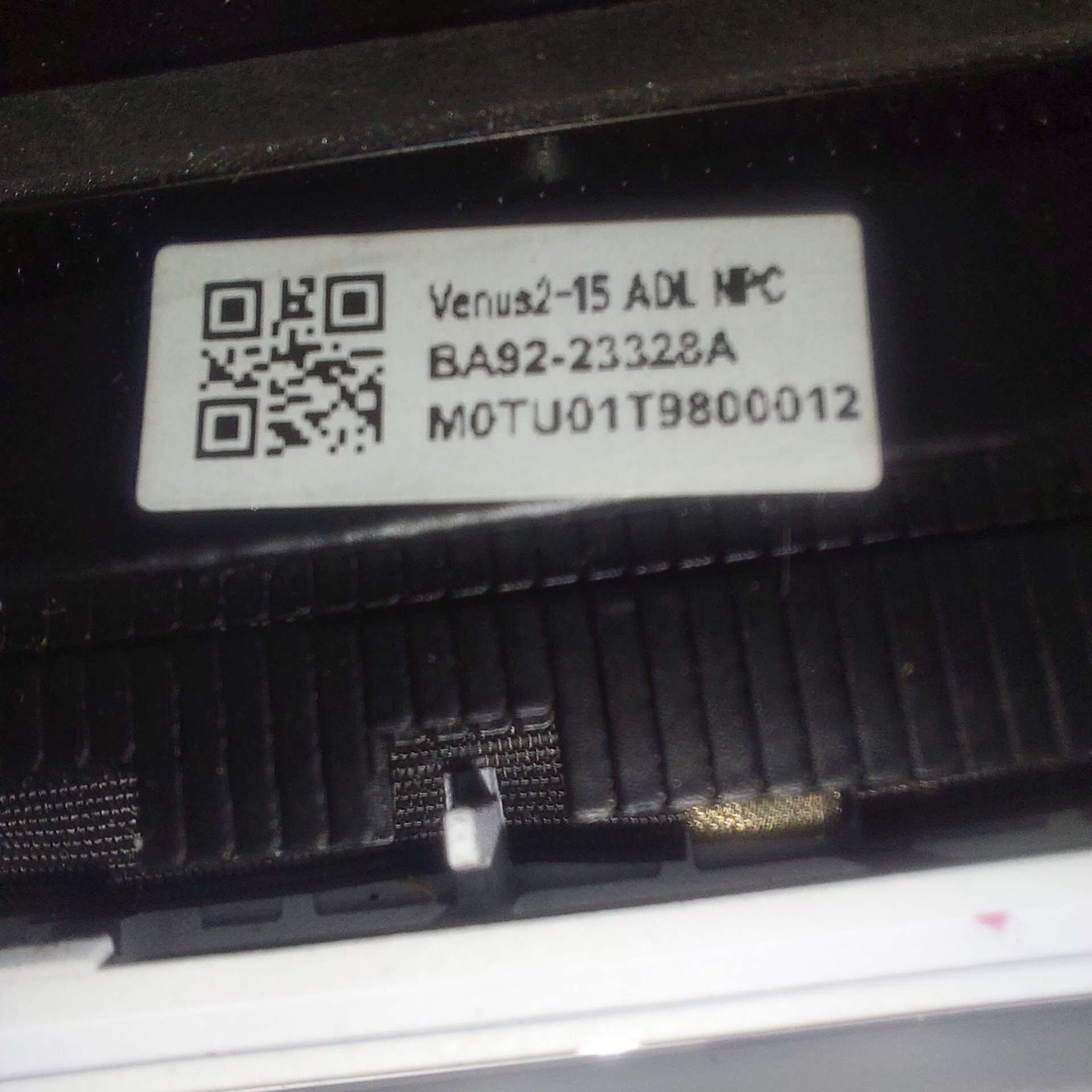

    pcb Venus2-15 ADL
    or Venus2-15??

      Apologies for the late reply.
      It's Venus2-15 ADL.

                    Reminder that PC is the:
                    Venus2-15 ADL NPC BA92-23328A
                    M0TU01T9800012

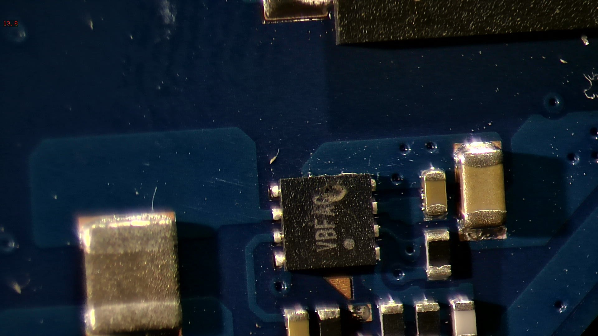

                    • sean1234morgan
                      Technician
                      • Dec 2022
                      • 7
                      hey man, just wanted to say i ended up with the same issue from a customer, found a tiny fet witha hole in it, double check this ic on your board as it fixed my issue, bios is most likely fine
