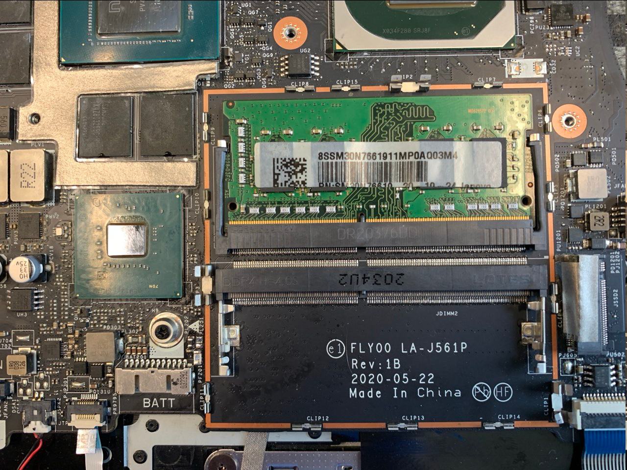

                    Hello, I would like to ask for help regarding the dump of:
                    UG2 / W25Q80EW - Winbond (1MB)
                    UH3 / XM25QH128A - XMC (16MB)
                    ...for Legion 7-15IMHg05 (Lenovo) - Type 81YU
                    Died on a black screen after BIOS update!
                    There was also a burnt coil element (PL201)
                    Thanks in advance to everyone who respond

                      Thread merged. Post your bios backups and type as text the laptop serial number.
                        The problem is that there is no serial number anywhere, because that's how I got the laptop!
                        All the Type / SN stickers have been removed!
                        I only looked at the inscription under one of the RAM memory chips​
