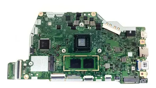

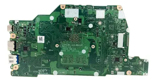

    i need Acer Extensa 215-23 bios
    my motherboard no. is ih5jm la-m611p rev:1a RYZEN 5
    model no.N23C3 my SNID no.31304617934
    issue:blackscreen and the fan not working i downloaded bios from support can someone help me or can guide me how to extract bios from support
    this is my backup...

      i download from support but i can't extract the bin file can someone can help my problem?
      • alfie73
        • Oct 2020
        • 31
        • Philippines
        does anybody know how to extract bios from exe file from support i try to extract it using 7zip i got abobios.bin but it's 18mb file ..

          Originally posted by max_sneka2
          Try This File and Reply
          after i flashed your file the problem still they same black screen and fan not working
          • alfie73
            • Oct 2020
            • 31
            • Philippines
            im using rt809f programmer to flash the bios ...

                Originally posted by alfie73
                up for this problem not solved
                Extensa 215-23
                        UP FOR THIS PROBLEM NOT SOLVE
                        The file I posted is the original bios from the Acer homepage, if it doesn't work it means you don't have an error caused by the bios. Look for hardware errors.

                          Thank you sir maybe it's hardware issue...sometimes the lcd turn blue ....and sometimes blackscreen but the fan not working
                      • alfie73
                        • Oct 2020
                        • 31
                        • Philippines
                        can someone tell me where is EC bios ic here ?
