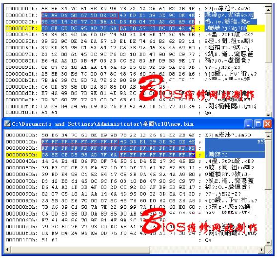

                    Re: toshiba tecra a8 bios pasword
                    ok your solution read 24c02 and erase link see pic
                        i cant understand this table can u discribe this is for what.......thanks
                            you have to read out the eprom then you open the file with any hexeditor go to this address, erase the data as shown, save it and flash it back to the eprom, this will clear the password.
                                  Dycc got this board , and the chip itS a 24c08 , i have done in the past a reset , that was needing to bypass between pin 5 and 6 in a different laptop , altough dont remeber the model , any tips?
                                      well i guess for the 24c08 the adrtess thaTmust be erased is in another location,
                                      so anyone can share with HEX lines i must set to 0(FF) , since i've done that above on the 24c08 chip and it didnt work , still asking password
