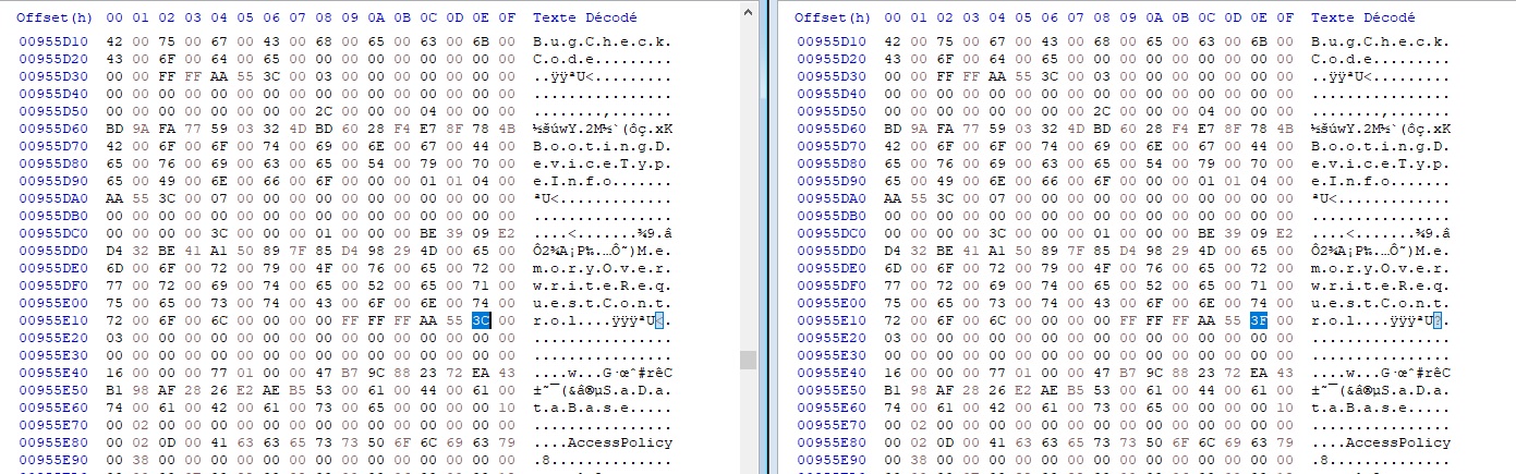

      To do this you need to:
      - use the search function in the forum
      - use some dumps and compare!
      why should we explain to you if you haven't done the research
      hint: try look for hex>ascii on this side
      53614461746142617365 and search for the message on Ideapad written by AAAC
      maybe the right way

                just compare file with HxD and see

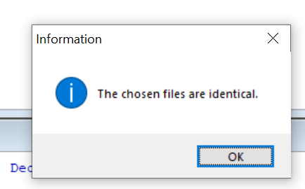

                    guys you don't make an effort to search:
                    - open HxD
                    - Ctrl+k for compare two dumps
                    - F6 to move forward

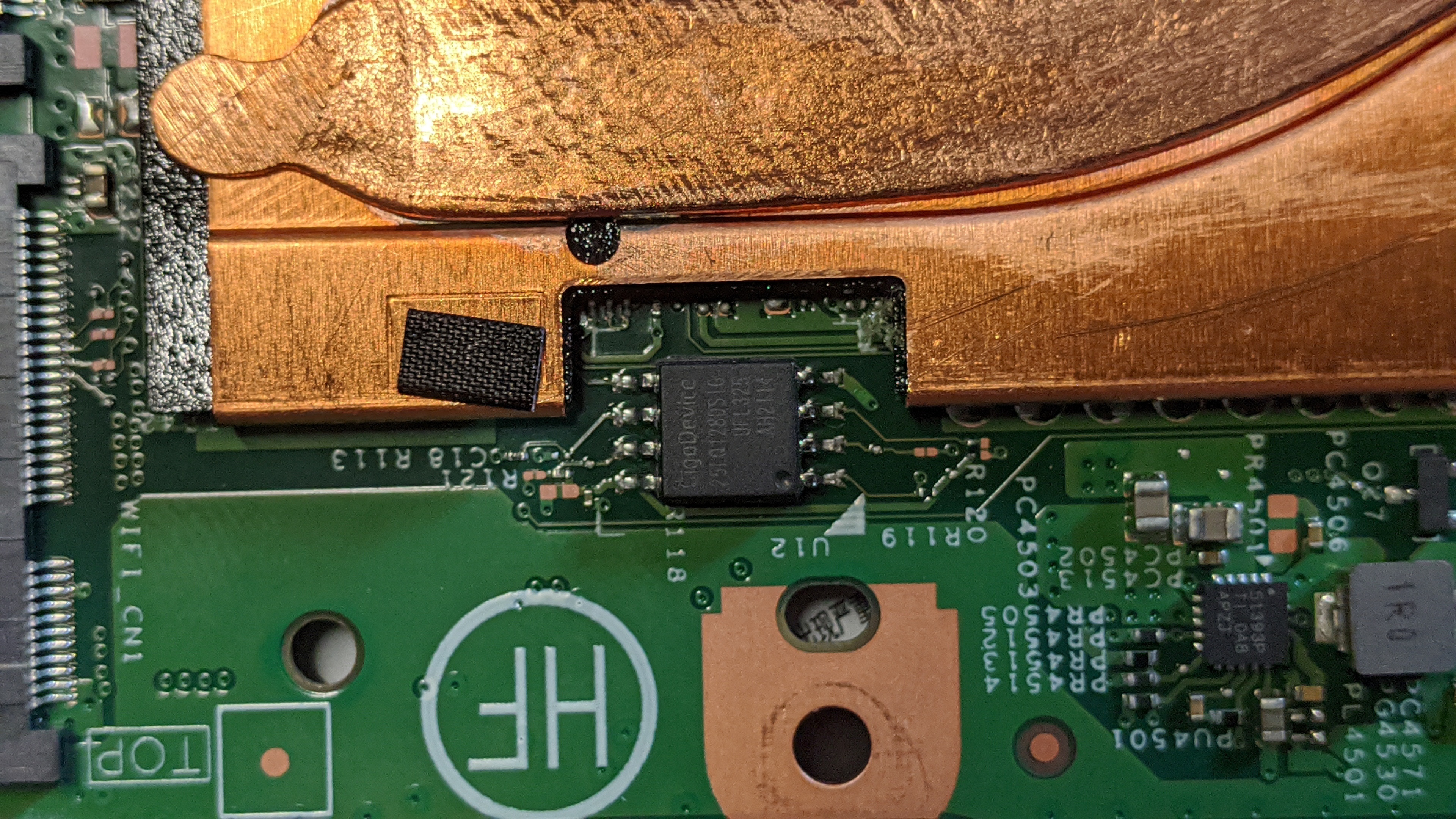

                            Hi SMDFlea, I tried the unlocked BIOS of this thread already, but I couldn't flash it due to a bin too large for the chip. It's very close but the motherboard model is also different. Mine is 203105-2 and the one of OP is 203105-1m.
                            Picture of the chip for info.

                                Hi franklinogot, thx for your help, although it looks like your patch is identical from the original dump, is there something I'm missing?
                                I've managed to flash the EEPROM chip in the meanwhile with the updater from the manufacturer website. The serial number and other similar information have been deleted in the process but everything is still working fine.
