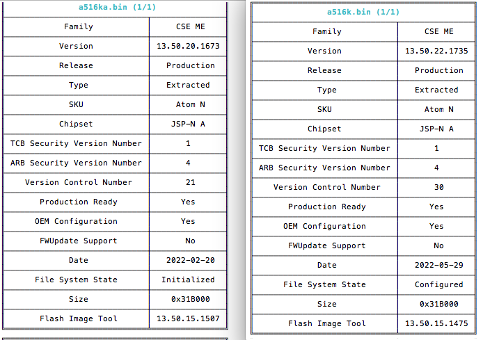

    Please help me with bios for Asus A516KA, it has no image, I don't find ME firmware for it to perform a clean ME.
    SN: R3N0CX043867139
    MB: X415KA R3.0
    Model: A516K
    Attached bios dump and update from asus site.
    Thank you.

          right, I searched on Asus website by serial and downloaded bios update. Inside original bios there is X515KA.308 bios version. Extracted capsule from update doesn't help, it's an UEFI image who doesn't contain ME Region.
          CSE ME is 13.50.20.1673 and can't find this version, I did try with 13.50.22.1735 but no joy.

            thank you for effort, I bet you did a good work (I don't have error in MEAnalyzer as original bios) but unfortunately laptop doesn't have image, now I know bios is ok and I will start searching for hardware fault.
