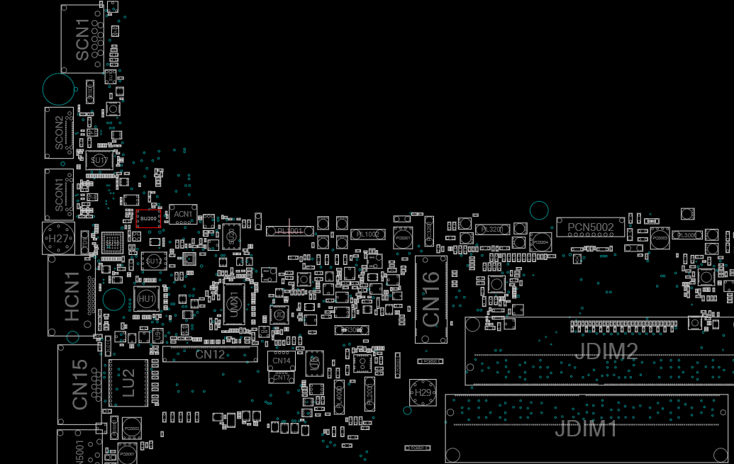

      I just realized that its not the BIOS chip that has blown up but a 32kbyte EEPROM (EEPROM CAT24C256WI-GT3 SOIC8 8P) [SU200 on ASUS _TUF_Gaming_F15_FX507ZM_60NR09A0_MB2010_FX507ZM_MB_0M_I7_12700H (.FZ).fz] so its unknown contents are forever gone.
      Haven't yet tried to read BIOS chip (GD25R256E) as i need to get some tools for QFN8.
      Anybody willing to dump the small EEPROM's contents for me? :cry:

        Re: ASUS TUF Dash F15 FX517ZM da0njkmbae0
        SU200 location
