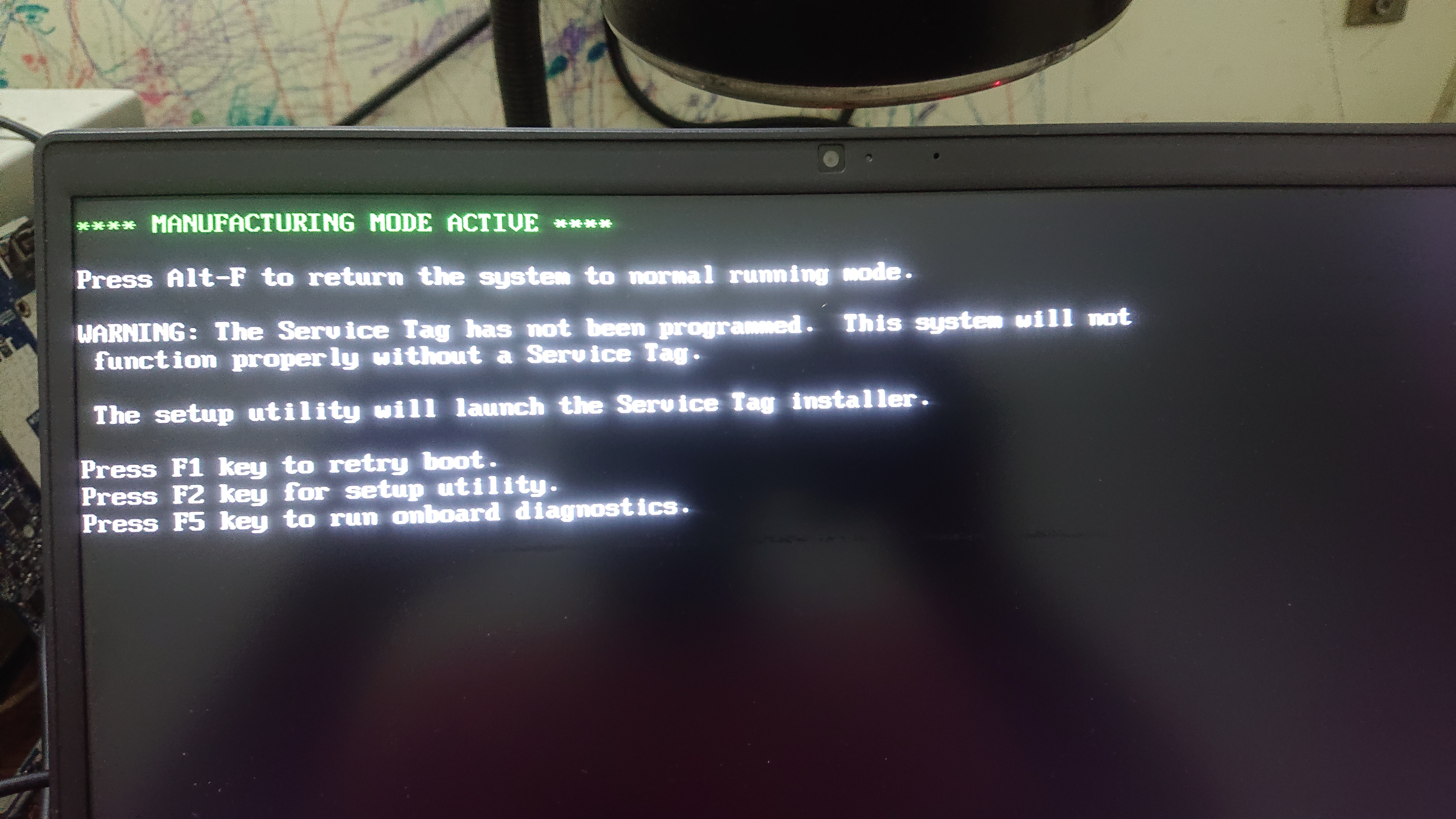

                      plz find out the attached file. can please clear this manufurator mode active
                      and upload my bios dump also , plz clear me this error

                        BIOS board number MKB-L14 CML UM 19746-2 Tested. Clear manufurator mode active

                          Hello everyone
                          I use this dump to flash both 16mb and 8mb bios for laptop that have no display ... now it is ok and working but in manufacture mode,
                          I tried to enter the service tag in bios but it's not saved !!!!
                          the problem is that I deleted the original bios dump
                          any help or suggestion please? can inject the service tag in the working dump here?
                          ST/1H1R4B3

                            Hello, problem with SERVICE TAG ("manufacturing mode active") can someone add it to this bios?
                            servis tag: HCD7203
                            ST/1H1R4B3 CHANGE
                            MKB-L14 CML UMA
                            19746-2
                            YJCJD$JB
                            DELL LATITUDE 3410

                                    Hi friend, this worked! I just had to add the servis tag in the bios, this time I saved the changes and it worked. Is it too much to ask you, what are the steps, how did you do it? I would like to know the process for future problems, this time you saved me!
                                    thanks!

                                      Works perfect i can change the service tag, thanks!!!!
