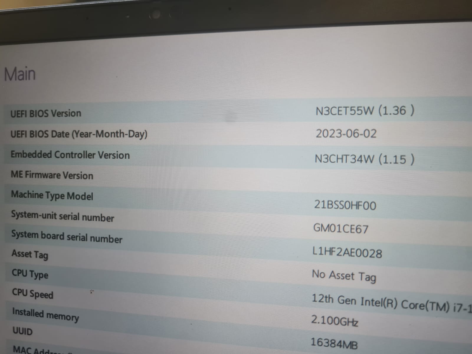

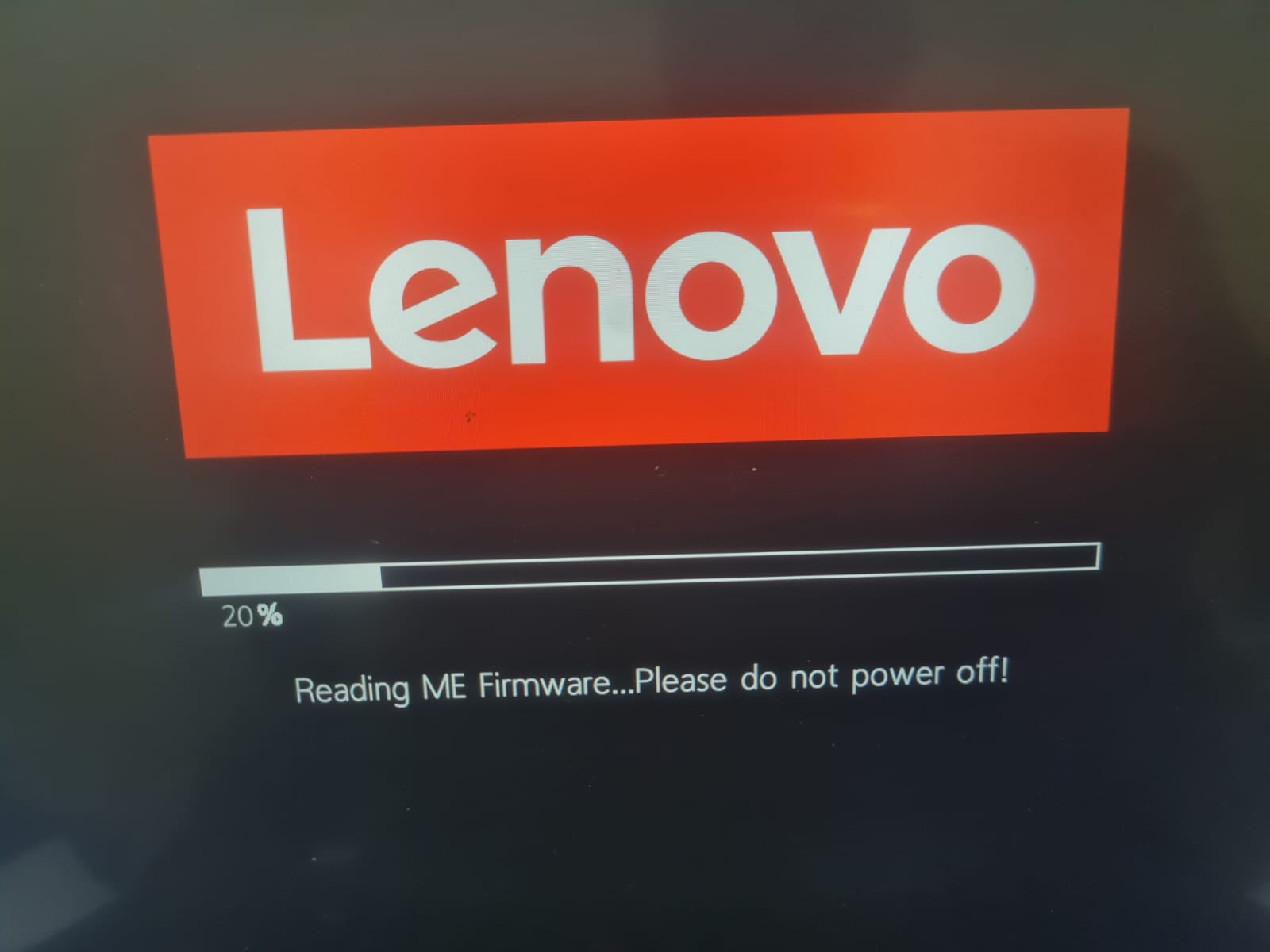

    I have Lenovo with one BIOS chip Winbod 512 Mbit IC (W25Q512JV 3.3V).
    When you switch it ON it delays power_ON and when it is ON it shows Reading ME Firmware. After that, it will say Failed to recover ME.
    Attached is the BIOS BIN.
    Board Number is JT4B1//JX3B0 NM-E091 Rev 1.0
    Please HELP to Clear ME Region Firmware. I tried through software, and when the laptop is ON, it updates nothing. I tried updating BIOS still no LUCK.
    BIOS BACKUP

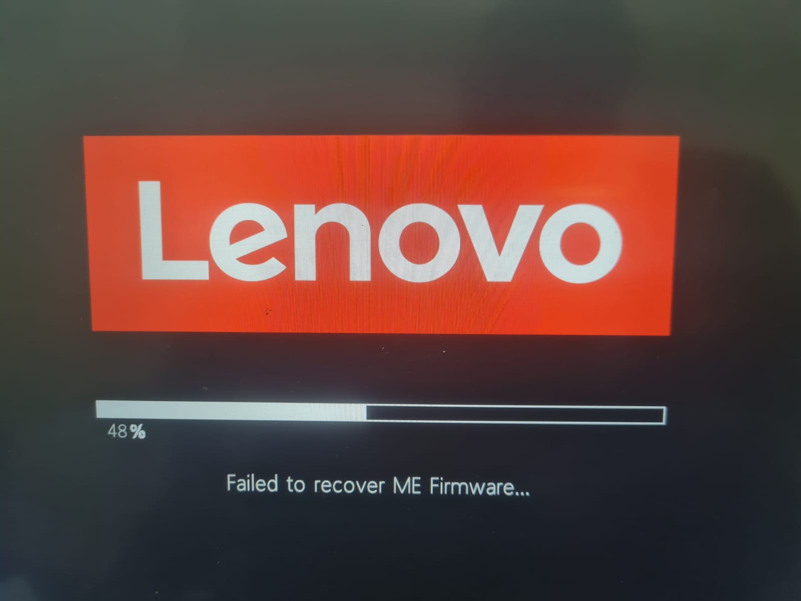

            Here are the results,
            I've reprogrammed the new BIN, and the laptop is just quiet.
            When I reprogram the old BIN it switches ON.
            What could be the problem? I've cleared CMOS still it doesn't switch ON.
