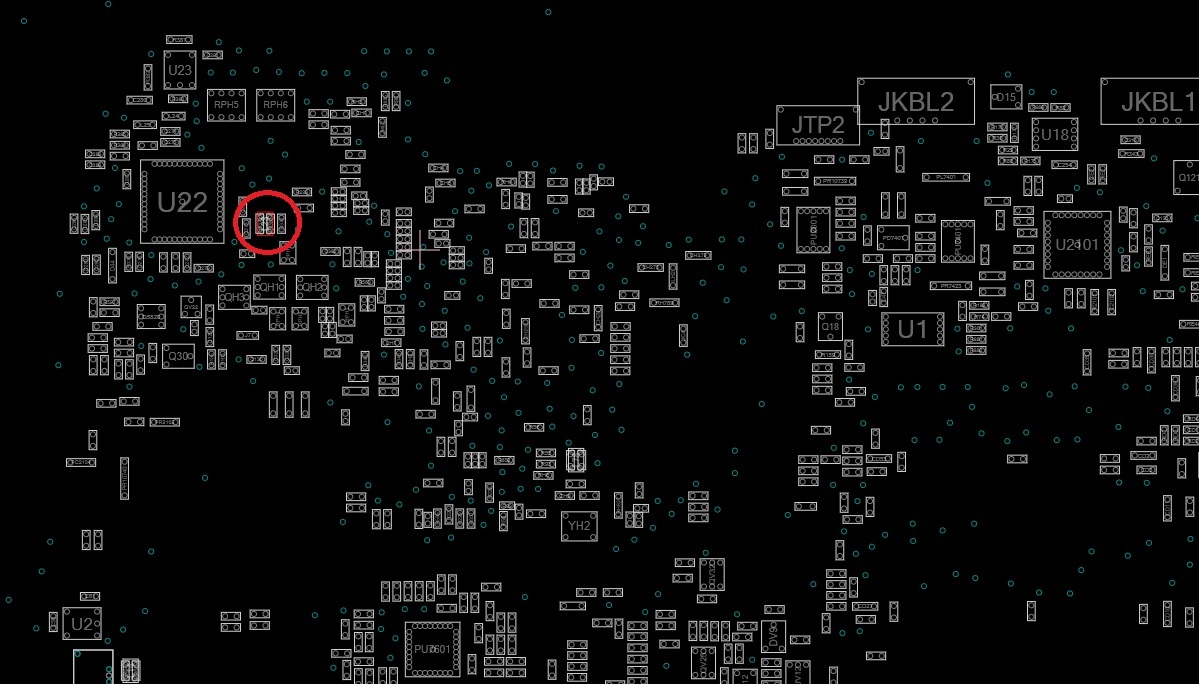

        In my case, the culprit was the L23 throttle
        https://www.youtube.com/watch?v=LKxjKW6YEGA bad signal

          Hello !
          I have the same problem on my Legion, the keyboard does not work anymore. I heard about the famous L23 as well as a jumper to add. What is the solution? thank you!​

            Hello and THANK YOU all for this shared knowledge database that is this forum. especially Brainfart and infino that throw this comment and solve my problem .nice hit😂
            In my lenovo legion y540 the keyboard works sometimes on bios,other times not even can enter in bios. Never worded on windows and appear an Unknown usb device on devices lists (that is a "usb compose device" with failed descriptor on port #0006.hub_#0002" if i'm not mistaken because now it's already fixed and don't appear anymore. The keyboard worked on FN functions aswell ,like light on(FN+ space) or brighness (fn+f5 or f6) but only that on windows.
            if is the case don't bother to replace the keyboard because it's not the keyboard.
            What is the problem? it happens because this L23 coil that do noise and mess the signals(called coil throttle).. you can just use 2 wires to replace the coil, the ideal is replace the coil. it needs microscope to solder and dont mess with the others resistors around
            the coil is on other side of the mainboard(when you open) under the keyboard connector and near an ITE chip.
            Good luck and good repairs
            Click image for larger version  Name:	Sem Título.jpg Views:	0 Size:	201.4 KB ID:	3465675
              Thank you for that information, I was able to fix a keyboard by repairing that specific coil. The signal coming out of it was a mess on the oscilloscope as you stated it would most likely be, so thanks again!
