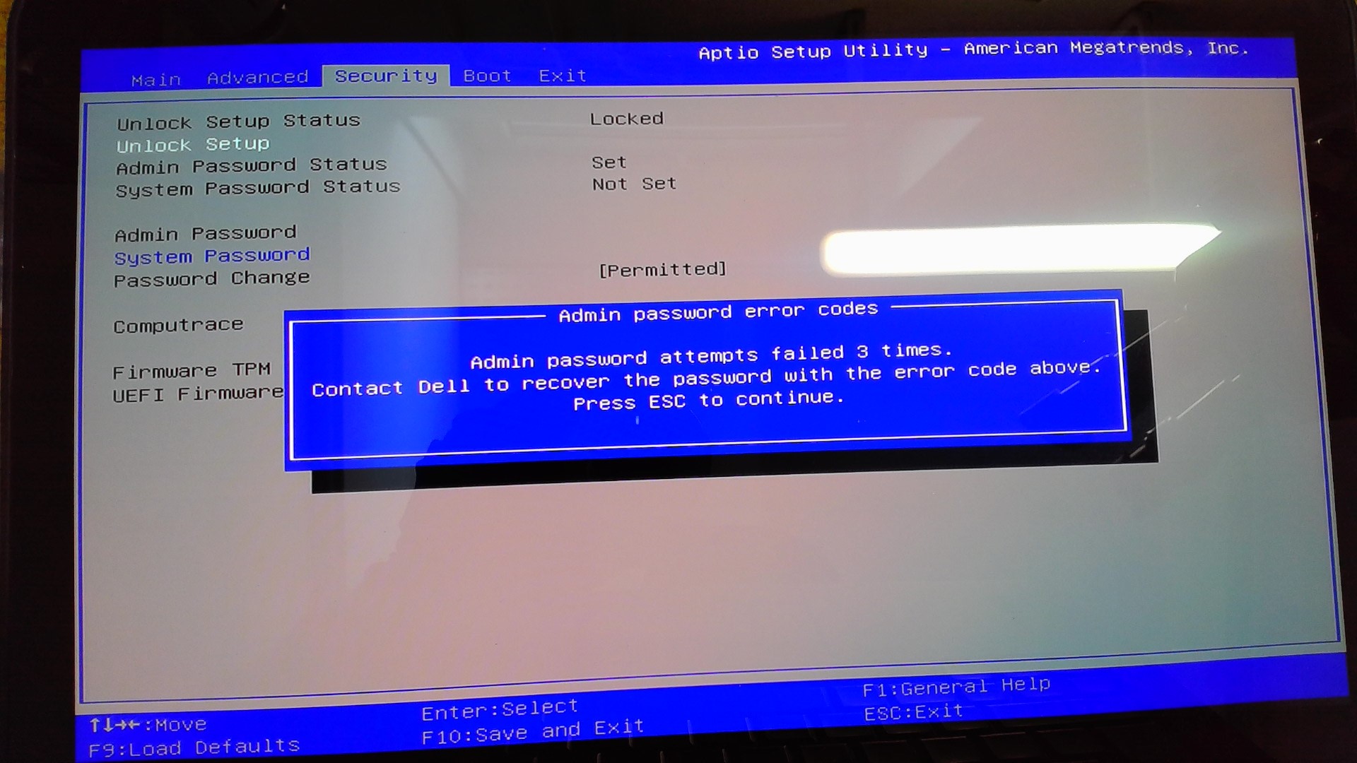

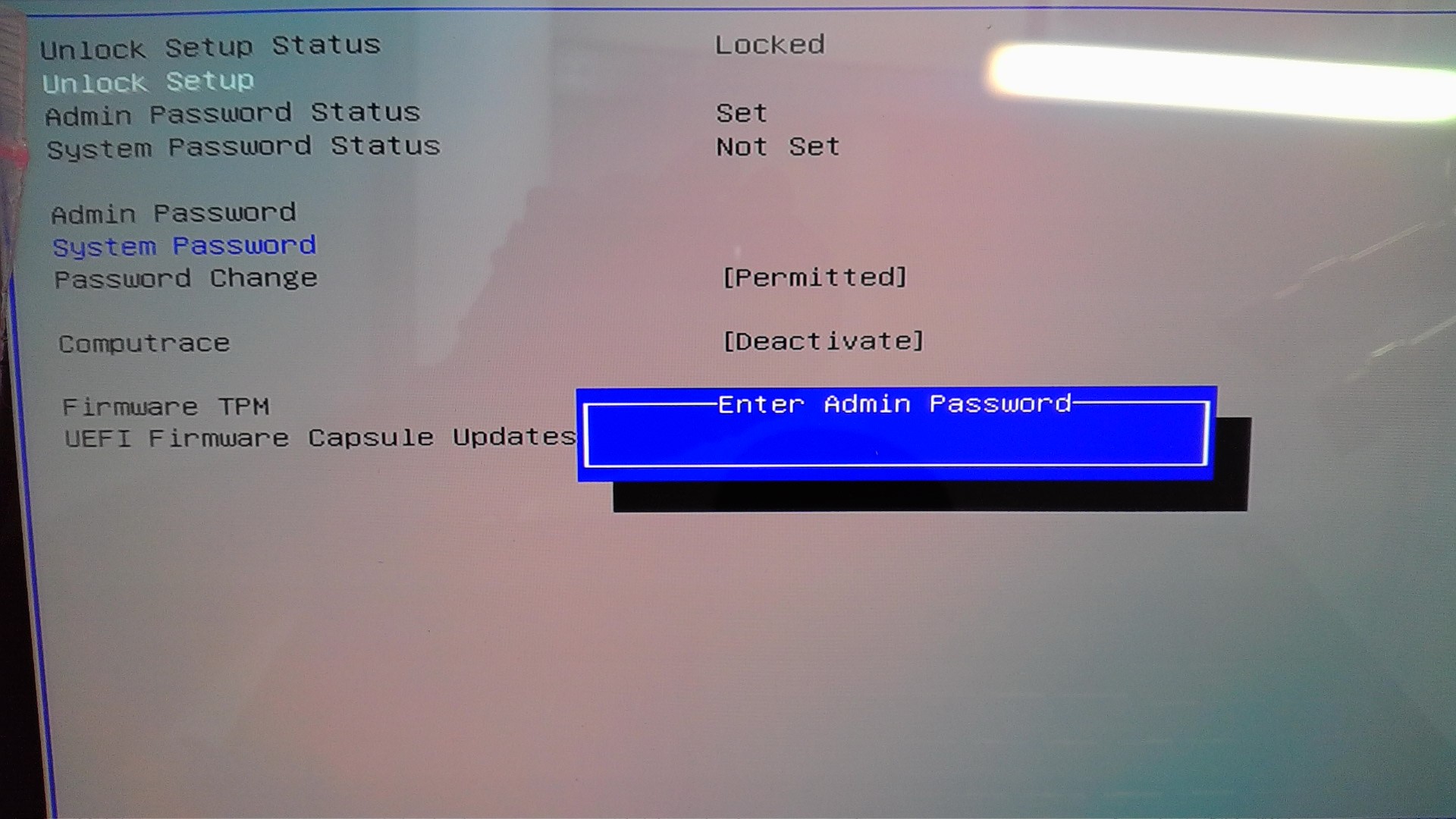

      Admin Password locked
      • Vesko356
        VIP Moderator
        • Aug 2018
        • 4386
        • Bulgaria 🇧🇬
        Re: Alienware 13 r3 Password
        Remove the main and rtc battery and try again.
        BTW what happens if you enter three times incorrect password?
        Become a Badcaps supporter
        Thanks to all supporters.​
        • kicab
          • Aug 2020
          • 10
          • Poland
          RTC disconnected. it's the same efect

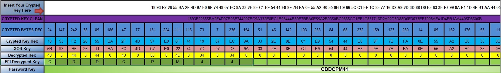

                      For Future reference with the use of an EZP2023+ I was able to locate the Master code and read it out
                      Thanks to the channel of Wrong Chips on Youtube
                      https://www.youtube.com/watch?v=8Me73q1quX0
                      For those that are wondering where is the bios ship it right next to the motherboard controller "W25Q128FV"
                      after that jut go to the bios password and change the password to what ever you want or press enter on an empty field to disable the password
                      This was my first time using a eprom reader am still a newbie but it was all worth it
