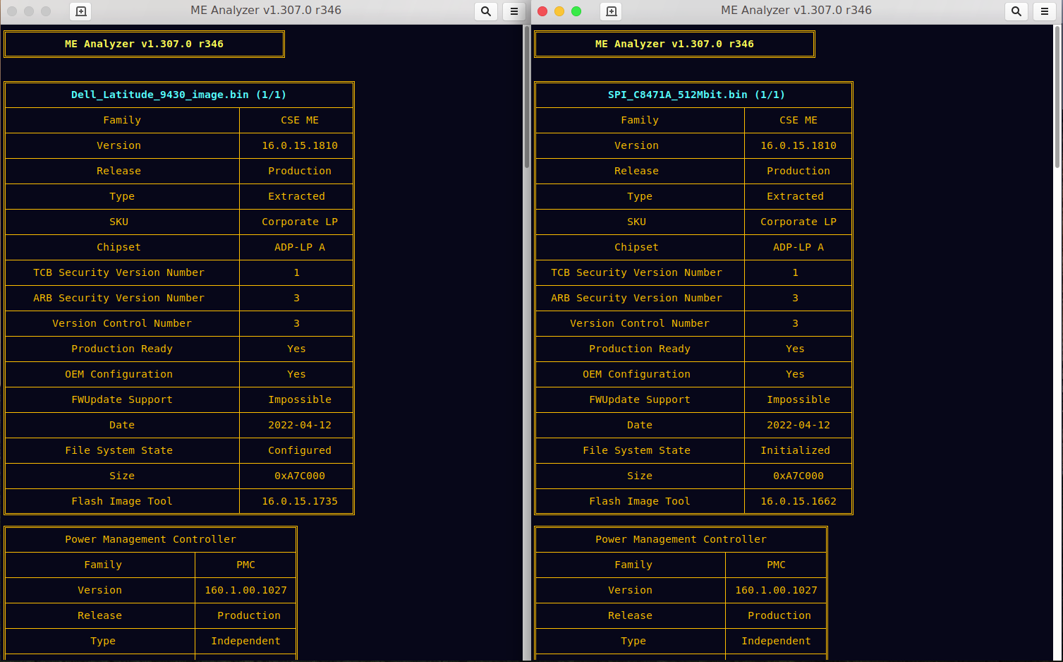

            Hi can some one unlock dell latitude 9430 tag 3K0JSQ3

                Originally posted by Markus1741
                Try this file ...
                it says this boot will take longer than used en the fans stopt wit spining only dell logo on the screen the keyboard also stopt working

                        1st boot, press F2, write service tag, disable Absolute, save (Apply changes), restart. 2nd boot press Alt+F to exit manufacturing mode​.
                          Thank you very much

                                    i have same thing when i remove password with patch it stuck on dell logo i hope some one can help
                                    9430 st:3RNBTT3

                                      It's crazy, I don't understand such a big BIOS. 67.1 MB (67,108,864 bytes)
                                      Try it, maybe it will help.
                                      The notebook is still under warranty until 27.11.2025.

                                        strange thing happen here i wrot your file and giv me screen and freez on dell logo also wrot back orignal file giv me same screen with this boot willl take longer massge
                                        any help please
