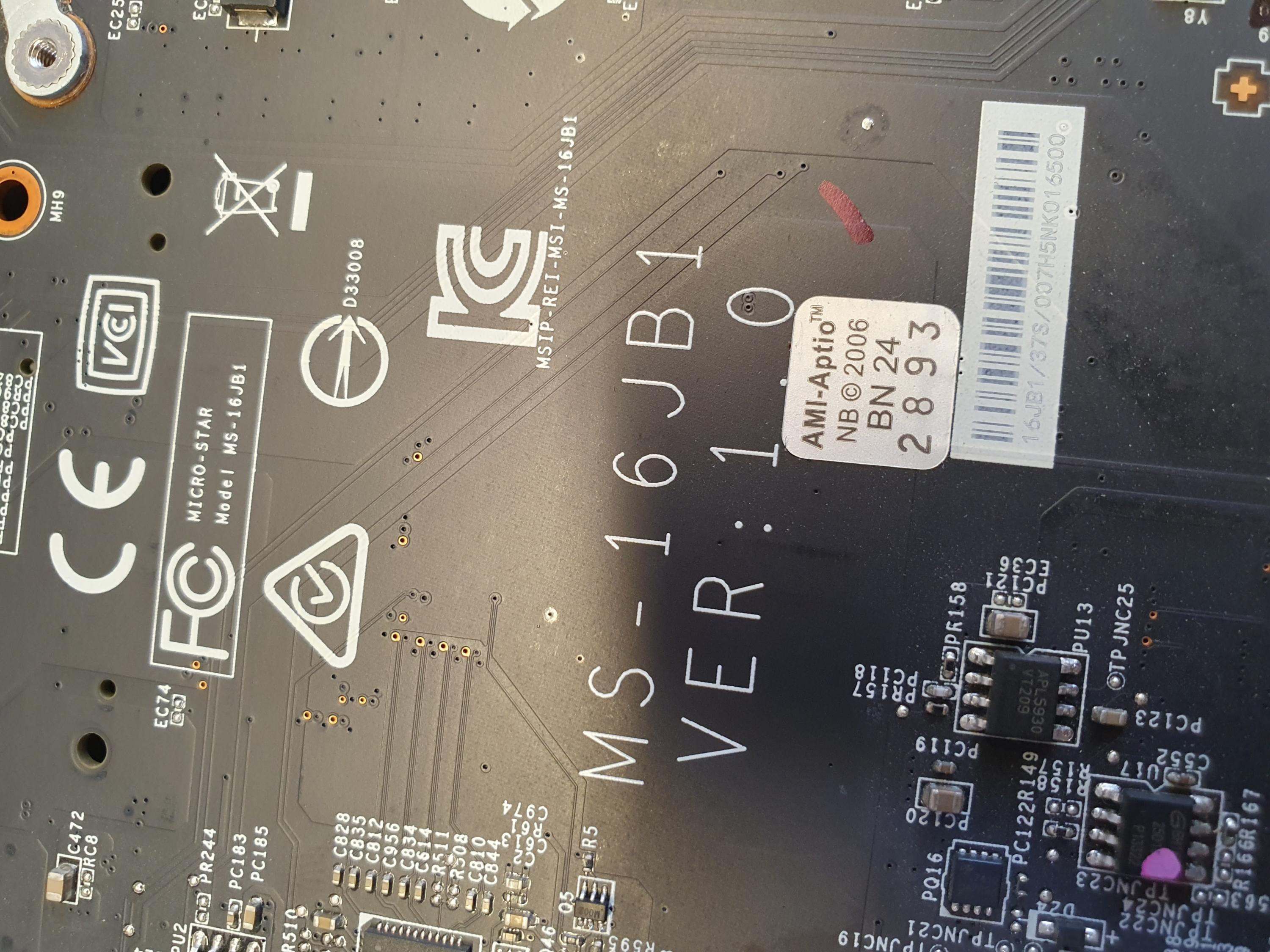

    Hey guys
    Hope someone can help me with a new bios or maybe fix the original bios for MSI GP62MVR 7RF Leopard Pro.
    Bios was updated through windows but something went wront and it ended up with a black screen. It reacts to the power button, keyboard backlight comes on and fan is spinning.
    Board number is MS-16JB1
    Have tried E16JBIMS.31A from MSI website (https://www.msi.com/Laptop/GP62MVR-7...o/support#bios)
    As well as an older bios E16JBIMS.30C I found on the internet. Both with same result. Can’t find anything else out there.
    Hope to get it sorted before Friday.
    Original/corrupted dump is attached.
    Thanks in advance.

    Re: MSI GP62MVR 7RF Leopard Pro Bios
    Are you sure about the model number ,can`t find a 7RF for the MS-16JB1 board.
    Ge62vr 6rf , gp62mvr 6rf ??

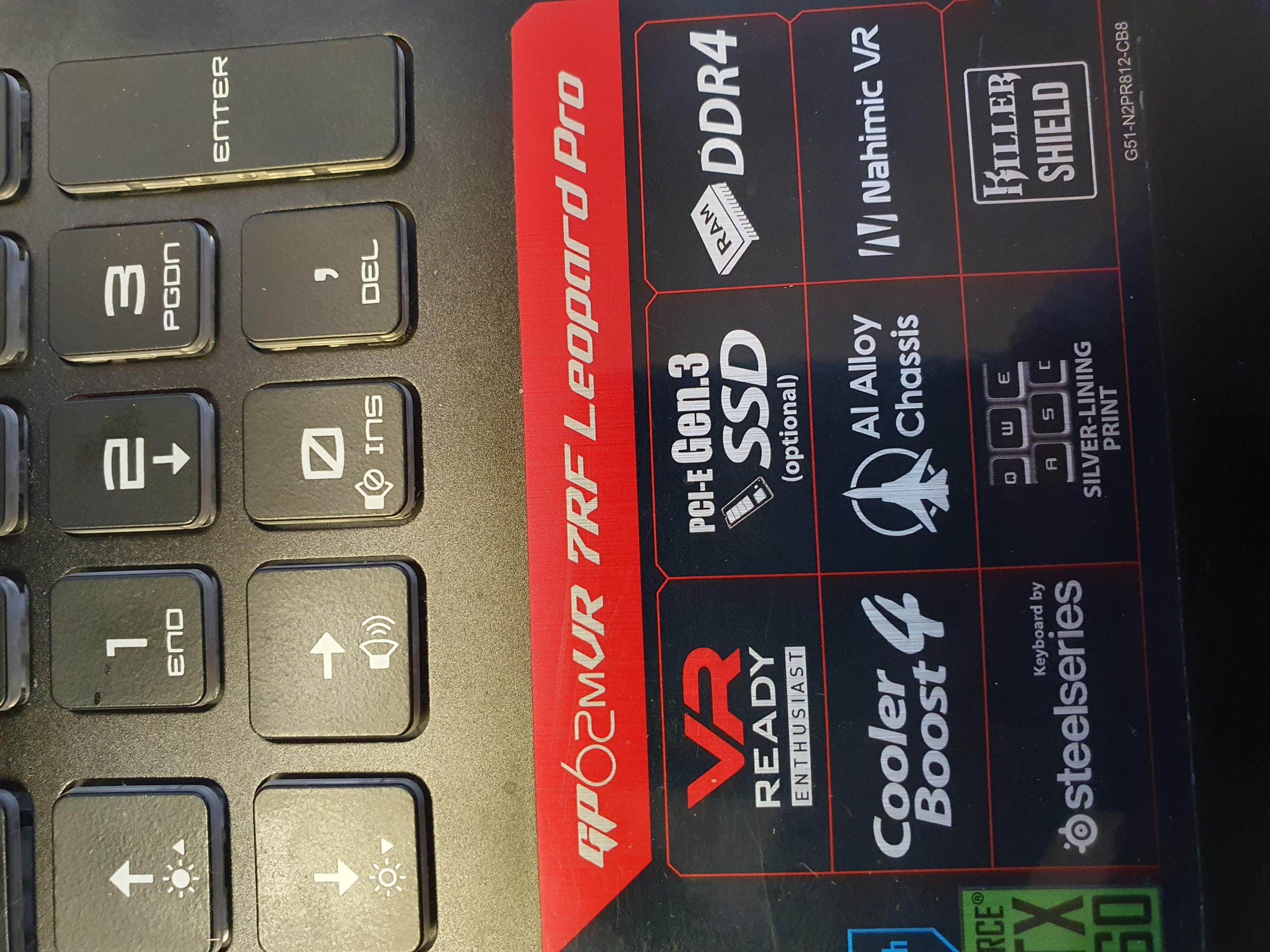

      Thank you for your reply @SMDFlea
      Yes I am positive. Can confirm it's GP62MVR 7RF with board MS-16JB1
      Have attached pictures of the information I have available.
              Thank you for your kind suggestions. I am (kind of) new to laptop repairs but have been microsoldering for 10+ years so am confident with the tools we use. Everything looks perfect under the microscope, this should 99,9% be a bios related issue, it happened when the customer tried to flash bios, it went about 1/3 and ended in this state.
              Now, it was mentioned by SMDFlea that the model number from the front doesn't match the board number. I just spoke with the customer and the computer was bought second hand. Is there any possibility that the board could have been placed in another housing? Is that a thing?
              In case that could potentially happen, do any of you guys have list of models born with the MS-16JB1 board? If so I'll just go nuts and try all the different BIOS' until something works.
                I can see this Model Number "GP62MVR 7RF" in your dump file (DMI area and NVRAM section), so I guess your Model Number is correct.
                Whatever, this official BIOS is for "GP62MVR 6RF", you can try it.
