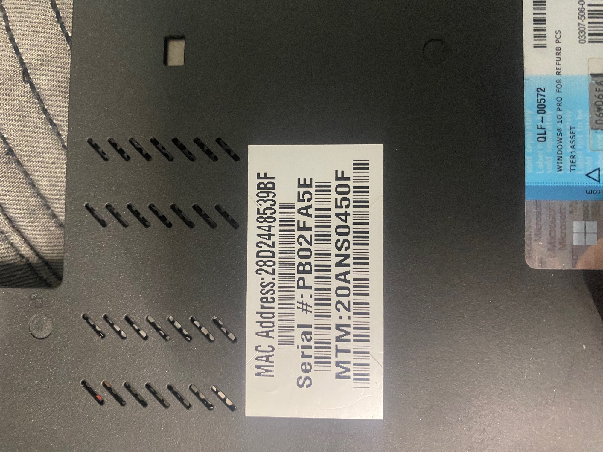

    Hello i need a bios for this model
    Lenovo Thinkpad T440P VILT2 NM-A131 Rev 1.0
    Start but black screen.
    I have the dump.
    • 21889
    Re: ThinkPad T440P
    Serial number ? , model type ? .Please add as much information to your posts as possible
    • hackymc
      • Feb 2017
      • 33
      • Romania
      Re: ThinkPad T440P
      T440p Laptop (ThinkPad) - Type 20AN, and in first post, i added a photo from case.
