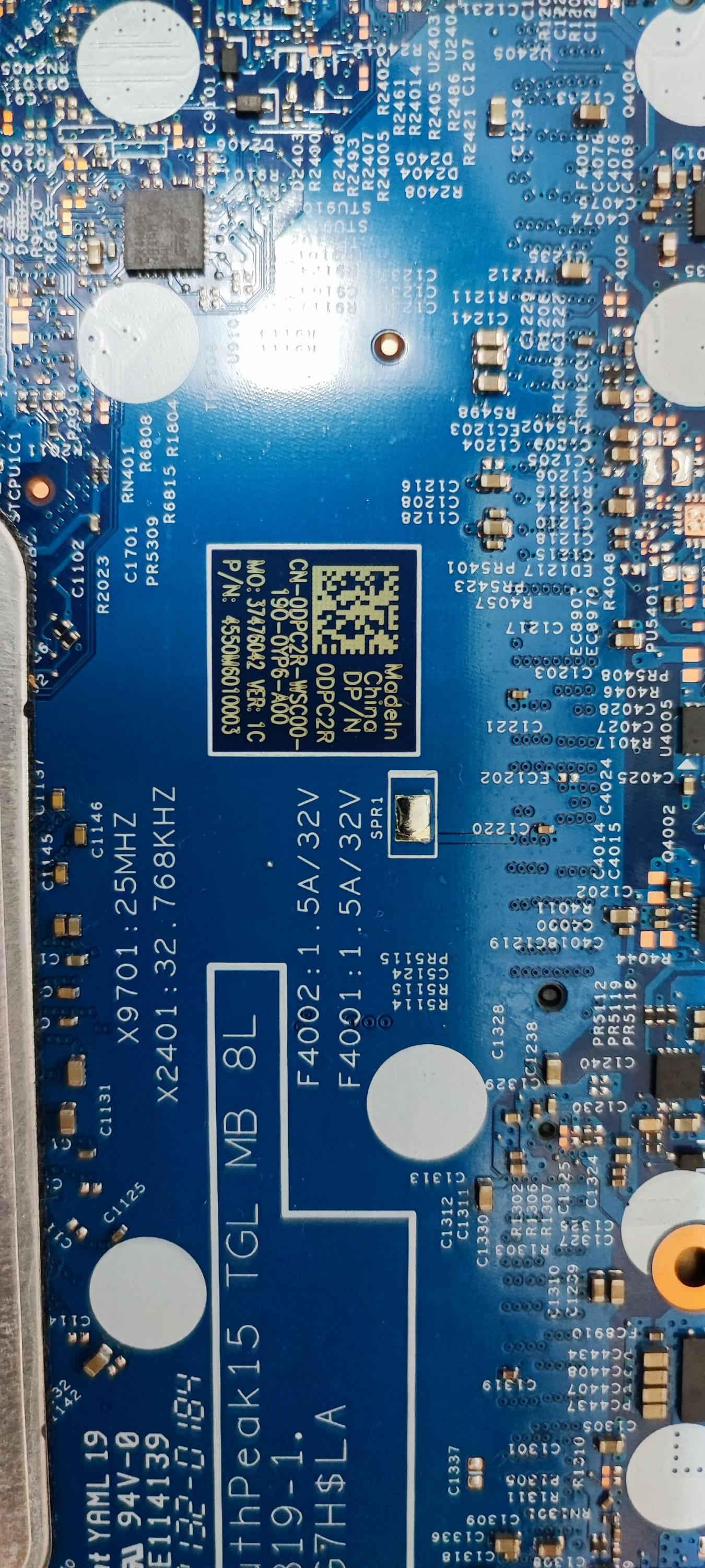

  • darckreign1984
    • 260
    • Romania
    Re: dell latitude 5420 faulty bios - rebuild
    Picture with motherboard.

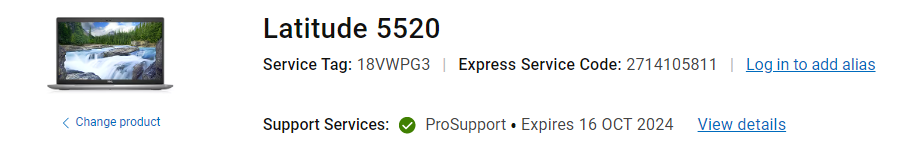

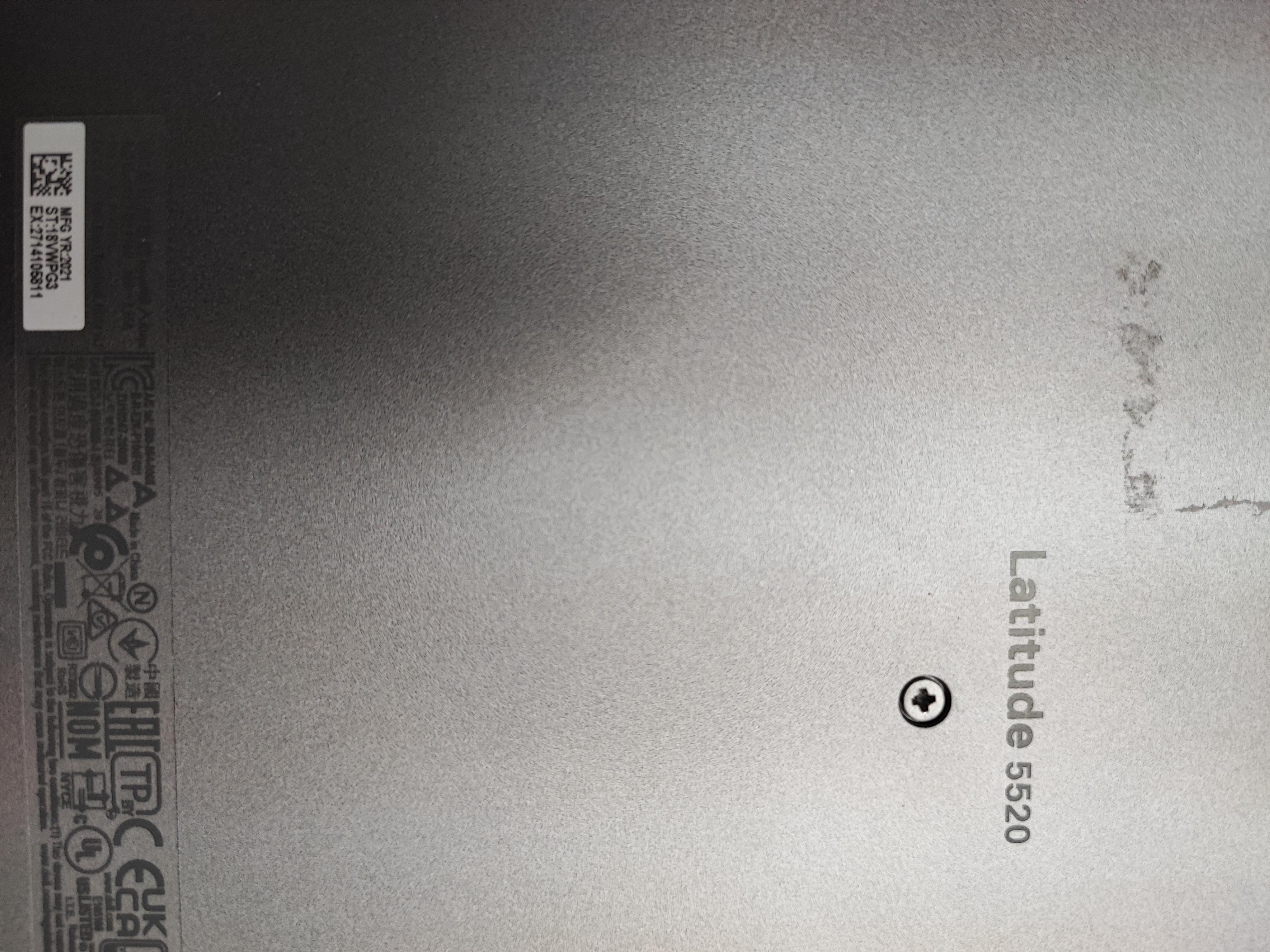

      The Service Tag is referring to 5520 not 5420, is that correct?
      Also the Motherboard Number and the Dump file is for 5520.
      all donations are welcome,
      • darckreign1984
        • 260
        • Romania
        I am sorry. Its dell latitude 5520

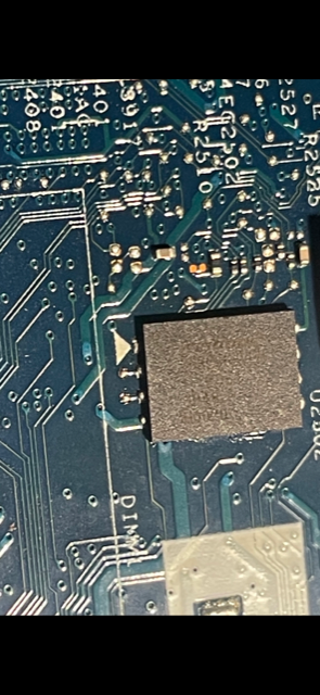

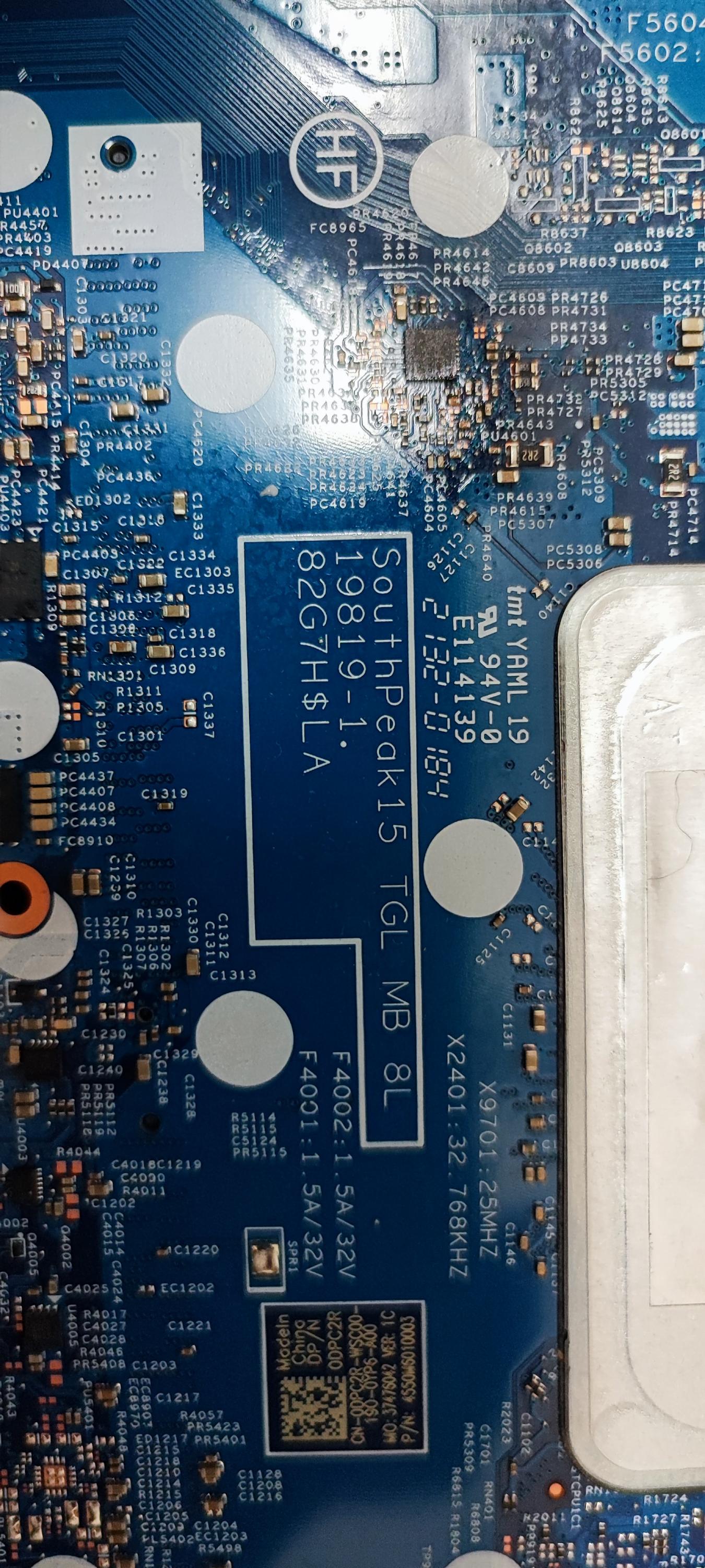

                  I have Dell Latitude 5520
                  Service tag: 29MCY93
                  EX: 4935316071
                  I lost the original bios bin, I used the bin from #5 post, and it boot up to bios, after I input service tag, saved and exit, it boot again and I pressed alt F to disable manufacture mode. after disable I exit the bios setup and unit has no power again. When I unplug and plug back the power cord, just the front while led on for 2 seconds and off and can't power up.
                  If I flash the chip again, same thing will happen.
                  Anyone known what is the issue with it?
                  Thanks for your time.

                        • ricka2021
                          • Jan 2021
                          • 26
                          • usa
                          Originally posted by qayyum786
                          Dont remove bios chip and reprogram again. Just heat bios chip and near by resistor related to bios chip and try to power on
                          bios chip could be malfunction or resistor has only 1 to percent tolerance only
                          Just tried, heat up bios chip and resistor around the bios but still same issue, I attached the close up picture of the bios chip and resistor related to it
