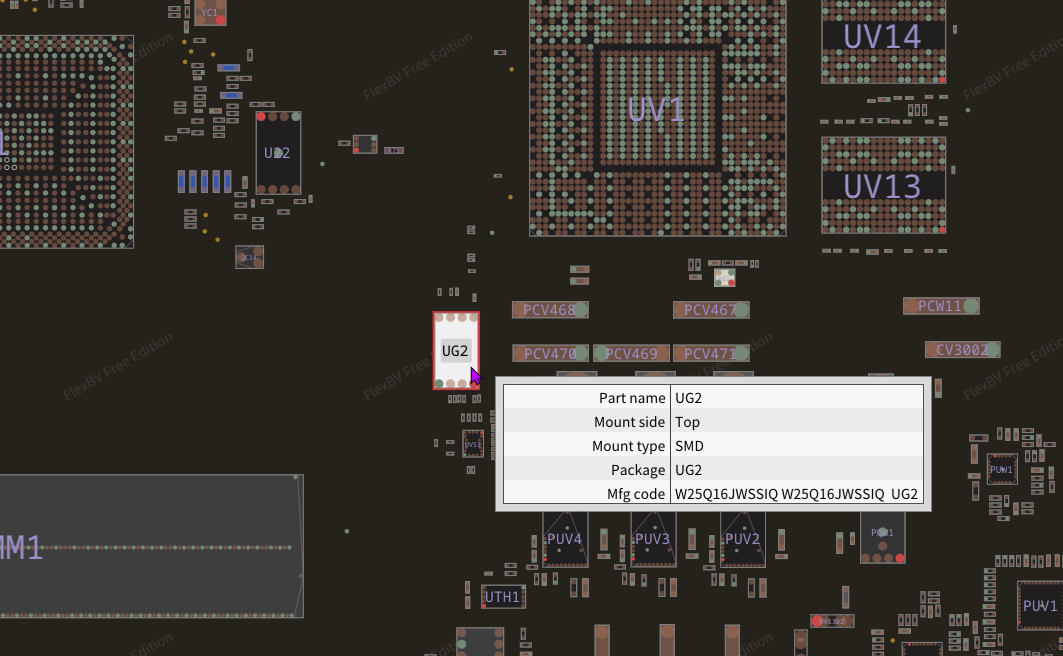

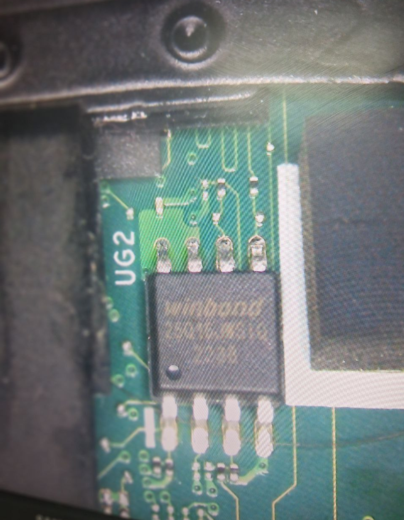

                            Lenovo IdeaPad Gaming 3 15ARH7
                            Motherboard HLG50 LA-M082P
                            2022
                            Ryzen 7 6000 Series
                            BIOS Chip
                            : W25Q128JV – 128 Mbit (16 MB)
                            No display
                            Fan spins for about 10 seconds, then stops
                            Can someone help repair BIOS?

                              Wrong backup, that`s the NVIDIA vBios firmware. Are you sure the part number is W25Q128JV, the vBios is usually on a 2MB chip.

                                Are you refering to this one?

                                  That`s the vBios. The W25Q128JV file you posted above is the 2MB vBios written 8 times to make the file 16MB. So, someone has wriiten the 2MB vBios to the W25Q128JV chip or you chose the chip yourself (reading the W25Q16DW as W25Q128JV) in the programmer and it`s read it 8 times.

                                    Yes seems like I am mistaken this is W25Q16JWSSIQ W25Q16JWSSIQ
                                    and I got the wrong chipset, this is the nvidia gpu... I now found the BIOS
                                    • Yela
                                      • Jul 2025
                                      • 4
                                      sorry i just got a new programer my programmer was making a problem. now i got the file correctly readed, if you can take a look at this i would appriciate it!
