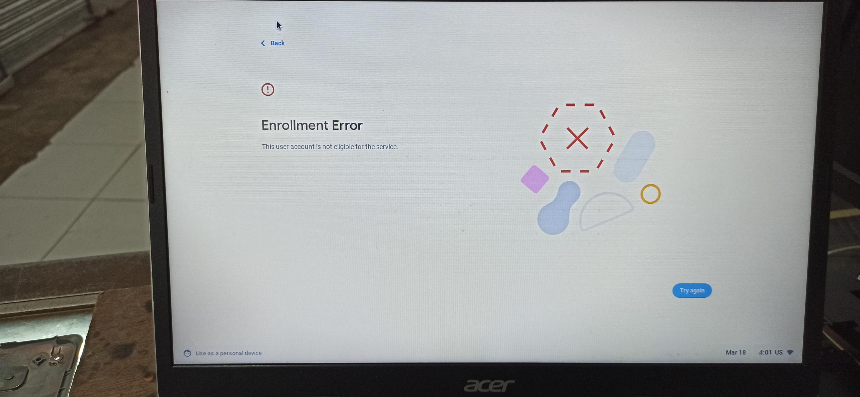

    Acer CB315-3H Chromebook lock

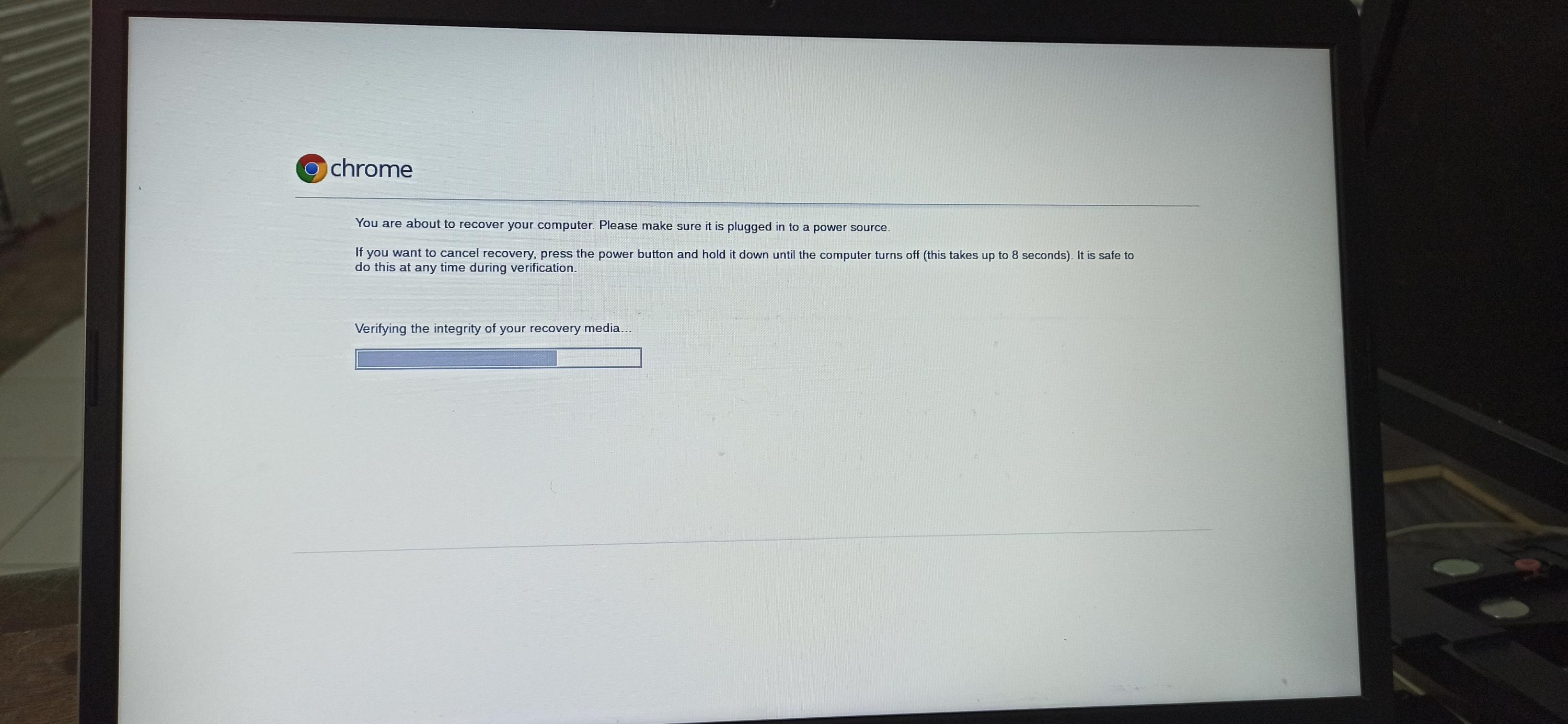

    Master help me to unlock my file
    company bypass & enable developer : TIA

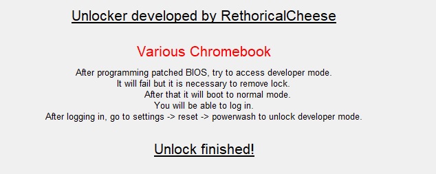

    Re: Acer CB315-3H Chromebook lock
    See instructions at picture
    • smallvhin
      • Jul 2015
      • 182
      • philippines
      thanks for immediate reply master.
      same problem master.
      • lapfix
        • Mar 2020
        • 2730
        • my workshop
        Did you read / follow step to do at the picture
        • smallvhin
          • Jul 2015
          • 182
          • philippines
          I follow the step master. no luck

            reinstall from USB stick created with Chromebook Recovery utility for your model.

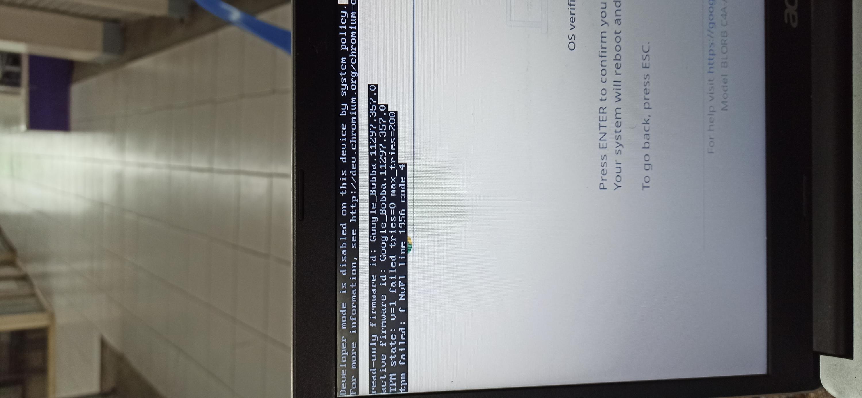

            • smallvhin
              • Jul 2015
              • 182
              • philippines
              I created. exact model only is cb315 only.
              enterprise login master.
              clear bios master.. TIA

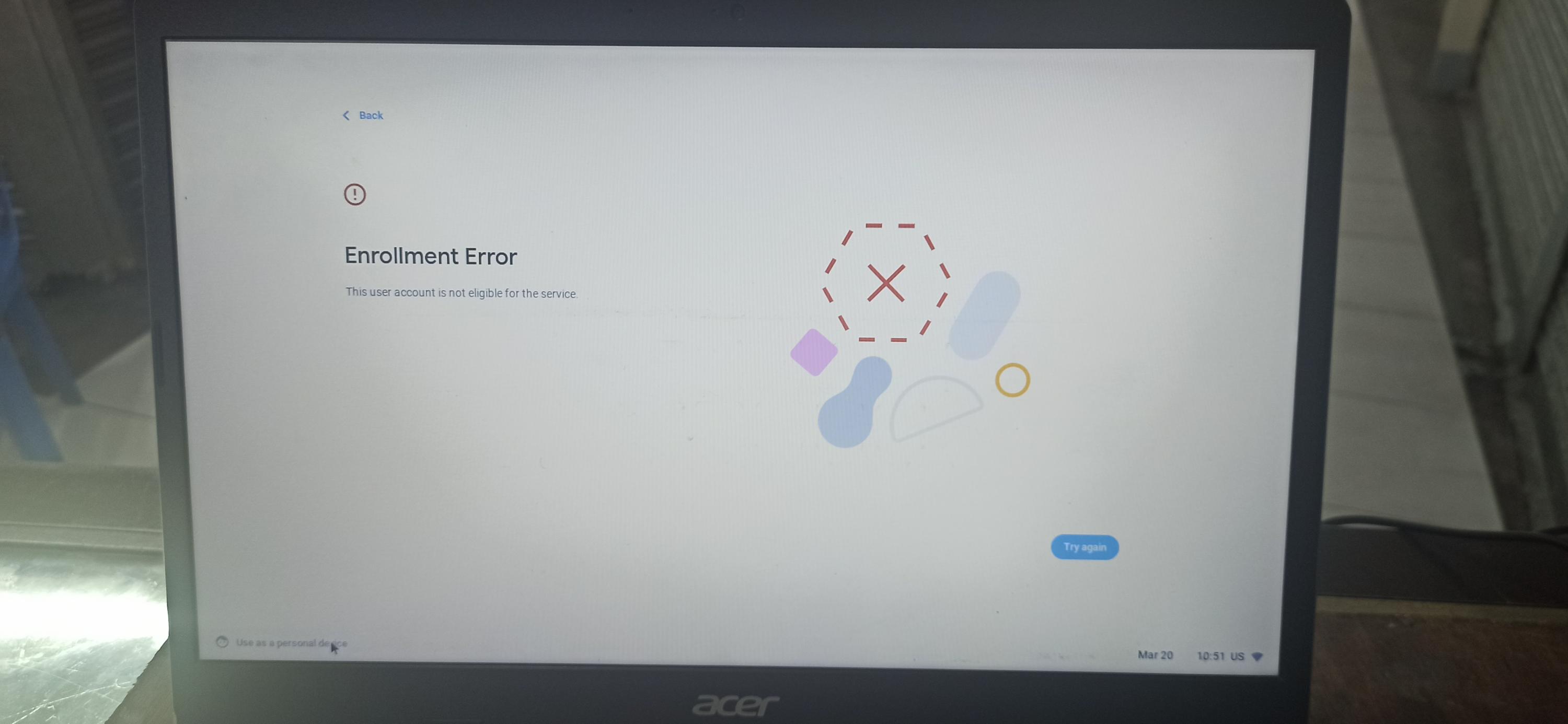

              • smallvhin
                • Jul 2015
                • 182
                • philippines
                remove enrollment login password / enable developer mode master pls.. TIA
                • volinakis
                  • Jan 2021
                  • 2734
                  • N/A
                  lapfix's file is ok, check if you didn't write by mistake the original file instead of lapfix's file.
                  • smallvhin
                    • Jul 2015
                    • 182
                    • philippines
                    no exactly model of cb315-3h in chrome utility.
                    I'm using cb315 only can't access my Google account to enterprise. no luck to "use as a personal device.
                    developer mode is disabled.

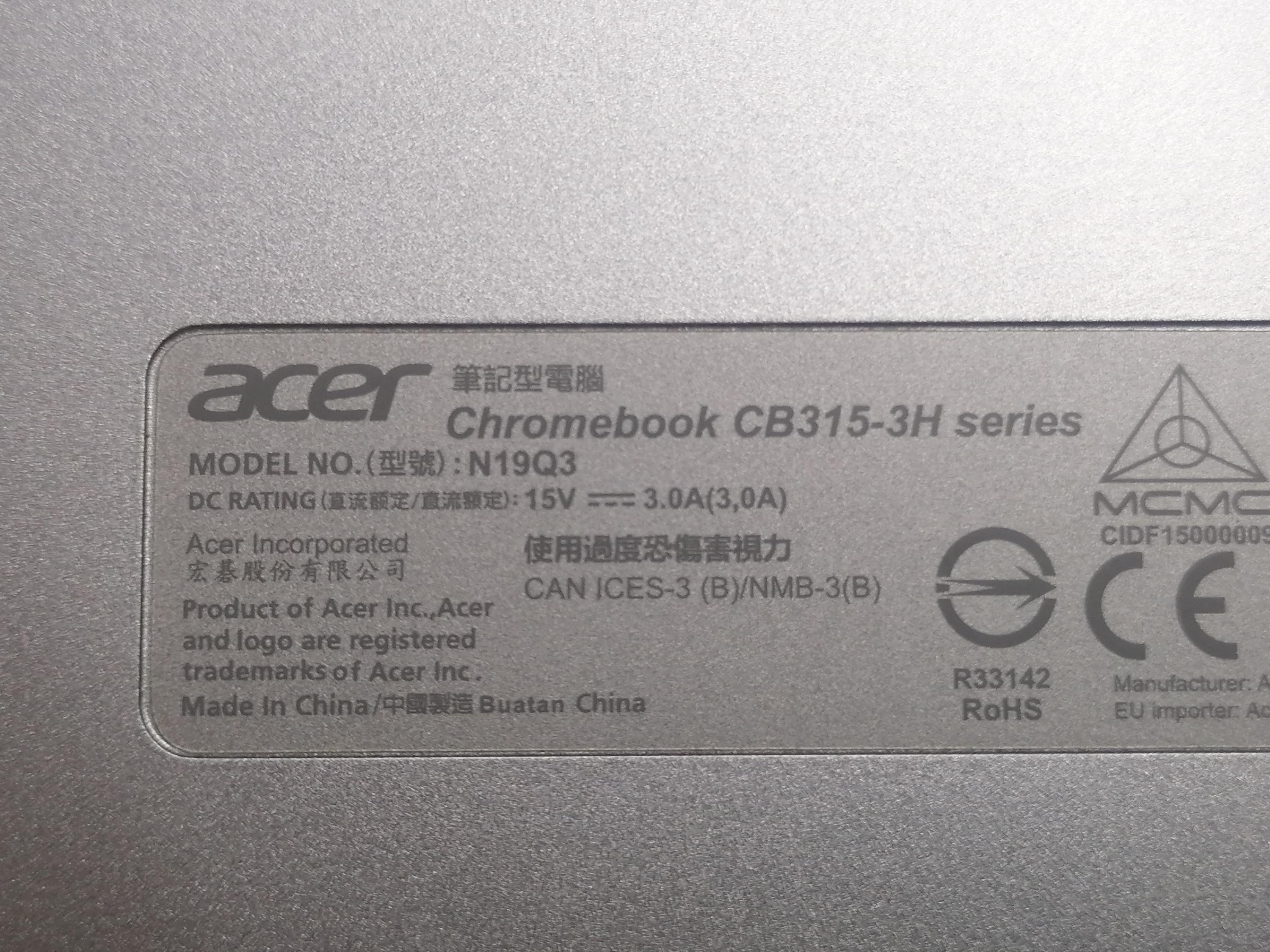

                          Acer cb315-3h-c4c0 bios need
                          I have here acer cb315-3h-c4c0 model n19q3 lock by administrator this one s in enterprise eenroolment i tried powerwash nothing happens so i decided to flash bios i found something here but it doesn't work. blinking display hope someone can help me this one. here is my bios file

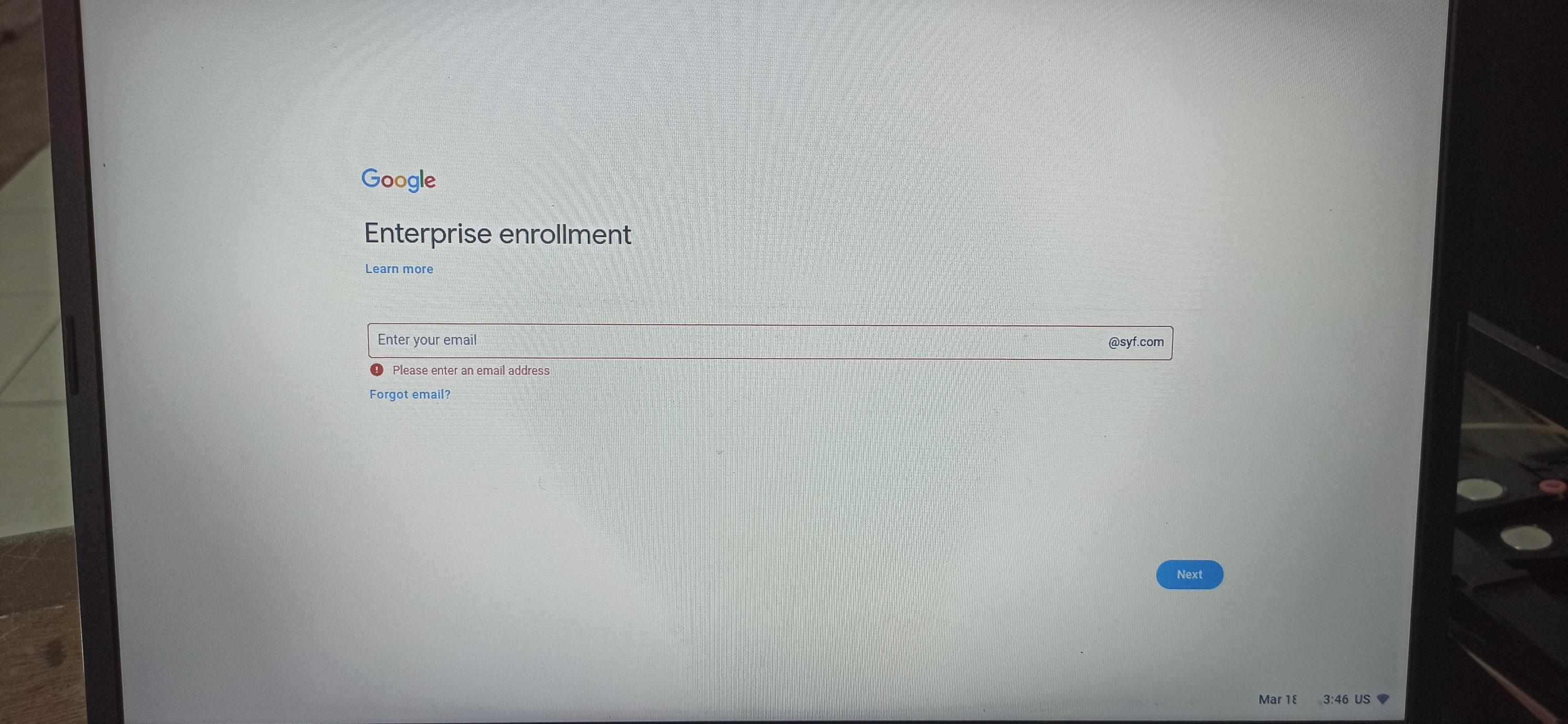

                                    Acer Chromebook N19Q3 Enterprise Lock
                                    DA0ZBCMB6D1 REV: D BIOS Enterprise lock. kinda like frp lock.
                                    I Already tried powerwash, and install new os. email lock still exist.

                                      • rex98
                                        • Feb 2023
                                        • 1278
                                        • Mandaue CEBU, Philippines
                                        Re: Acer Chromebook N19Q3 Enterprise Lock
                                        Originally posted by osman68i
                                        unlocked your original bios.
                                        enrollment ok
                                        serial ok
                                        first start you must enable the developer mode.
                                        Turn off your ChromeBook
                                        Holding Esc + Refresh (F3) buttons while pressing Power button. Then release Power Button.
                                        Your screen will display Recovery screen. Here, press Ctrl+D to turn on Developer mode. Then wait for couple of minutes.
                                        the enterprise enrollment is still in there. i didn't run the old os in fist boot. i tried the esc+refresh then crtl+d in first boot but it says dev mode read only blocked. i also flashed again and didn't run the old os and install new os it still doesn't work.
