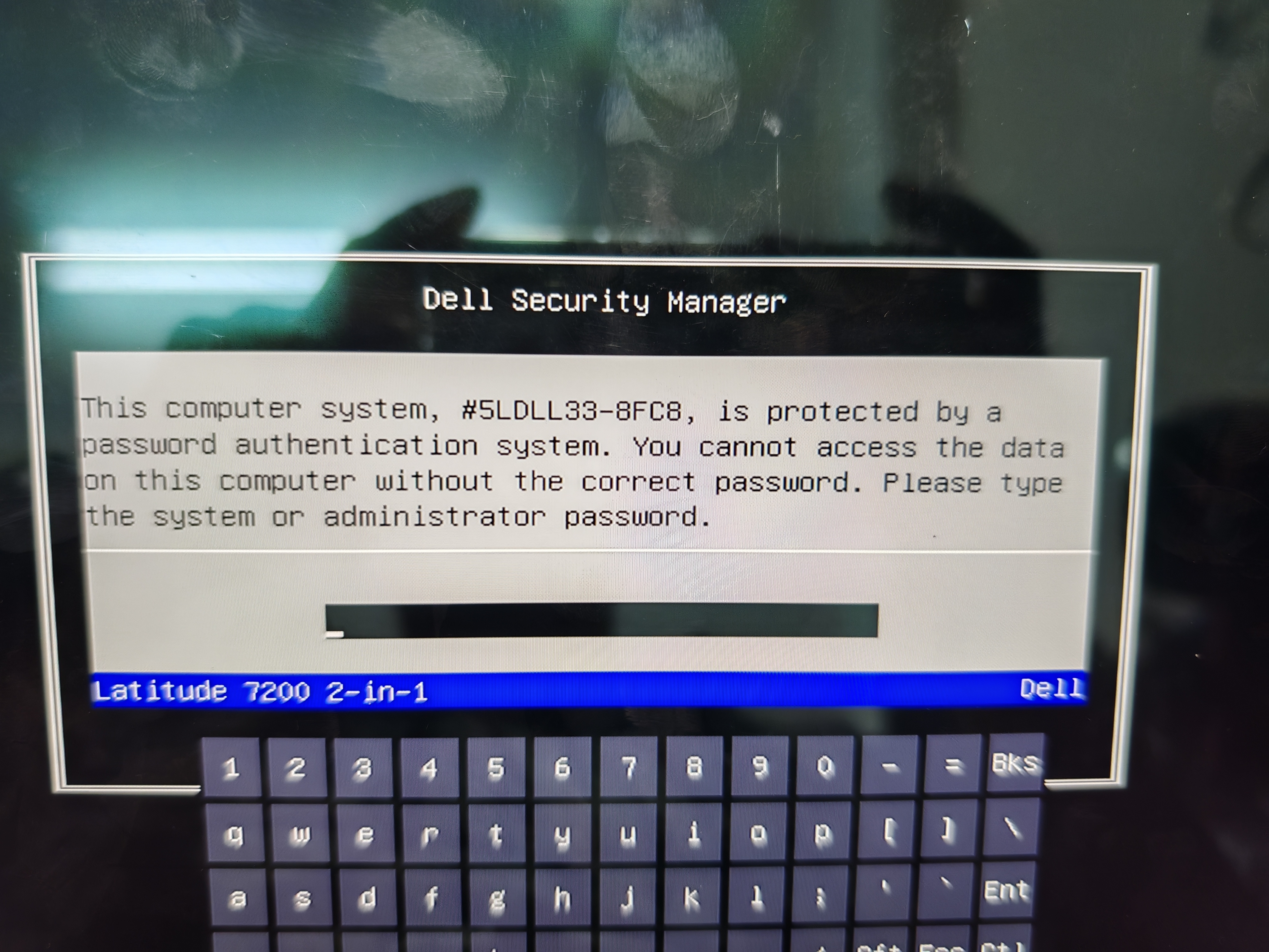

                            #33
                            helo
                            i have a second dell 7200 2in1, that have admin password.
                            I buy this online.
                            can you help me remove it?
                            thnaks
                            ST - 5LDLL33
                            EX - 12176543487
                            i uploaded the bios backup
                            thanks
                            I have tried to change the 3 adress , from my previsious bios (i fallow the solution received), without succes.​

                              #34
                              Hello, try this unlocked file ....
                              • darckreign1984
                                • 260
                                • Romania
                                #35
                                helo, i tested the file, buth the laptop did no start anymore

                                  #36
                                  Flash the original file again to see if it works ?
                                  • darckreign1984
                                    • 260
                                    • Romania
                                    #37
                                    I flashed the bios back. Laptop start.
                                    The chip it's desoldered from motherboard and flashed on tl866II plus
                                    • hoaca388
                                      Badcaps
                                      • Jan 2022
                                      • 11643
                                      #38
                                      This time flashing the unlock file to it should work.
                                      • darckreign1984
                                        • 260
                                        • Romania
                                        #39
                                        so i have to flash again the unlocked bios from Markus1741​?
                                        • hoaca388
                                          Badcaps
                                          • Jan 2022
                                          • 11643
                                          #40
                                          Yes !
