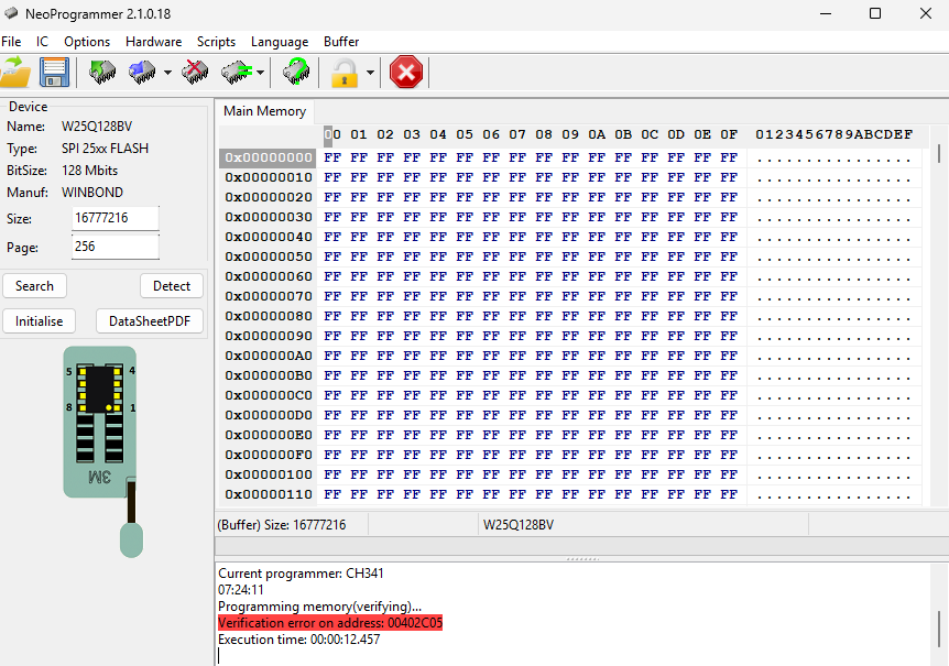

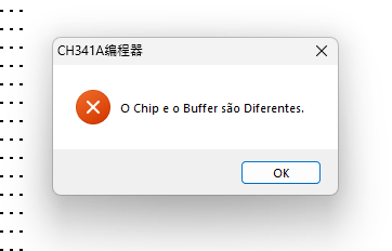

    I am having trouble to program the 16MB (128) chip, every time I get this error when verifying.
    I am programim the chip directly on the board ( is not un solded).
      The bios chip must be unsoldered from the board before writing or reading..
      do not use the clip, you may have errors..if you do not have anything to unsolder it with,
      solder wires between the programmer and the bios chip..​

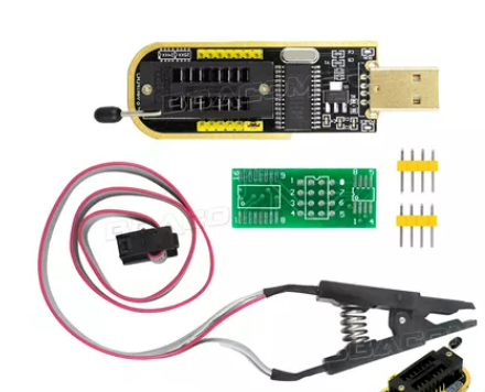

        I have sucessfully writen the 64bits chip 8MB, but the 128bits 16MB gives the error.
        I am using the CH314a with the clip (image attached), isn't this the same as soldering wires to the programmer?
        I was reading that this may happen because of a 3.3V and 5V bug with this programmer.
        Now I have sucessfully written the 16MB using NeoProgrammer, but my notebook is still with 12 flashes on LED and turn off with no video.
        Can you show an image of how can I solder wires between programmer and bios? I am afraid of unsoldering and not been able to solder again, I can solder big wires but this are too small for my solding iron.
