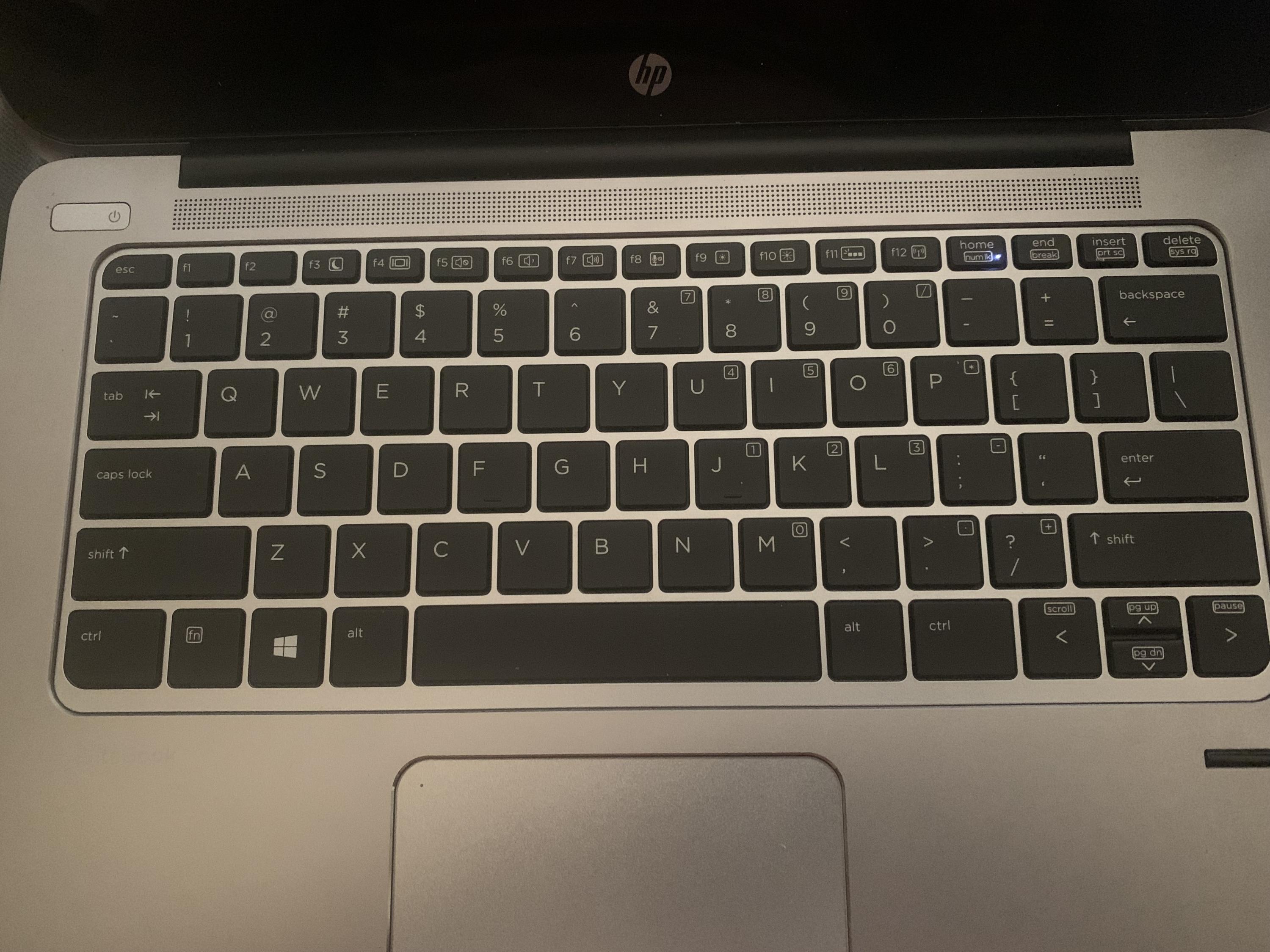

        hp elitebook folio 1020 G2 bios and ec needed
        Hi guys , im looking for a working bios and ec for
        Hp elitebook folio 1020 G2
        Motherboard : 6050A2736001-mb-ax4
        • peste
          • Dec 2016
          • 13924

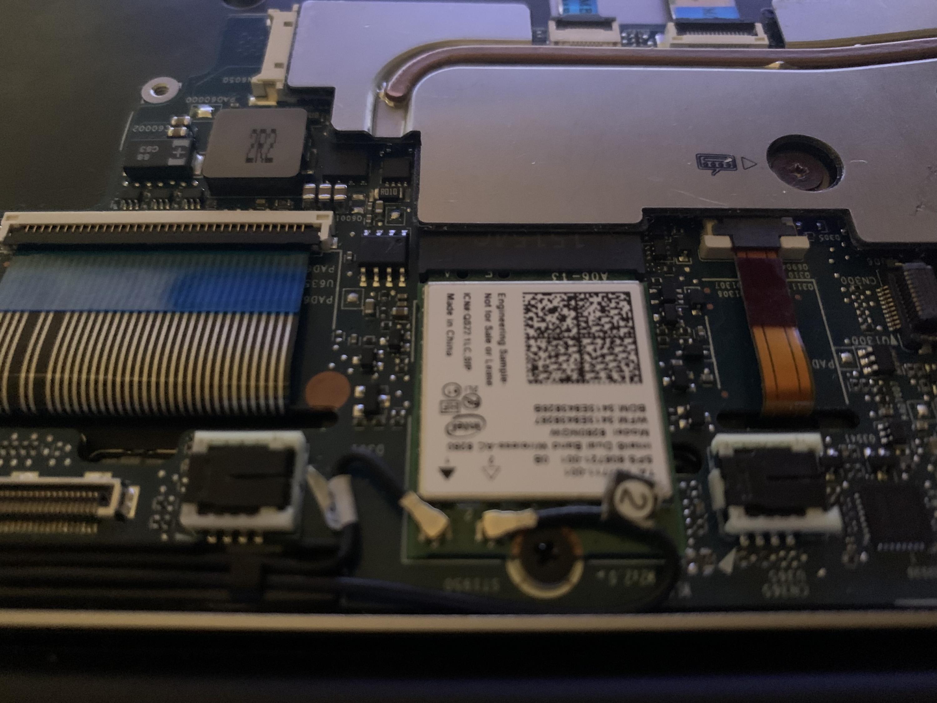

            Re: hp elitebook folio 1020 G2 bios and ec needed
            hi Peste thanks for your answer
            The bios was updated with a wrong update N86 instead of P90 which is the right update .
            i cleaned the me region and i even extracted the ec file from the hp update file but the laptop still start with a black screen and 2 long beeps and 2 short.
            Here are the original corrupted dumps
                ok Peste i just changed the 16mb but the laptop is not powering on, nothing happen when you press the power button only home key led is on.
                    the bios and ec chip are not soldered ... when i put back the origine bios and ec the laptop power on with the beeps as i told before.
                    the bios chip was programmed successfully without errors
                        hi peste , i just changed the both bios , the laptop power on but as before no display and caps lock blinking 5 times with 2 long and 2 short beeps. Thanks for your helps i appreciate it.
