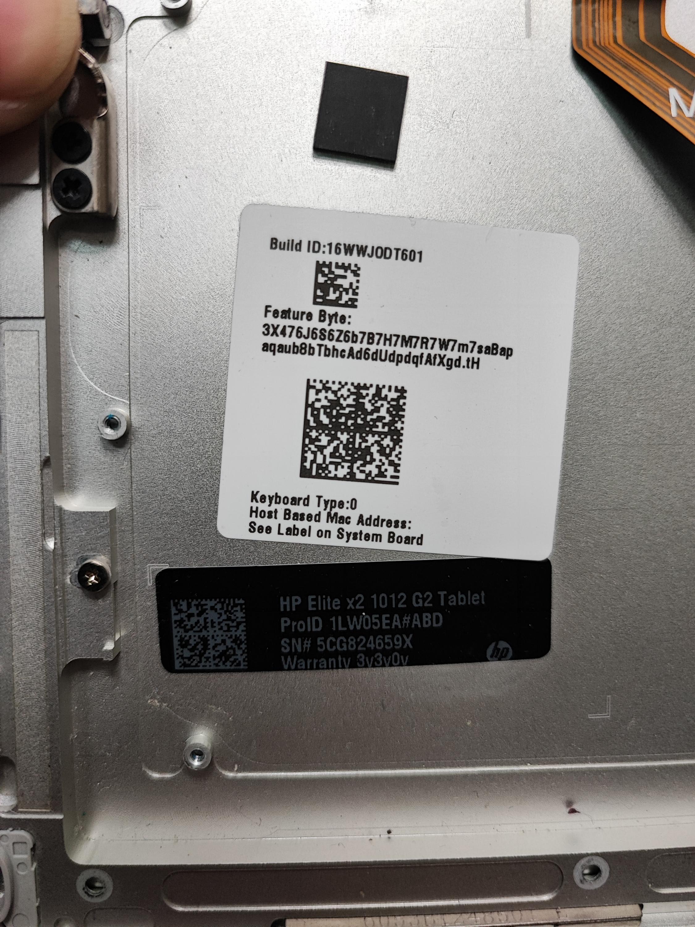

      i atached all info that i find. in first post.
      prodid 1LW05EA#ABD
      what do you mean base model?

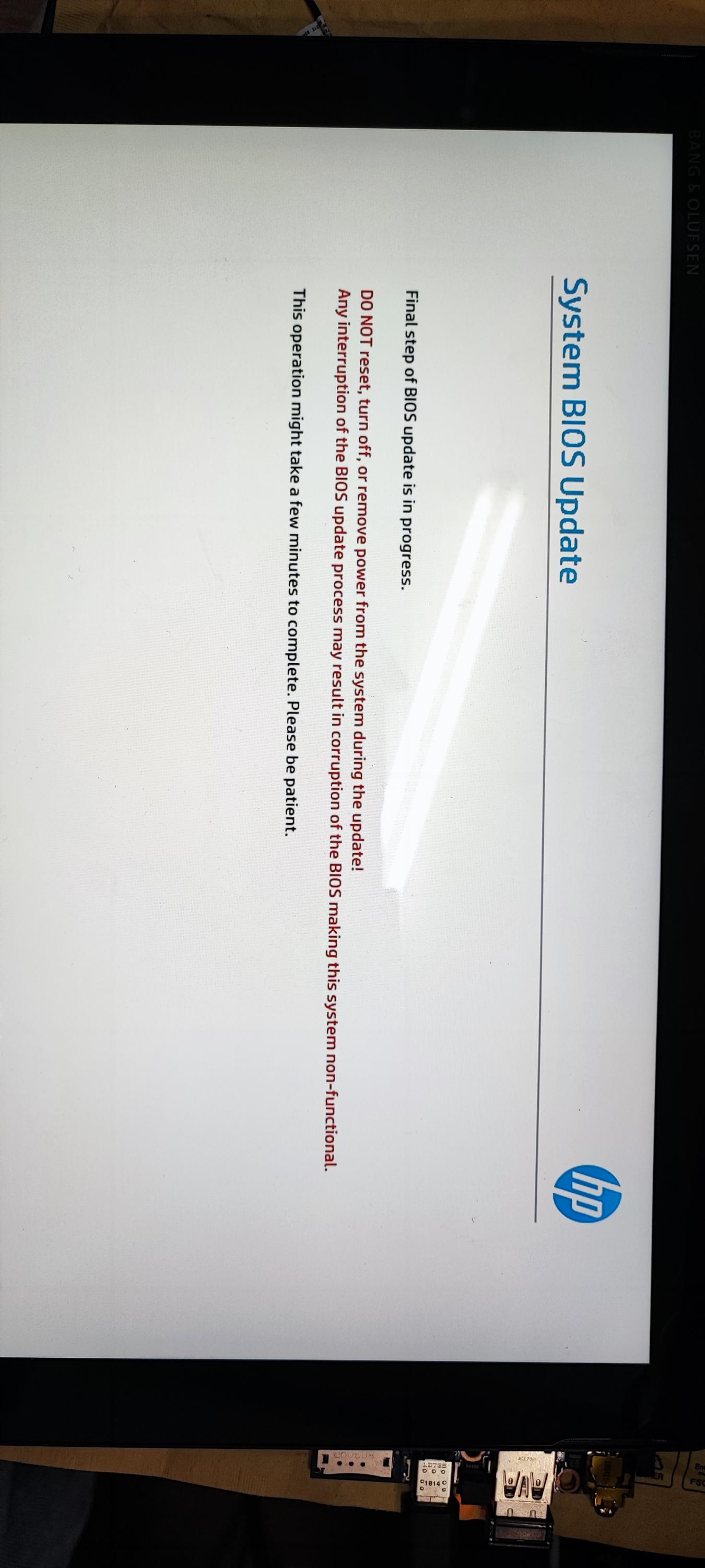

        I tested last posted bios.
        Did not work
        Some blink and I believe it a bootloop, and nothing on screen.
        Fan in this bootloop it's try to start and rotate 5 degree.

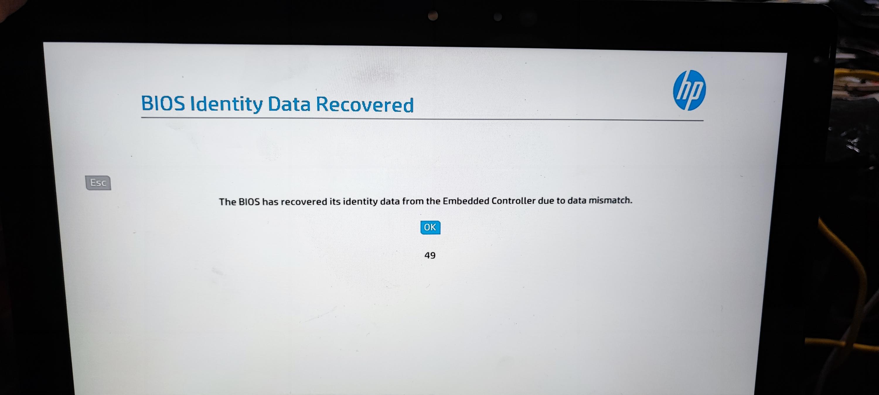

          Press OK until the counter goes from 49 to 0
          • darckreign1984
            • 260
            • Romania
            Re: hp elite x2 1012 g2 tablet wrong bios
            ok on touch screen?
            if i press enter laptop restart - and did not start again screen
            if i press escape same response.
            if i flash bios provided from you i describe symptoms a post before
              the picture atached its for the bios posted in first post.
              the bios posted from you did not show nothing on screen

                i press ok - now with a mouse - the tablet show hp logo like 5 seconds, then restarted, and same simptom, like a bootloop, and nothing on screen anymore.

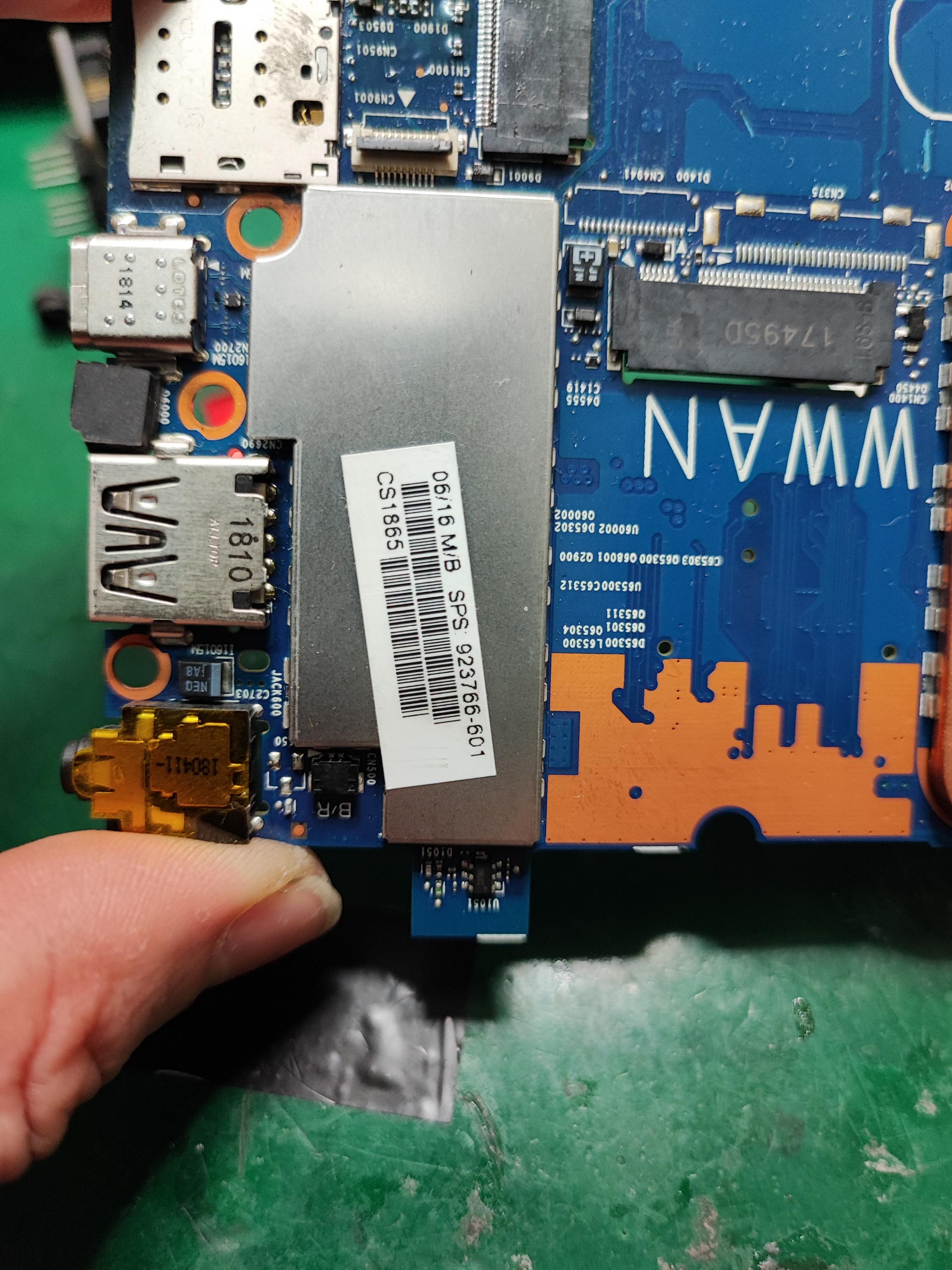

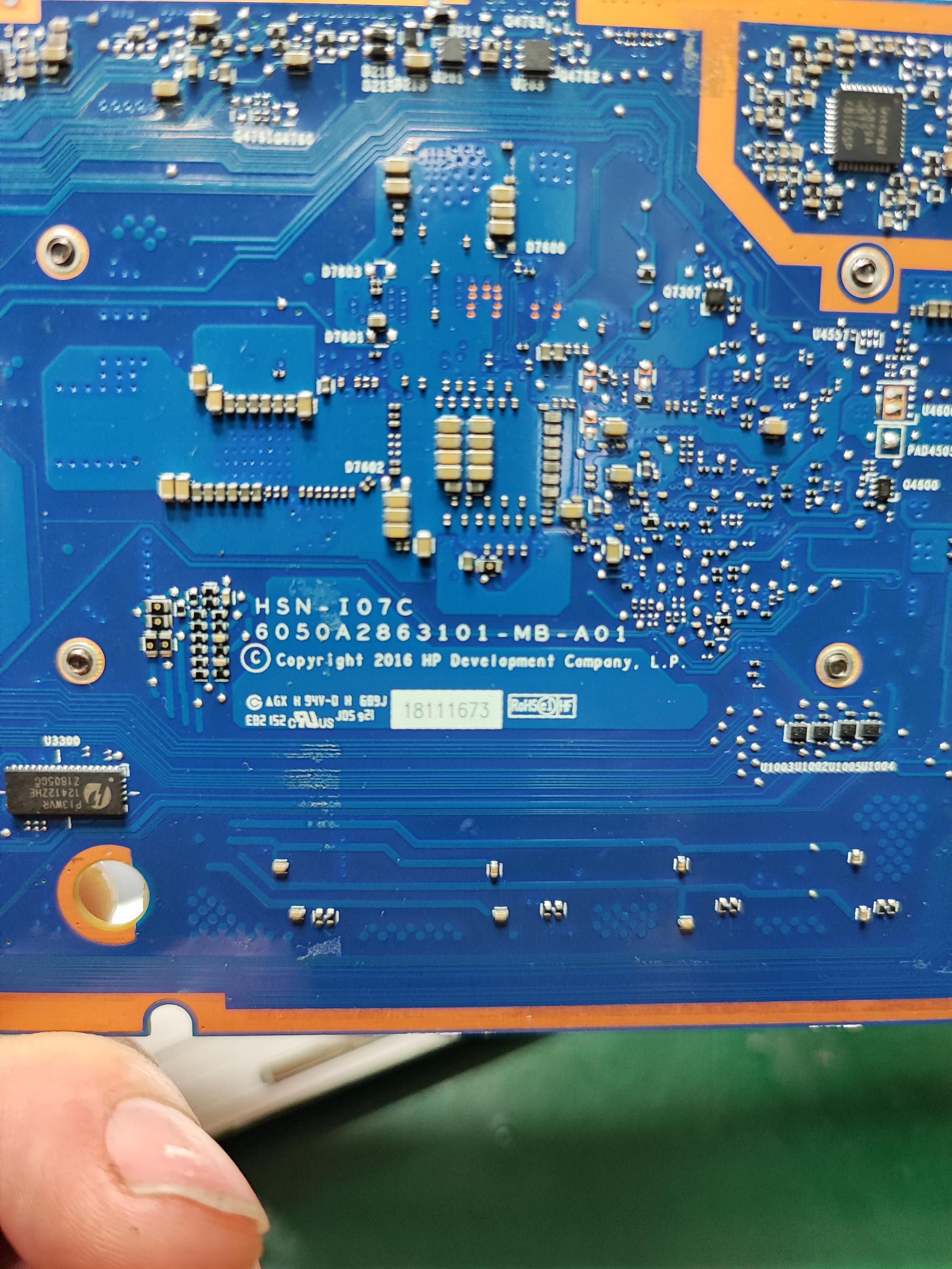

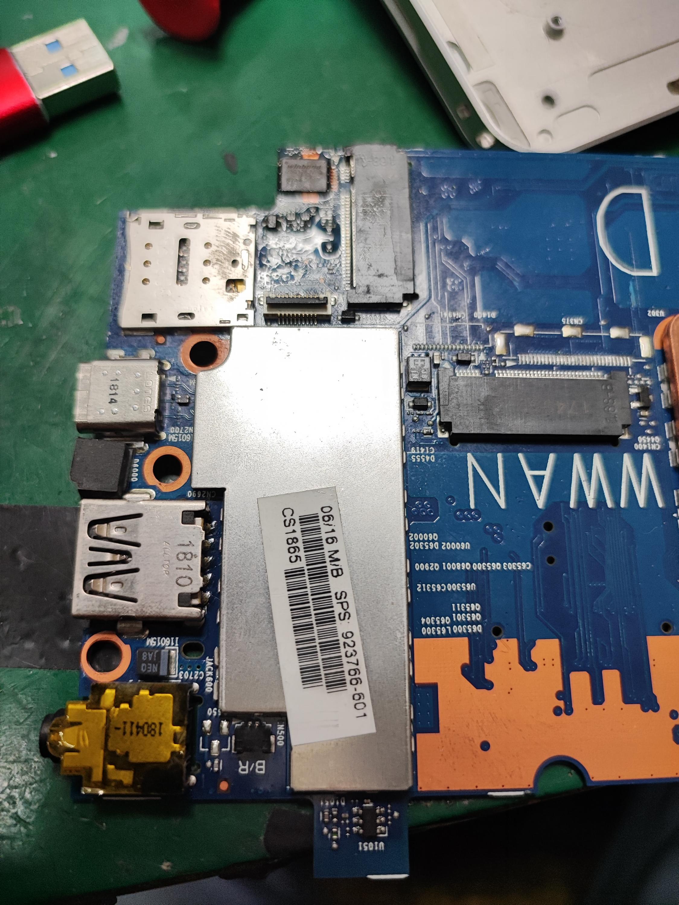

                        i posted already all 3 chip
                        W25Q80DV@WSON8 ori - on the back oon the wvan conector
                        W25Q64JV@WSON8 read ori.BIN - near cpu same side
                        and
                        1012-g2.bin - its writed on W25Q128JV@WSON8 - near ssd and sim conector

                                  I tried this fix, for some reason - stil not functional, fan will do at first 3-4 spin then will TRI to rotate 10 degree let say now. Buth the motherboard it's heating up and for Shure require that fan need to rotate.
                                  I tried this EC, and the bios that i post in first post, and at first start it show
                                  Picture attached.
                                  After the message, it take a little then display the error for data mismatch, ai press OK with the mouse, it reset and screen don't show again, and it's in bootloop.
