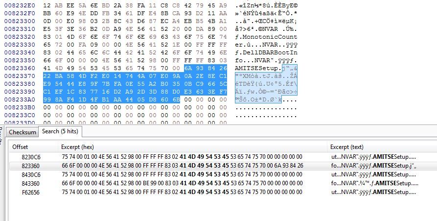

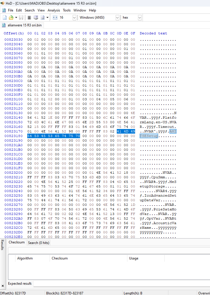

              You can unlock it yourself. Use HxD hex editor - https://mh-nexus.de/en/hxd/ ,search for the word AMITSESetup ,keep searching until you find some code after it and not just 00`s ,copy that into Maxpowers decrypter https://www.badcaps.net/forum/troubl...18#post1544418

                #107
                Click image for larger version  Name:	Capture.jpg Views:	0 Size:	95.7 KB ID:	3682607
                it is worked. Thank You
                              Click image for larger version  Name:	Capture.jpg Views:	181 Size:	95.7 KB ID:	3682607
                              i tried this method but cannot find any code after AMITSESetp....and cannot find maxpowers decrypter...i attached ori file which is password protected..alienware 15 R3 with ST:FKS97H2....

                                #115
                                00 after AMITSESetp
                                          Search for all occurances of that hex , fill with 00`s
