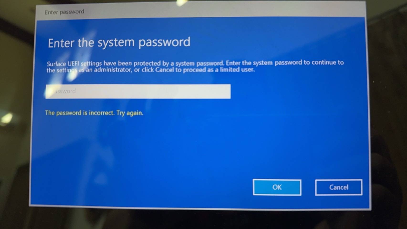

        Hi there. My Surface Pro 8 show MS logo for a few secong and then shut off.
        I managed to flash in SPI bios the .bin posted above and then I have access to UEFI settings but without touch and with uefi pass.
        I have tryed to clean ME with MEAnalyer + FIT + CSME repository, but, finished in error buliding outimage.bin
        Can anybody help me please? I would need Clean ME Region on my original bios
        P.D Atached pictures with the problem
        Tks a lot
        Model Surface Pro 8 1983 128GB
        s/n 0F018WR215101J

            Tks a lot. Works quite fine. The system goes to Uefi mode perfectly, with touch pad functionally but touch screen no. And, curiosly, when I try to install W11, configuring boot for USB, in the first blue screen, leave to response the touch pad, and touch screen is not functional. I have triying to install W11 to explore the solution by windows update...
            Any ideas?

                        Hi and tks a lot. The bin goes properly now, It was an error flashing spi bios.
