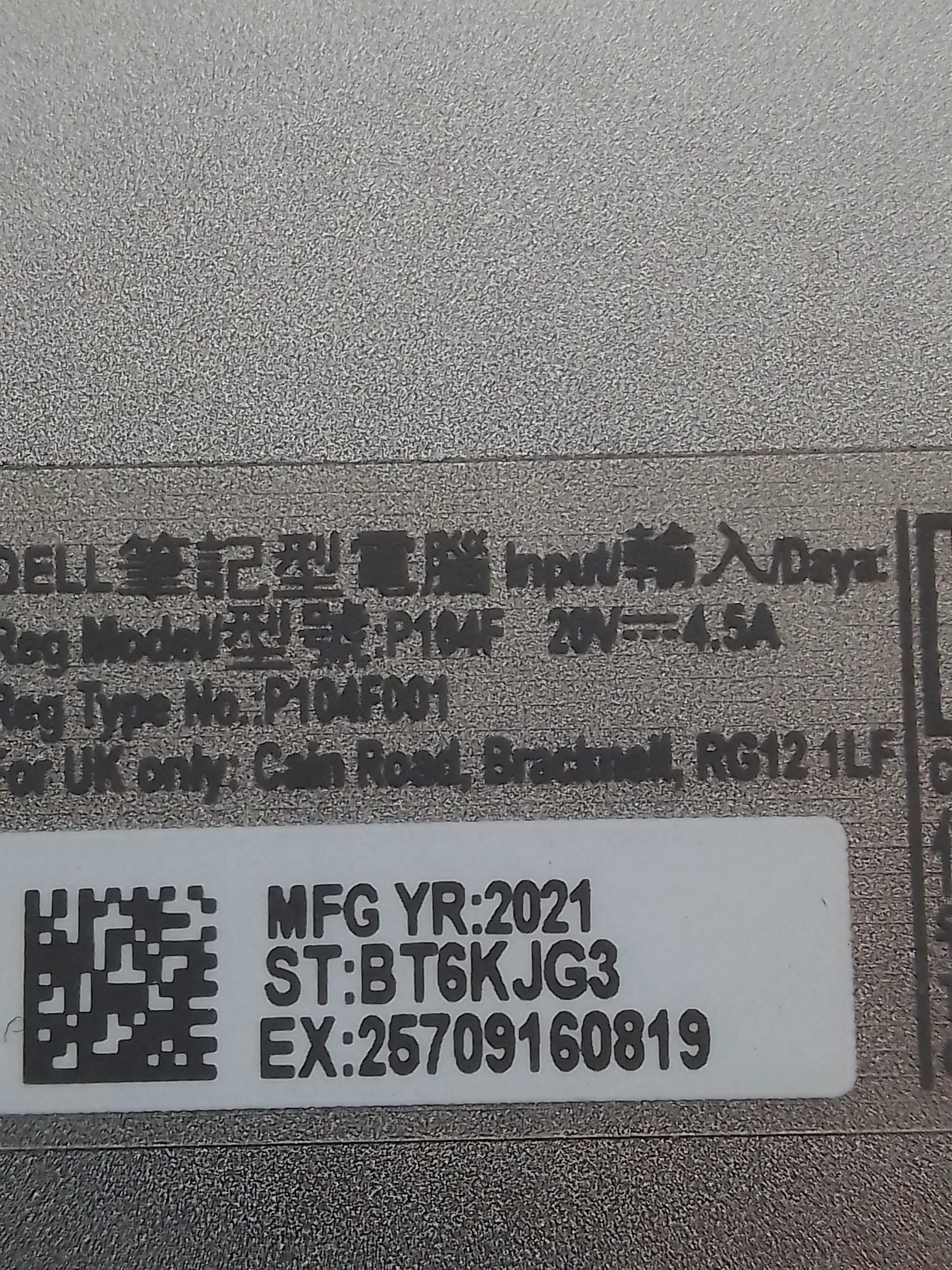

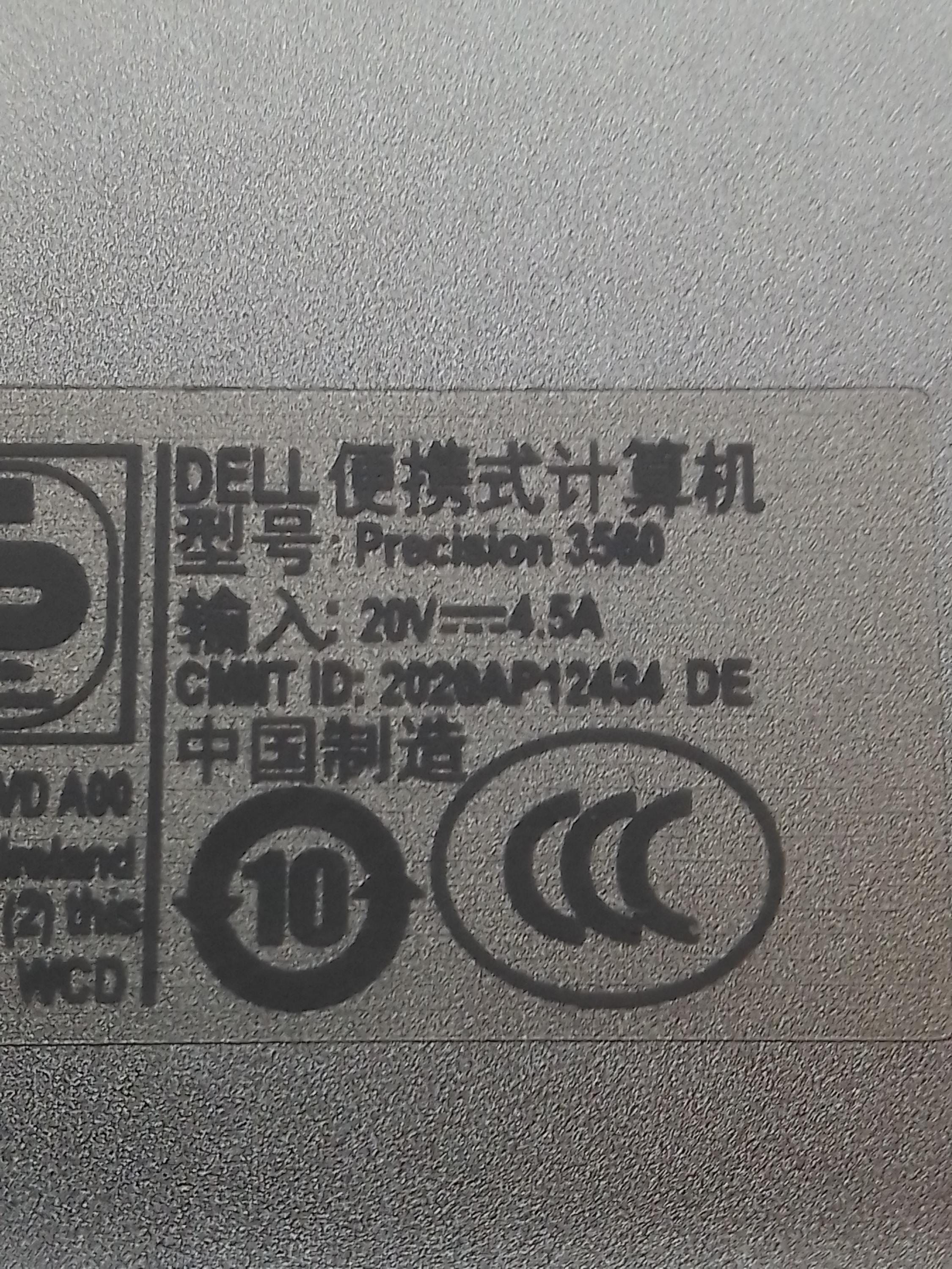

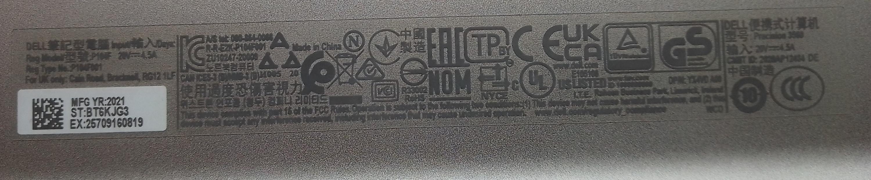

        post the service tag
        • lechugaAmir
          • Aug 2016
          • 19
          • Mexico
          Re: DELL Precision 3560 dump bios
          I leave photos service tag

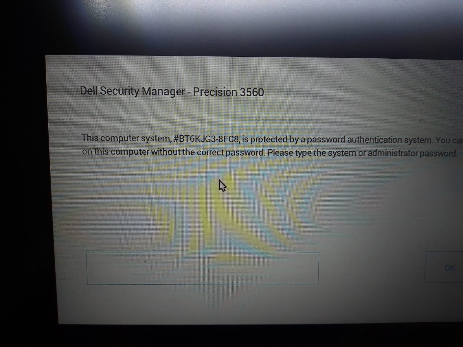

            You mean by "clean" to remove the Bios Password? because I see this Image in your attachment.
              hi .hardware1. We need to remove password I can't enter bios. thank you so much
                Here's your Unlocked file.
                  Thank you so much. now it works
